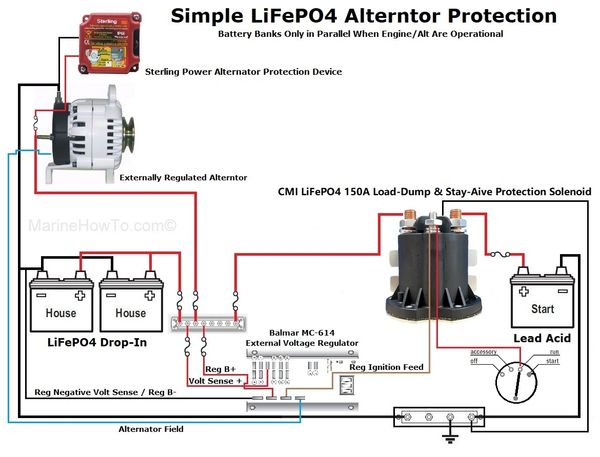

Most combiner / ACR's are the wrong voltage for LFP. For a stock alternator a DC to DC charger, at about half the rating of the stock alternator, is typically easiest. The B2B is sized at roughly half so you don't burn out the alternator..
For an alternator with external regulation a simple option is this:

On my system, I have an external regulated alternator with alt temp control. It is connected to a diode based battery combiner. The sense voltage is pulled from the AGM start battery and the voltage is regulated to what ever voltage I set. I set it to 13.6v to keep the LFP happy which undercharges the AGM by a bit but I can make up for that with a very small plugin charger set to the proper AGM voltages. The AGM and LFP are fully isolated except for getting the same charging voltage.
What am I missing?
Apr 22, 2011
960
Hunter 27 Pecan Grove, Oriental, NC
My original alternator charging setup was a dumb alternator output going to a 20 amp dc to dc charger inline with an agm start battery. The charger would send 20 amps to the lifepo4 batteries when the ignition key was on.
I now have a Balmar 100 amp alternator with external regulator. This allows quick charging of the lifepo4 batteries. Because I already had a dc to dc charger, I simply reversed the input and output cables and changed the charging profile to agm. So now the start battery receives the charge from the alternator/house bank whenever the ignition key is on. If I had not already had a dc to dc charger I would have opted for Main Sail's solenoid depicted above.
CarlN
Jan 4, 2009
603
Ketch 55 Bristol, RI
MainSail - with the CMI Solenoid Load Dump you mention above - are you assuming that the charging profile for the drop-in lithium bank are "good enough" for the start battery? Or is there a 2nd charging system for the start battery that's not shown?
