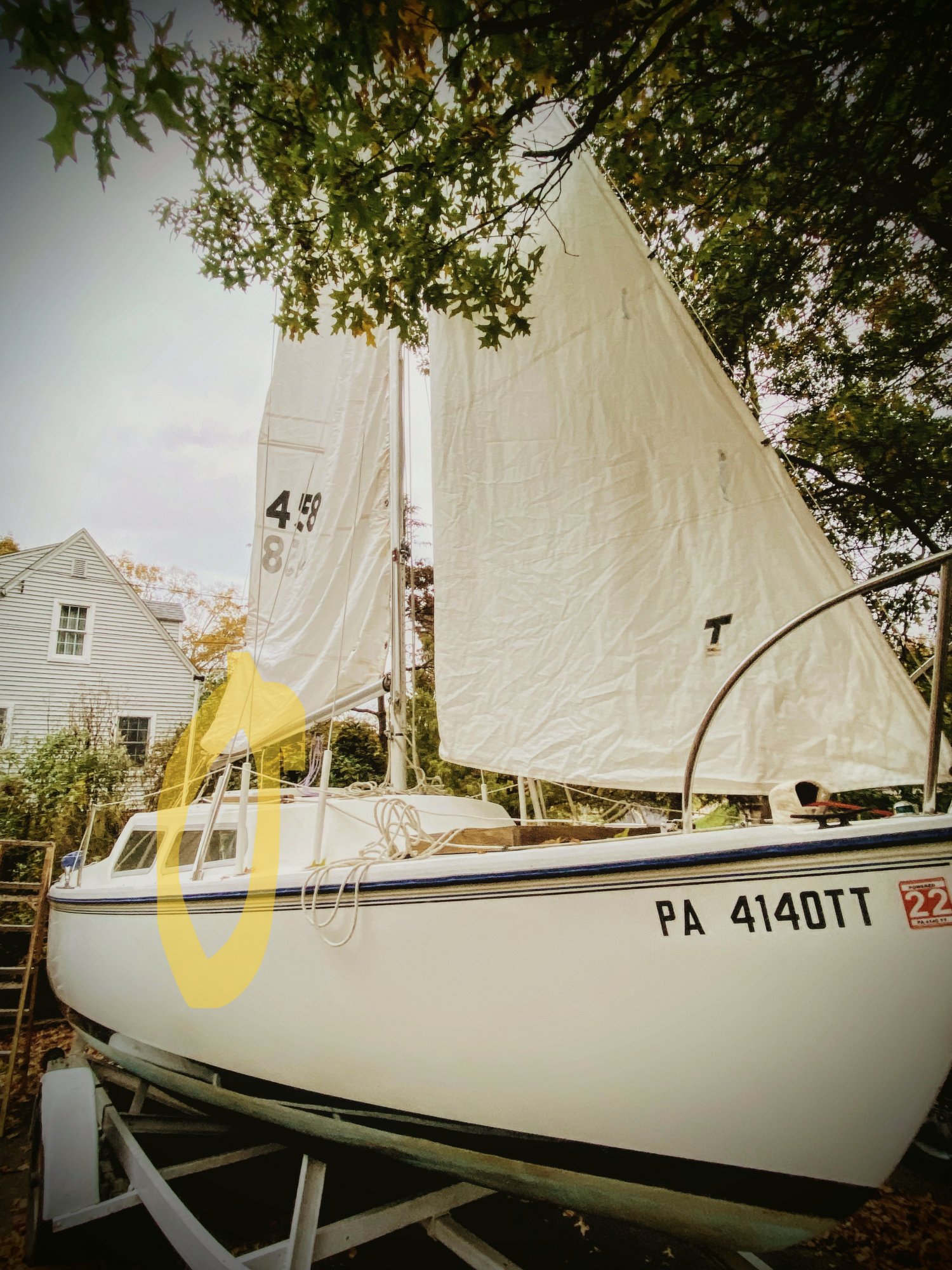

On my C22 the (middle) lifeline stanchions are angled inward toward the center of the boat. This makes the lifeline cord so cramped that I can barely get my legs/feet inside them to walk up front. I keep thinking that it would be really nice and open things up if I just turned these middle stanchions 180 degreees so they angled outward. It would give me so much more room to move when I walk up front and just make the boat look/feel more roomy. As they are angles in now, It does keep my body inward, which is maybe the idea but it also sort of throws me off and makes me fall inward, and seems borderline more dangerous as its so tight/cramped like this.
Anyone tried to rotate them out like this? Any reason no to do this...besides the fact that I would maybe need to drill new holes (depending).
Can I take it off and just BEND it the opposite way or at least bend it to make it straighter?
Thanks friends!
Sep 30, 2025
196
Catalina 22 Davis Hollow - Lake Arthur
Forgot to mention my boat is a 1971 C22. Actually not even sure they came with them back then.. or if the previous owner put these in?
This pic shows how angled it is. Hard to see cause it's angled same as the rear stay just behind it. Lemme know guys what you think and if anyone has tried them the opposite way to open these babies up a bit. They're crampin me! And yes the lifeline cables are very loose... I have tightened them since and they are just as cramped tight or loose.

The mounting feet are likely a trapezoid, so not easy to turn around. Could they be bent due to lifeline tension? Any distortion at the base? You can purchase stanchions with different angles, which is meant to deal with different cambers of decks.

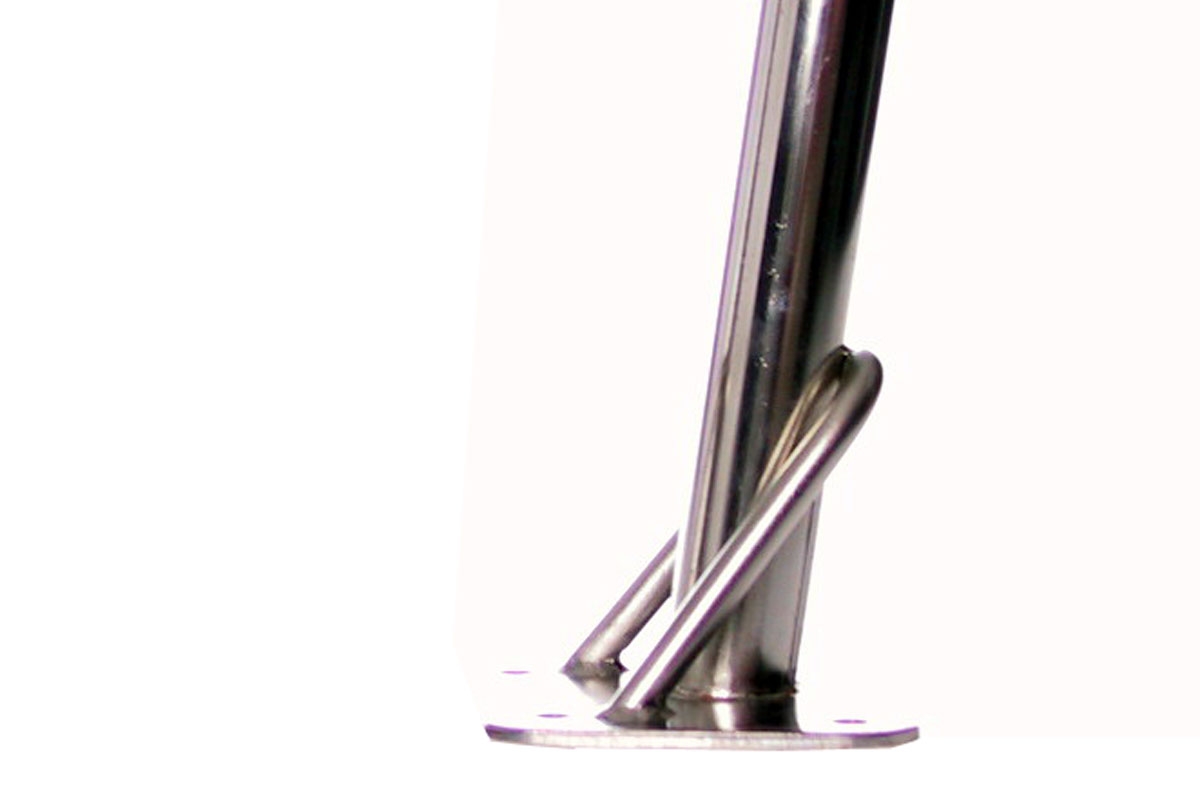

Here is the image of a Catalina Direct C-276 degrees out stanchion. Note the base orientation.

Photos of the stanchion bases would be helpful.
It is unusual for the stanchions to be angled towards the middle of the boat.

I believe after some research that these early C22 stanchions were bent in at this hard angle.. seems weird to me but I saw a few photos of other boats like this with the old ones.
Can I just take it off and bend it outward, because as someone mentioned the base is trapezoidal so I cant just flip it around.

If you bend it, you will weaken it. Not what you want with a life line.
It may be possible to take it off and turn it around, a closer photo would help. Since the holes won't line up, it will be necessary to fill the old holes with thickened epoxy and drill new holes. Not an impossible job.

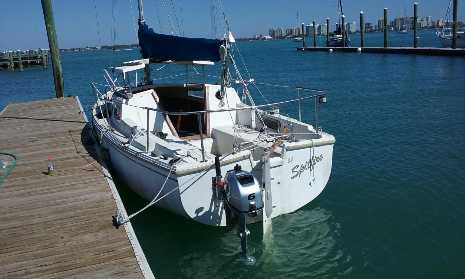

Stanchions were not installed on every boat.
Some stanchions bend in - some bend outwards.
Some have extended stern pulpits with no stanchions
Here, Little Spitfire has an extended Stern Pulpit with outwards-bending stanchions.
Your boat is yours, and you can modify it to suit your desires.

Both sides are exactly the same angle, very hard angled in and no stress fractures or anything unusual....so I think they were made like that and maybe even for another boat with a rounder deck or something..? I saw a few photos of someone else's old c22 with the same angles in cramped ones..that changed his because he didn't like the hard angle in either.
Think I'll have a quick look at it reversed..and if its too much angle outward...guess Ill fork out $200 for 2 new verticle stanchions from Catalina Direct..
