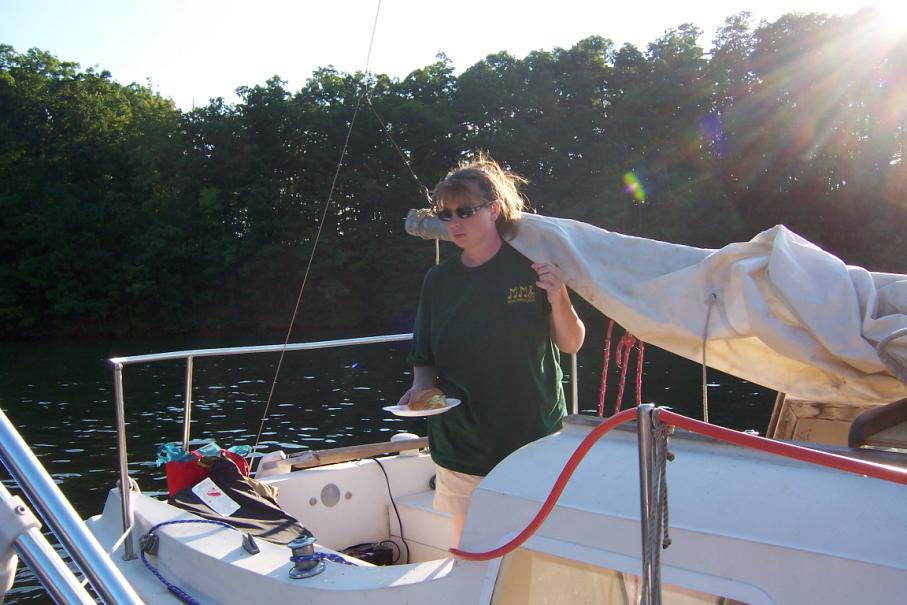

I have not spliced dynema. I have spliced nylon and did it using a phillips headed screw driver. But I was making dock lines and not life lines. On a Coronado 23 that I fixed up, I did go to lowes and buy some tygon tubing to recover my existing life lines. The original plastic had cracked. So I pulled it all off and the underlying ss wire was still in good shape. So I covered it. I went with bright orange so it was easier to see.
