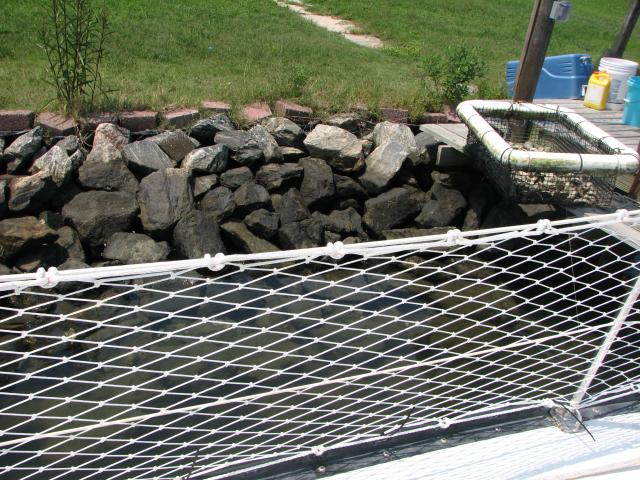

***Update***
We have installed the lifeline netting and we are very happy with it. I don't have any complaints about it yet. Here are a few pictures. Ignore the zip ties at the bottom, they were only used to hold the netting in place while using rope to secure the netting and will be removed shortly.

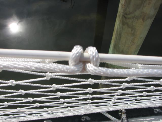

I cut the lifelines and ran them to the top of the bow, how it is on Jon's boat(in his post about half way down page 3).

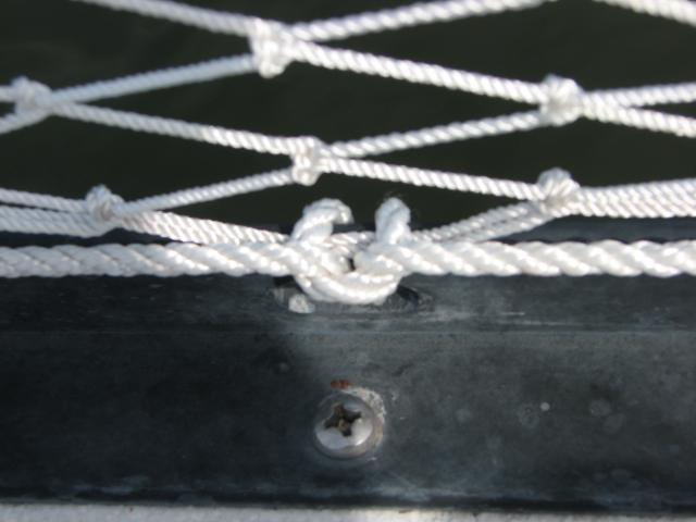

I was going to spiral some small diameter rope around the top life line and the net. Jon I see you have knots tied. Do you have a close up of the knot you used?
Dec 9, 2008
426
1980 Hunter 30 "Denali" Seaford, VA
Hi Scott,
Attached are a couple of pictures, I think this knot looks pretty good and it's symmetric. We just kinda found the spacing we liked to keep it held up without drooping and providing plenty of support. I bought the rope in 50 ft sections, mainly because that's what was available without having to go too far and there was a little left over in the end, but not tons. We are happy with they way it turned out. The wife is right, it's a cow hitch I guess... I had to google it as I didn't know the name :redface:.
