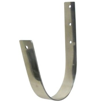

$8.80 on Amazon.
That must be one hell of an anchor!
Something about that thing just looks - dangerous.
The designs I'm more interested in are stainless 10 times that with shipping.
Maybe I could use it for my garden hose :dance:
