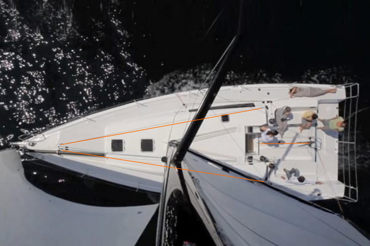

This is the layout I copied and like.
I only use the short leg of the tether 99% of the time and can reach everything for normal sailing, and it keeps in in the cockpit or on deck. It's snug if I stand straight up but perfectly comfortable, and I'm rarely standing anyways at sea.
1) If I need to go all the way to the bow I have to switch to the 6' leg as my deck lines stop just before the bow hatch. When I'm at the bow I clip the short leg to the pulpit, so I'm secured by 2 points. I have a jib downhaul so on most trips I don't even need to go past the mast.
2) To raise/lower the outboard I have to put my feet in the motor well, and to reach that far I need the 6' leg.
I made mine with dyneema. Low stretch and the clips slide nicely. Very affordable too.

Dyneema is not a particularly good choice for jacklines for a couple of reasons. It is round and will roll under foot and it doesn't stretch. The first issue can contribute to slipping, thus increasing the risk of falling. It is better to have jacklines stretch a bit to absorb the impact of the fall, otherwise all of the impact is absorbed by the rib cage which is not good.
Flat webbing is generally regarded as the best material for jacklines because it doesn't roll under foot and it has some stretch.
Rather than clipping and unclipping the tether from the boat, have multiple tethers always connected and then connect the tether to the harness. Much easier.

Fully agree with the first two points.
Not so much with the last... the concept might be OK for one person moving about, but with several it probably becomes a PITA. And, the KONG deck-side clips are so easy, safe and secure to operate; much better than a fiddly snap shackle.

Mostly we sail with a crew of two, so traffic in the cockpit is not much of a problem. There are 2 padeyes at the front of the cockpit with tethers, 2 padeyes aft for the helm with one tether and one 2 legged tether attached to the jackline. One tether can be reached before needing to to detach from the first and there is a tether that can be attached before leaving the companionway.
If we had a larger crew, this would probably not work as well, expect for the double legged tether on the jackline.

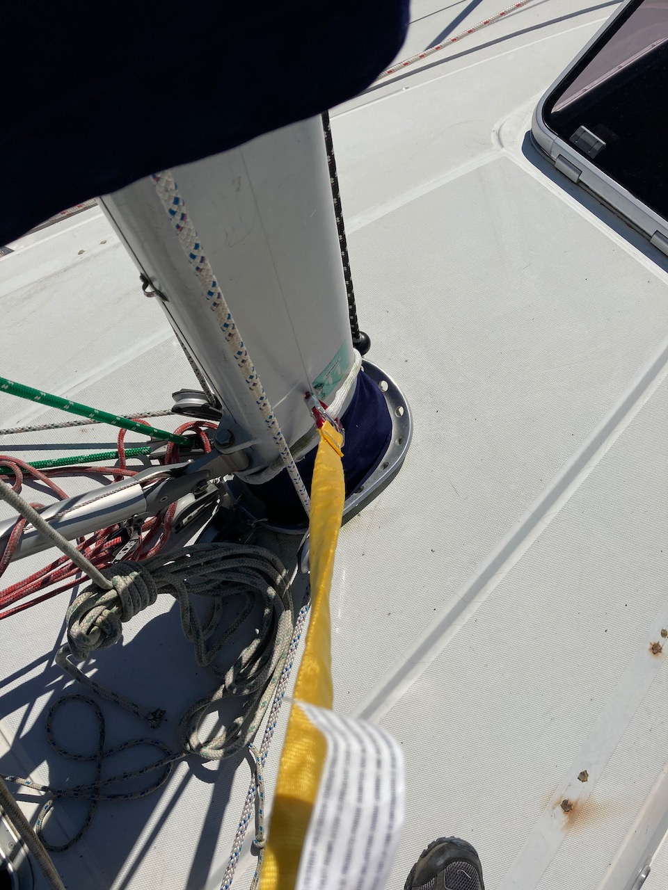

I am humbled by the international fame my simple solution has generated. Licenses to use the name "Lochner Loop" will be made available for a small fee, the proceeds will of course go to a good cause, a retirement fund for an senior citizen sailor who shall remain nameless. ;)
Attached is an image of the Lochner Loop in action. Note to self, make sure the loop is above the boom vang before attaching the vang. :confused:
