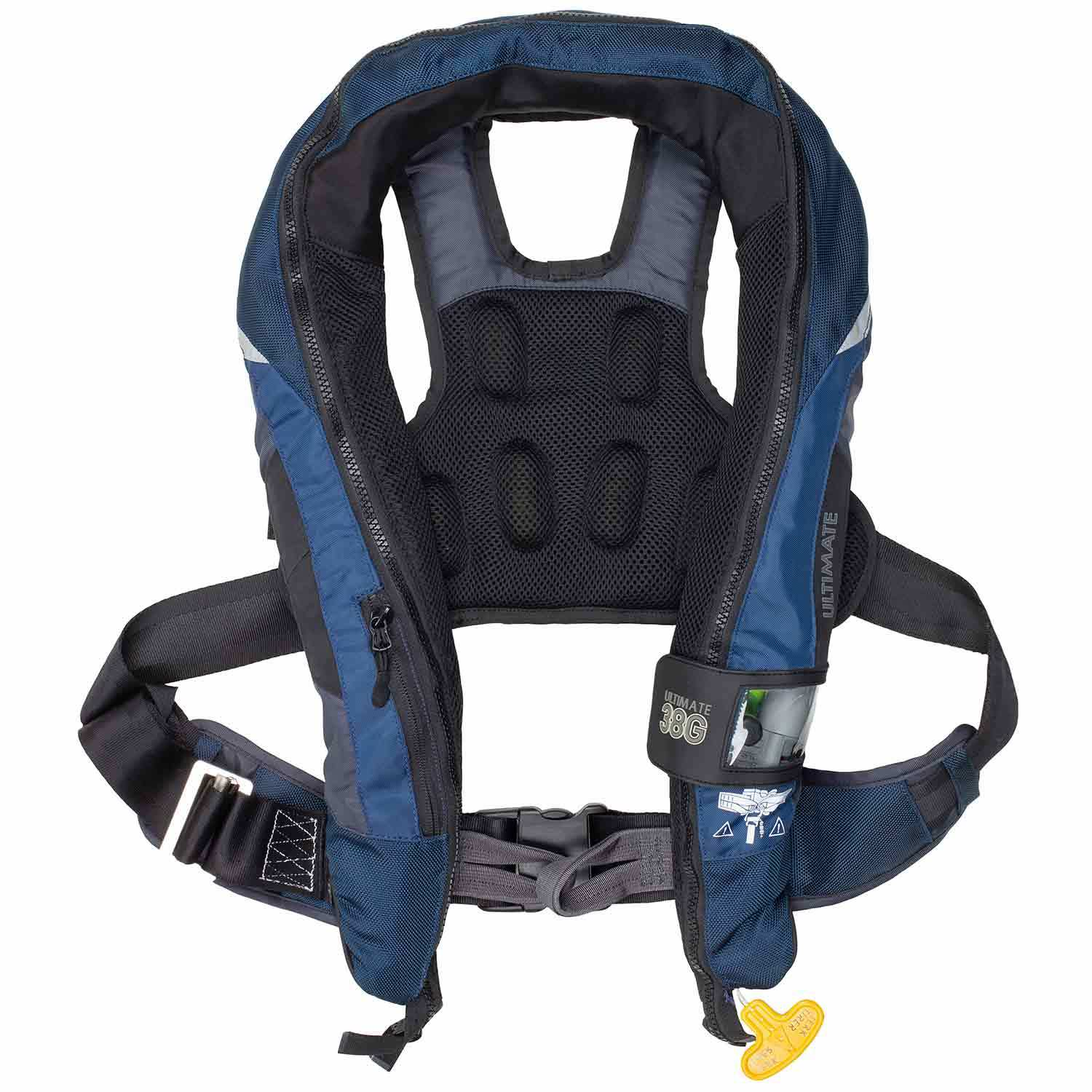

SBO has this one.... kind of spendy

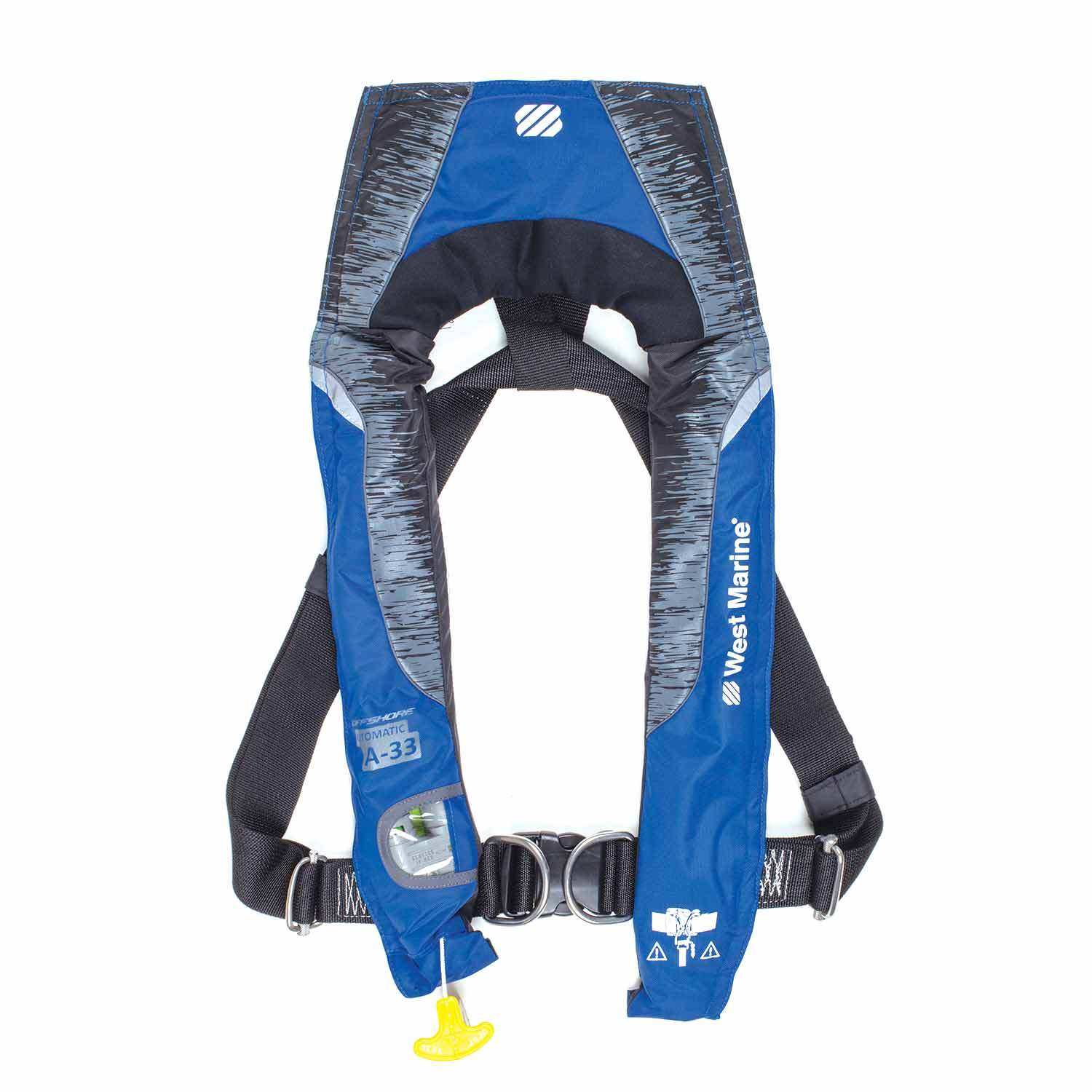

I've spotted these two... at West Marine ... less spendy.

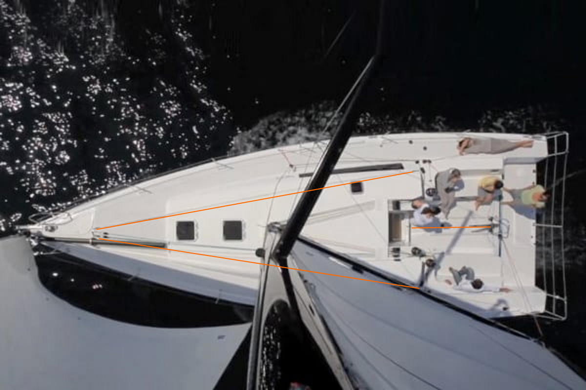

In the cockpit, use a D-RING on the floor, or better yet a very tight jackline running down the middle. deck jacklines ideally run from the leading edge of the cockpit to the center of the foredeck, stopping well before the bow. You should be able to get the the bow with am extended tether.

Pretty much a state-of-the-art jackline system, on the Pogo 12.5. I overdrew them on orange for visibility. Three of them, one running the center of the cockpit floor from companionway to tiller. Two P/S running from the cabintop (not sidedeck) to the middle of the foredeck. Each terminated in a backplated Wichard folding D-ring. This allows you to clip in BEFORE you leave the cabin, and get to every corner of the boat while always attached, and do so with a extended tether.
