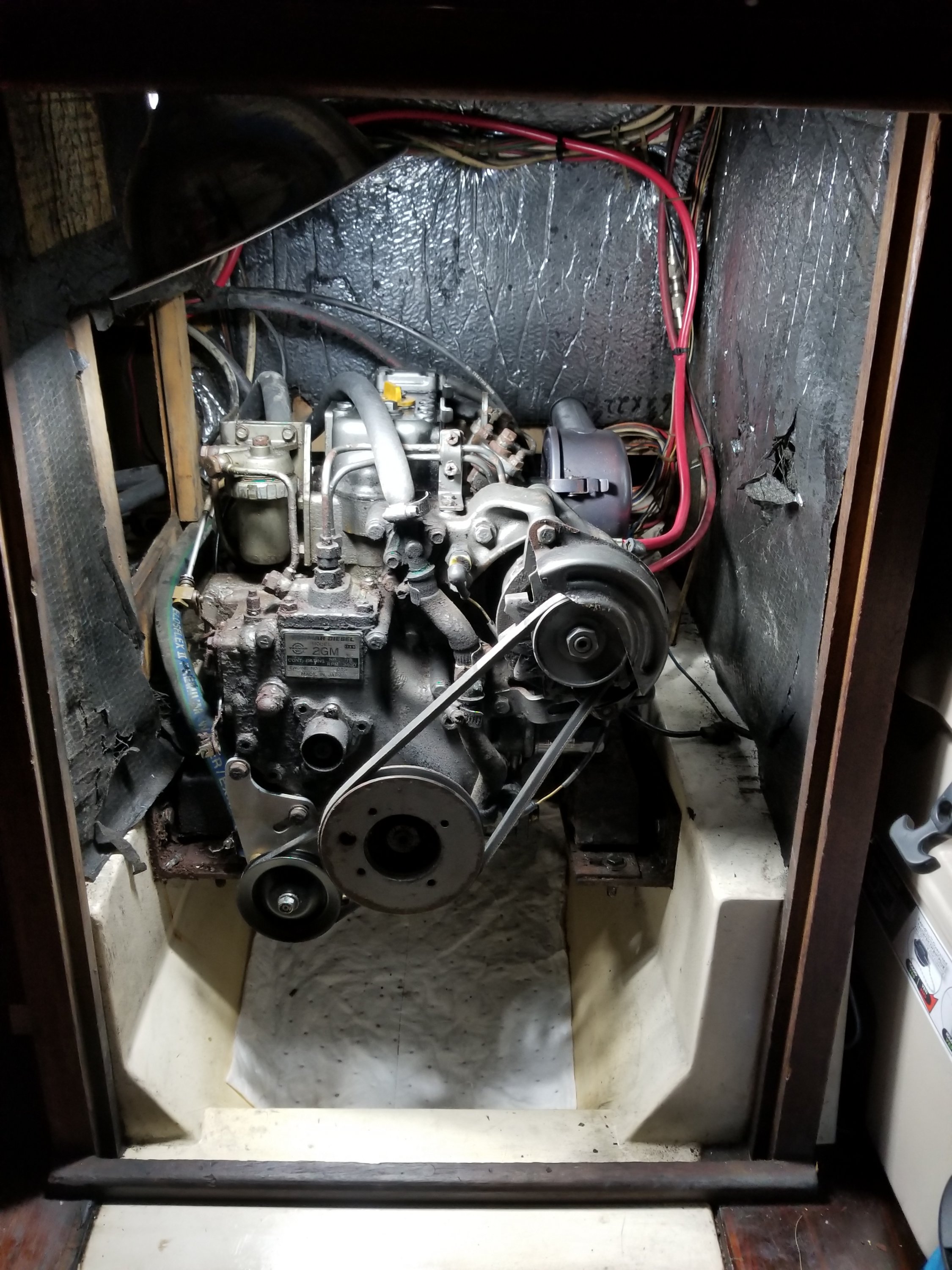

I am the original owner of 1983 h34 with a yanmar 3gmf freshwater cooled engine. I have done all regular routine maintenance suggested by the owners manual oil, trans, belts, impeller and so on. Replaced normal ware and tear items of the years. Winterized engine every year with no issues, engine startup every time on the first time. Knock wood! I have no engine hours meter so I can only approximate the hours to be 3500 - 4000 hrs.
Question is when do my fellow boaters replace or do a complete overhaul.
I ask this because I have a bobcat excavator with roughly the same size engine and I consider this engine to be used extremely hard compared to the boat.
The bobcat service center doesn’t recommend any major service or overall until 15,000-20,000 hrs as long as routine maintenance is done.
Should I be saving up for big bucks, am I way overdue, or put it out of my mind for now. I have gotten mixed views on this.
Some people say it’s a time bomb, others say that it’s just broken in.
Now I don’t want to sound like I am tooting my horn but when is say the engine looks and runs just like new it does. I am a firm believer in preventive maintenance.

That is one clean looking engine and compartment! If that’s any indication of how you treat it, you’ve got nothing to worry about.

CR, why is there a piece of tape over your air intake? Just curious.

Roland
The tape on the intake is for winter layup
After the engine is winterized I soak two rags with w-d40 and stuff the rags into to air intake and exhaust port and tape them to prevent moisture from entering the piston and rusting.
Mac Boring seminar I attended in the late 80s recommend to do this as part of winter lay up. The W-d40. In theory prevents humidity moisture in the air from getting into the cylinder wall.
I have been doing it for 30 years don't know if it really does anything or not but figured that it can't hurt.

I have the same boat, same year and have wondered the same thing. Your engine looks much nicer than mine which has 3200 hours according to the meter that a PO installed. They seem to be a pretty bulletproof engine, I've heard 5-7K is reasonable to expect. You seem to have a great maintenance routine so I would think you could go another 30 years with no problems.
