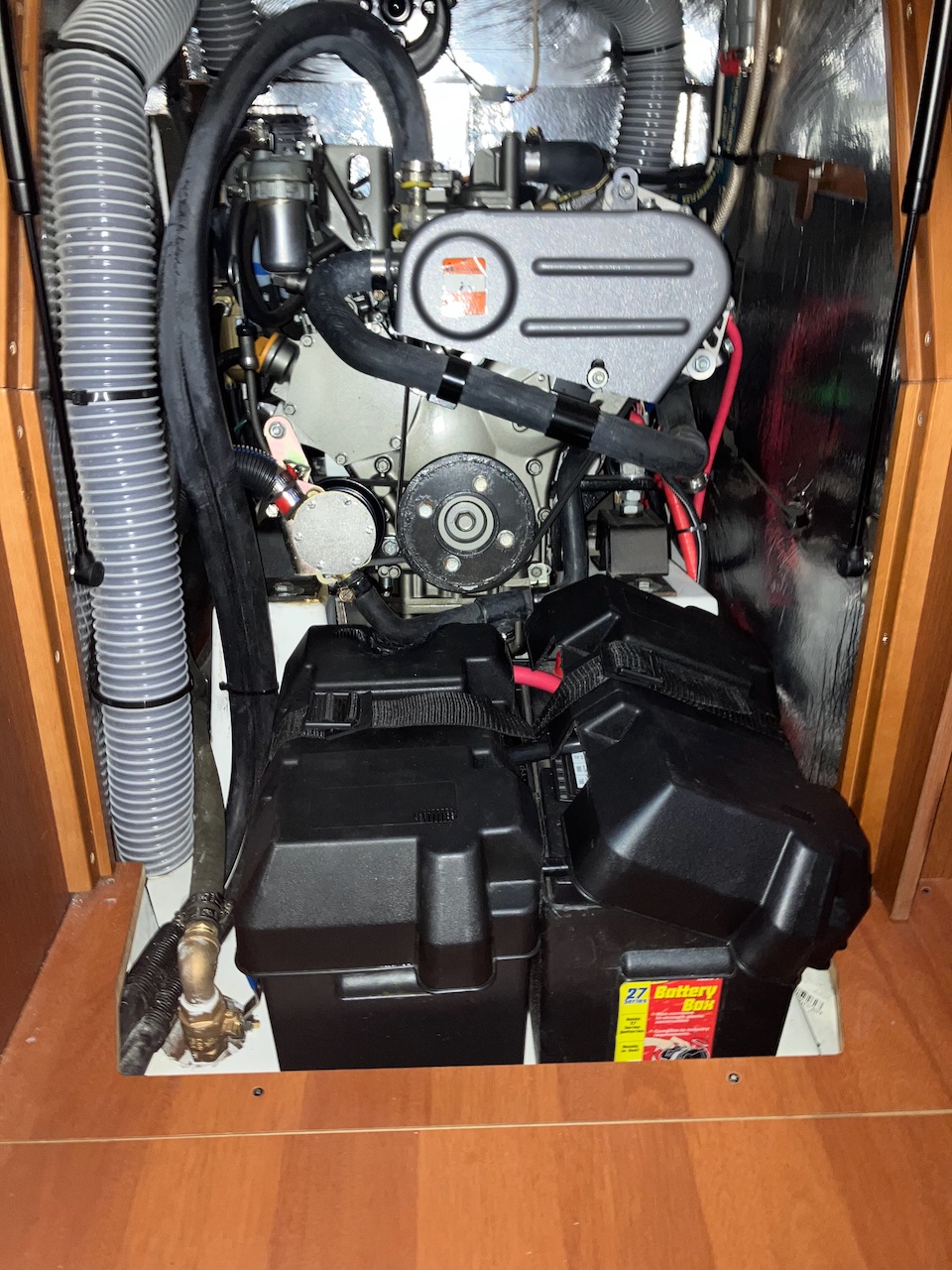

The before house bank was 2 FLA G31 located in engine compartment, and the start battery was a single FLA G24 located in the aft berth next to engine compartment;

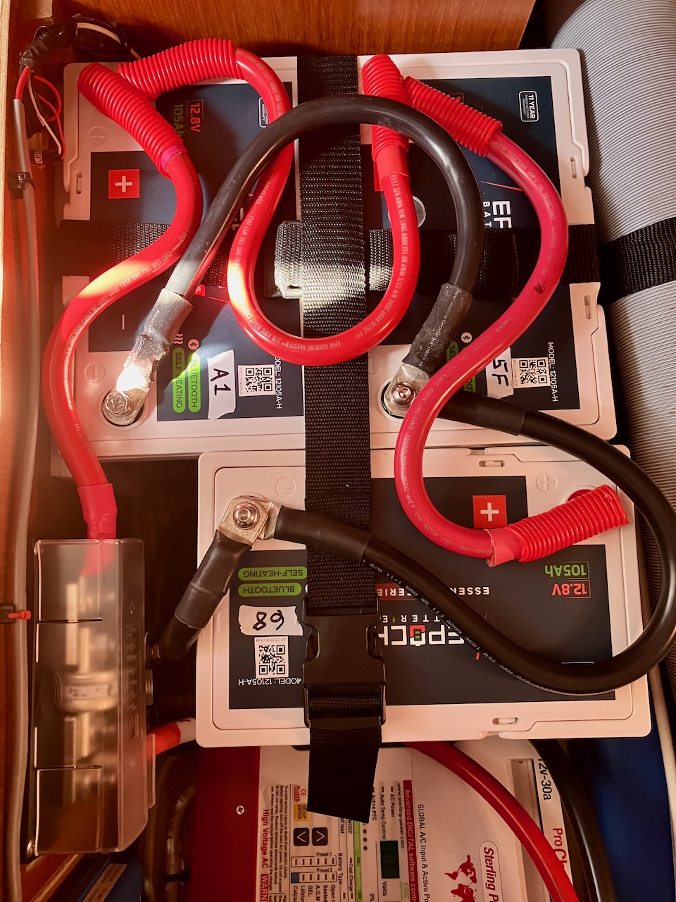

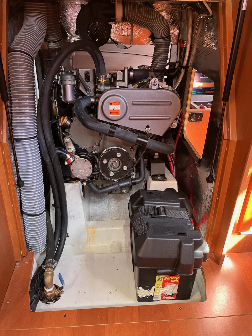

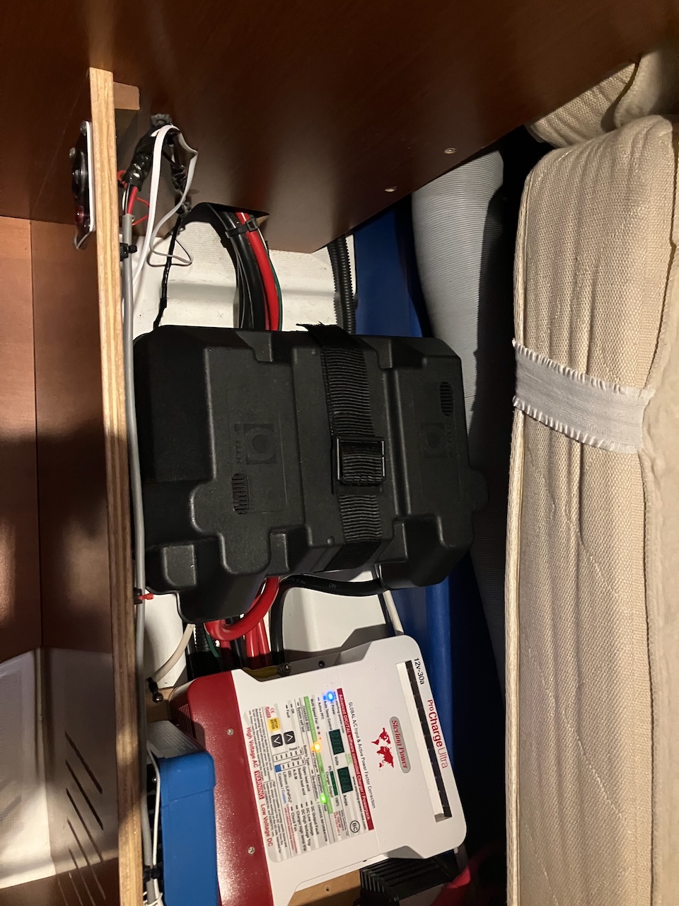

The after now has the FLA G24 start battery alone in front of the engine, and house battery bank comprised of 3 Epoch 105 AH LfFePO4 battery packs located inside the base of the aft berth.
Here’s what I upgraded
I’m really glad that I managed to limit the scope of this project! With a starting budget (from the previous post) of $1220 - $1600, I wanted to install an additional 200 AH of capacity to the house battery bank, plus a DC - DC charger to install between my start battery and the new LFP bank, and a smart shunt to add some monitoring capabilities.
Preliminarily, I have spent have now spent a little over $2,000. Approximately $1500 on the batteries, SmartShunt and Orion charger, plus more than $500 on new battery cables and fuses! I did not have a proper understanding of what cables I would need to relocate the start battery, or the total cost of all of the new fuses (and spares!) that I needed. While I’m not pleased at missing the boat (Ha!) on the additional details, I am pleased that I didn’t just let myself continue to purchase big items like an inverter/charger just because I found a sale on batteries.

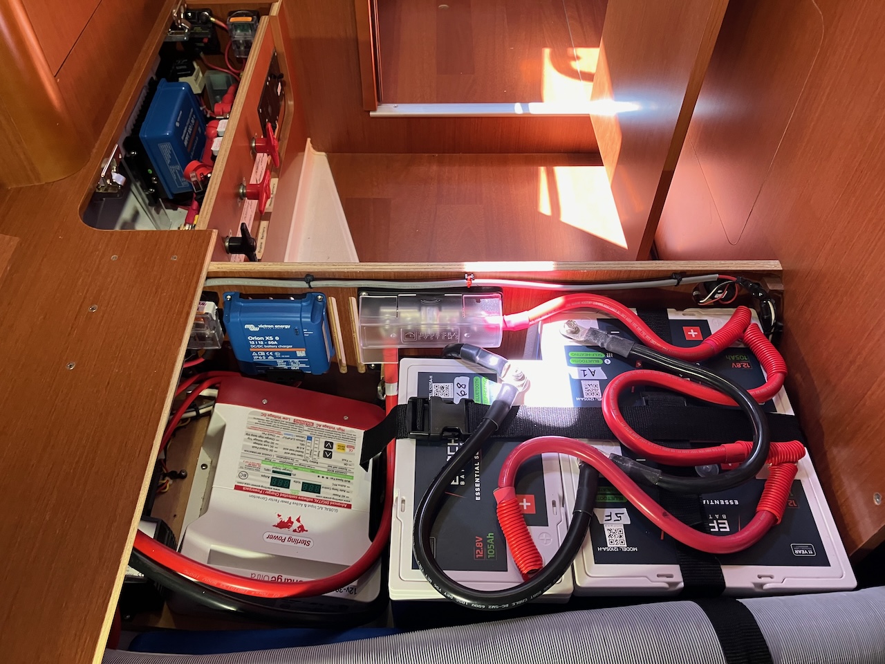

In its current configuration, I have the house battery bank being charged by my shore power charger, my Victron MPPT solar charge controller, and the Victron Orion XS DC-DC charger. The (still FLA) start battery is being charged only by the engine alternator. I will likely replace the start battery with an AGM when I find a decent sale on one.
It was a tight fit! I measured, and was confident that the three new LFP batteries would fit into their new space. But, what I didn’t understand was how much space would be required for some of the other pieces. I seriously underestimated the size of the new class T fuse block. And, the photos of other installations that I have seen must have been in a completely open space, with nothing else in the picture to provide relative scale. It took a lot of time and physical contortions to complete the relocation of my start battery and solar controller, and to install the new fuse blocks and wiring. But ultimately, everything fit where I wanted it to be, and I can’t wait to see how the upgrades perform away from the marina!

Nice clean installation. Watch the temps on that Sterling charger. It looks a little suffocated. Sterling has a remote monitor for that charger that can show you the charger temperature while running. I have an Epoch 300Ah battery and am extremely happy with it. Good choice.
