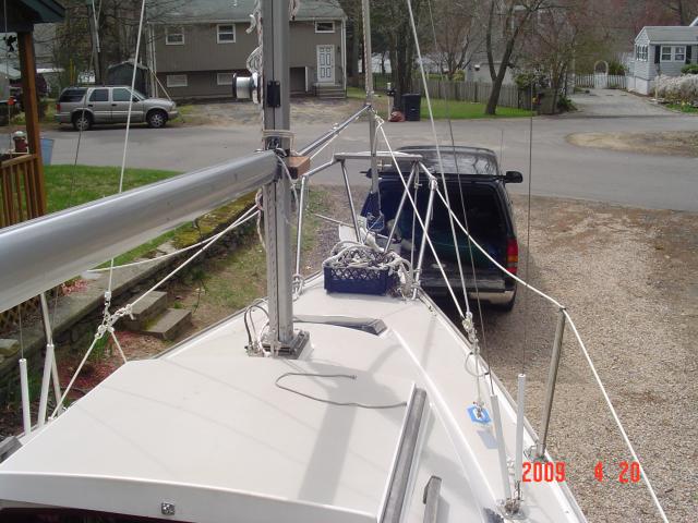

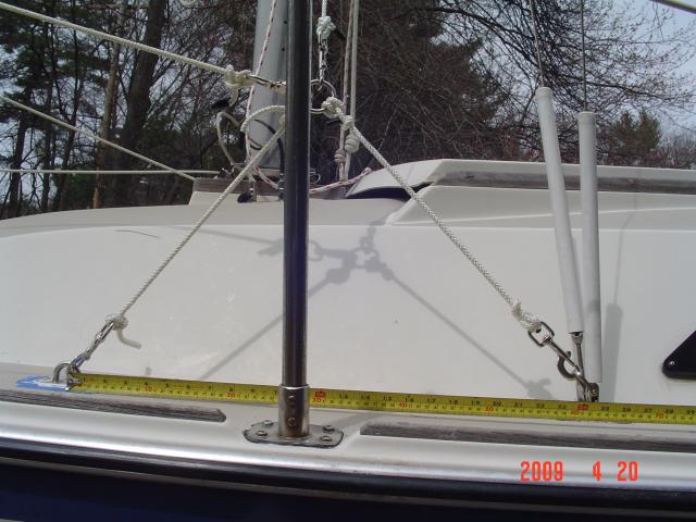

Our docks and moorings go in on May 2. After that, I'll be bringing her down to her mooring. I just took these two pics of her.
