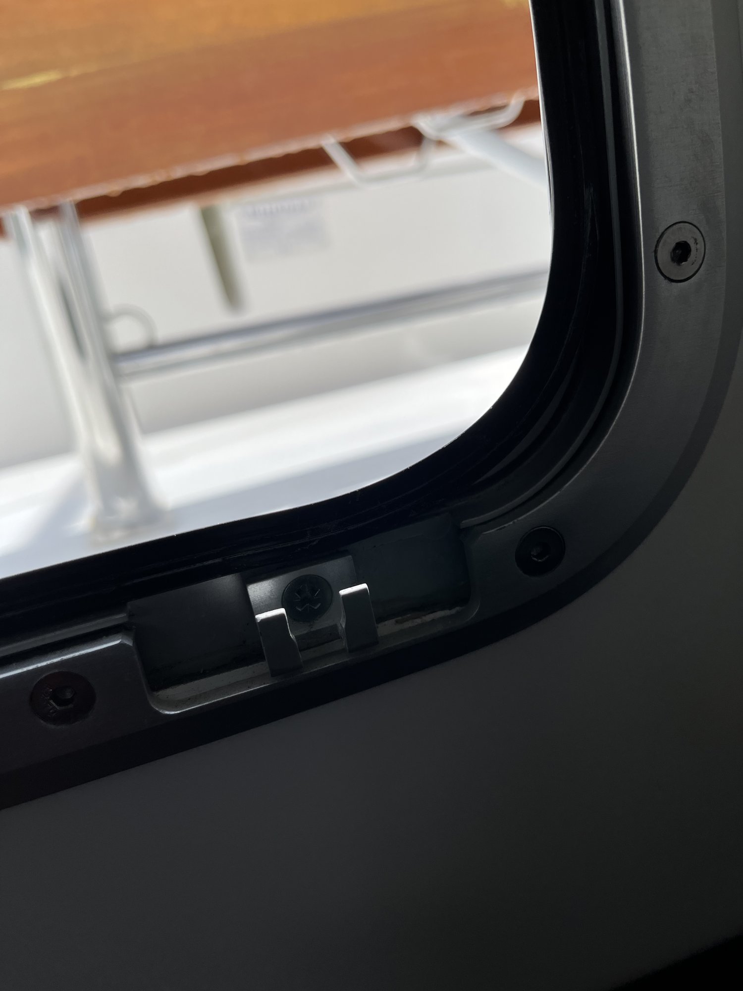

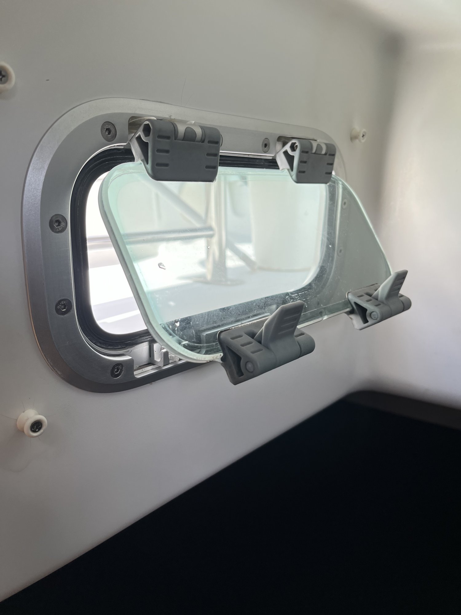

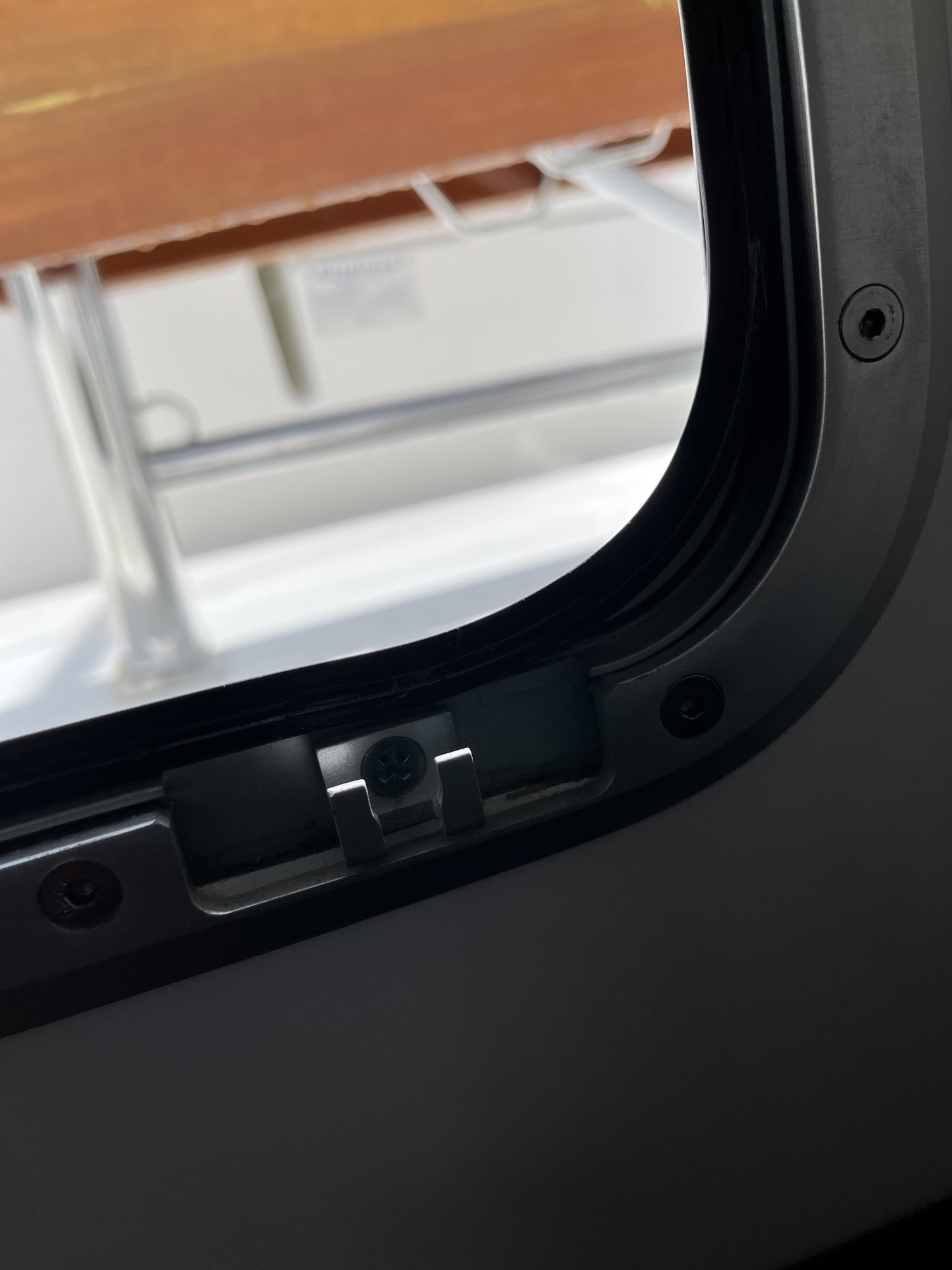

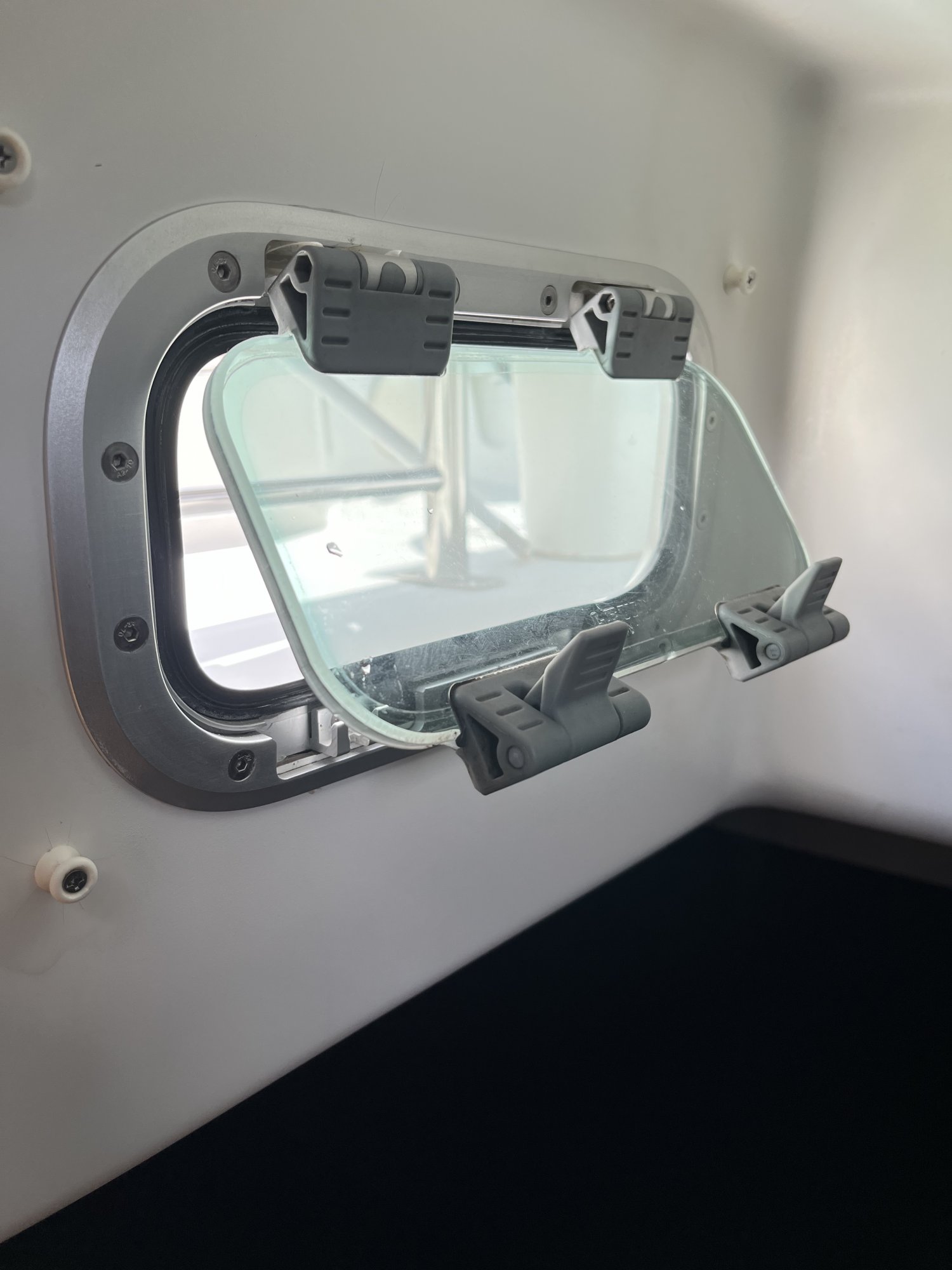

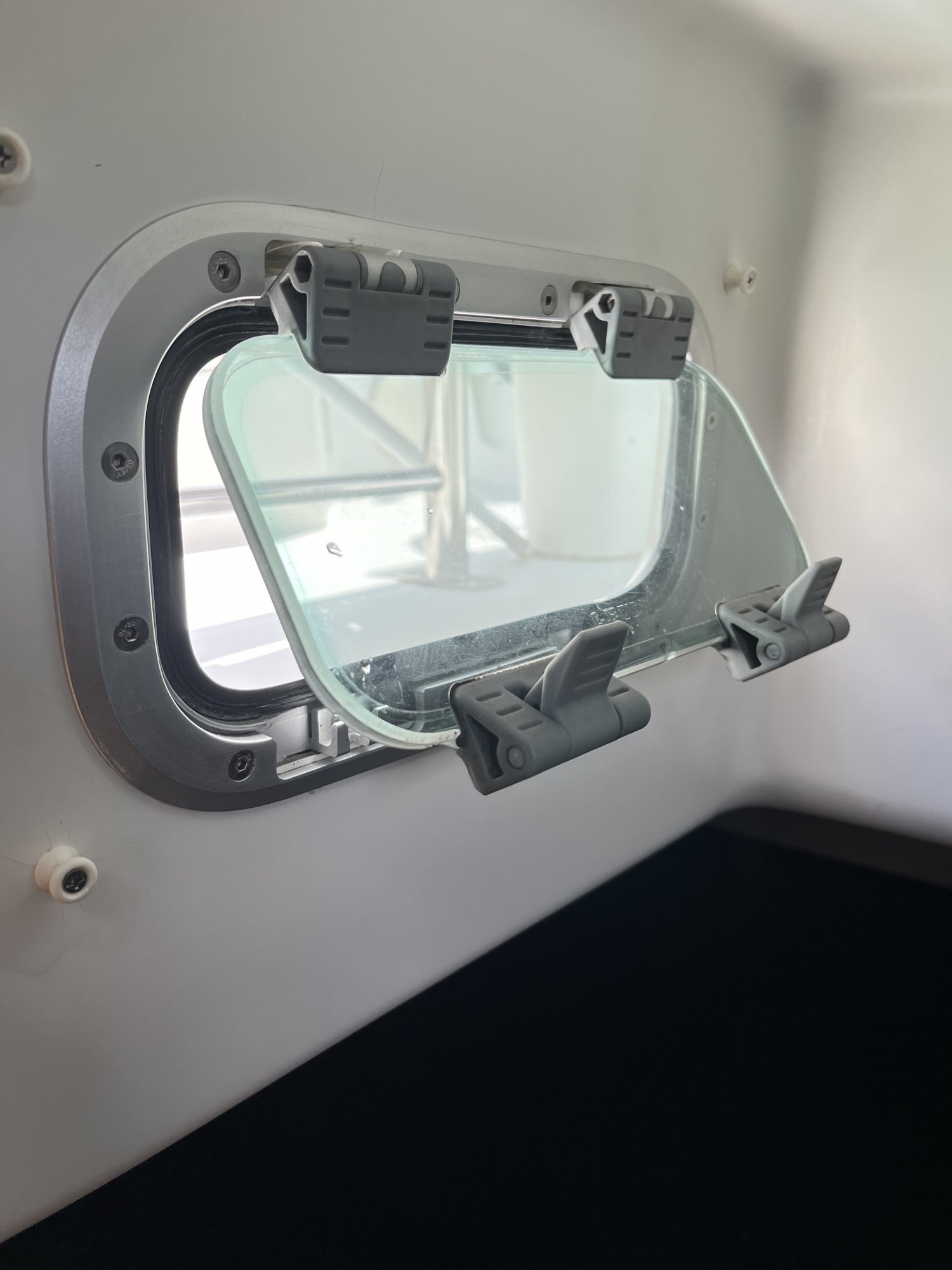

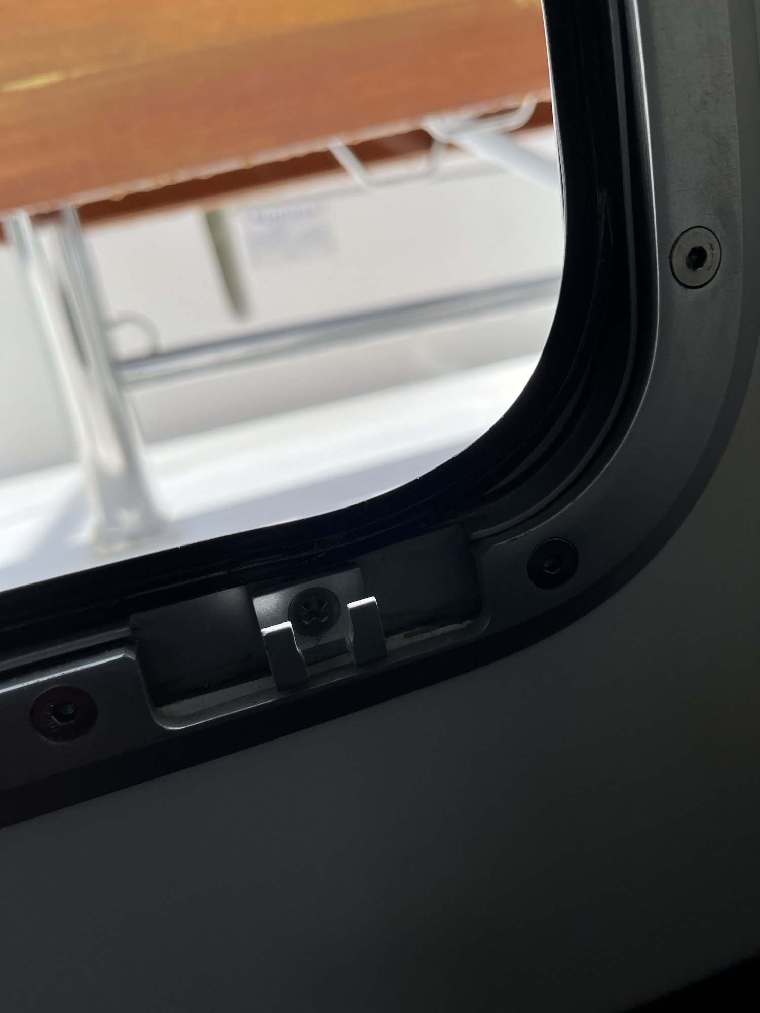

Hello all,
Have a window with a gasket that is coming undone in one corner. Picture does not do it justice but hoping someone has experience with these windows. The gasket piece has to be inserted into a channel…… can’t figure it out. A special tool?
thanks
Greg

Thats a good idea with the hair dryer, Thanks! Its such a strange design.... the slot where the gasket is suppose to slip in is in a strange place.... mid gasket. I'll try and get a better picture but in the second picture you can see the slot. The gasket has a small lip mid gasket that goes inside.
