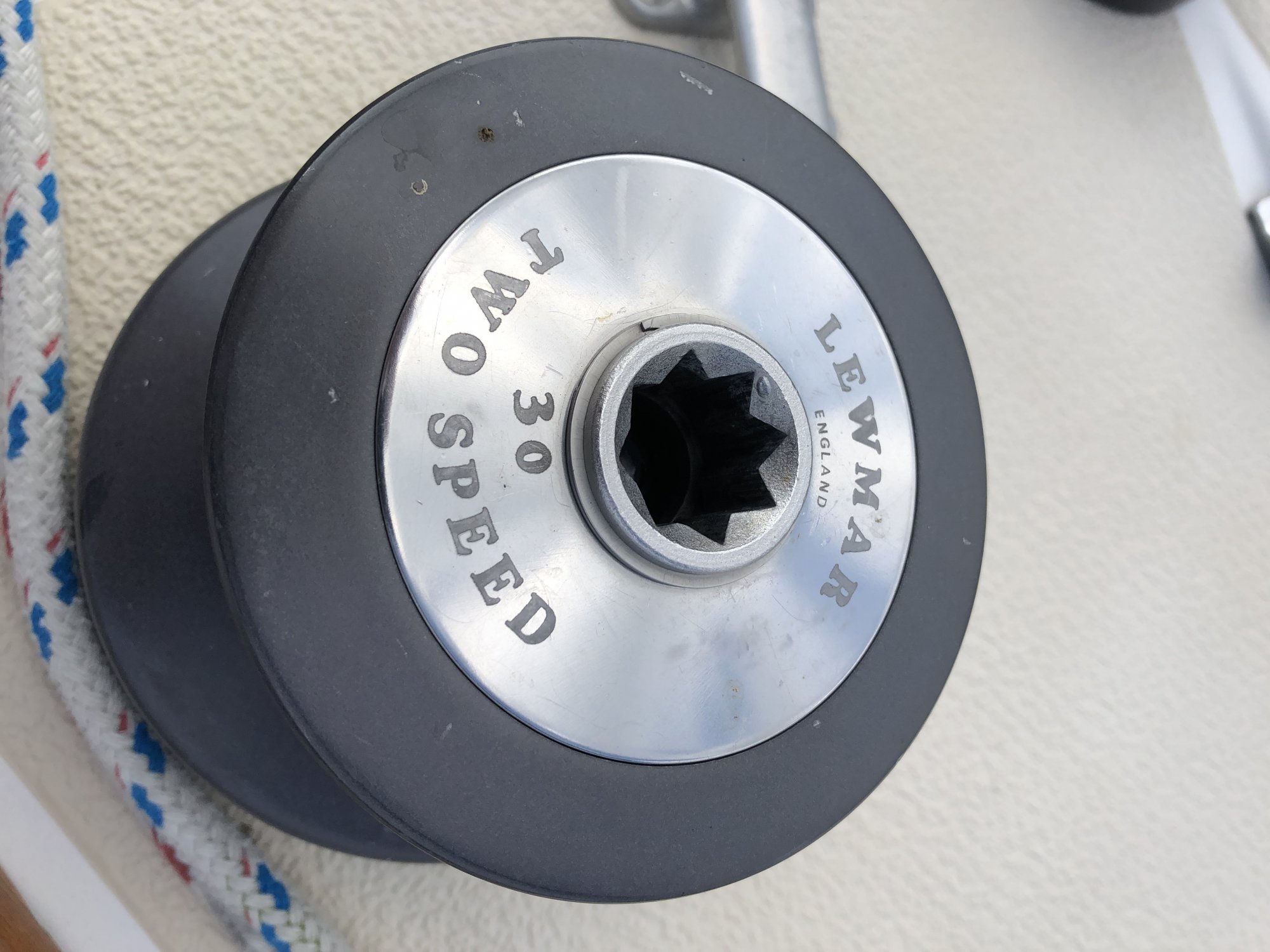

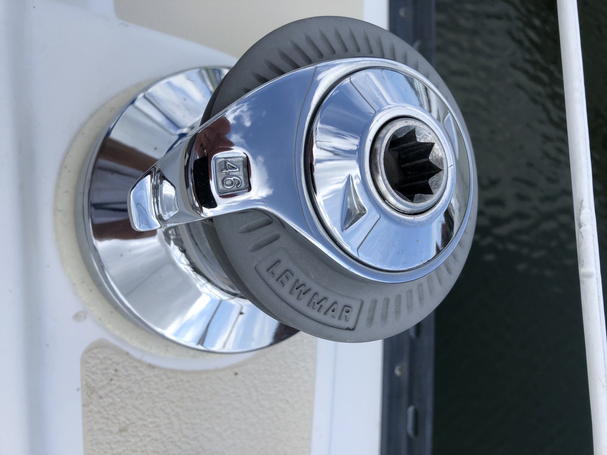

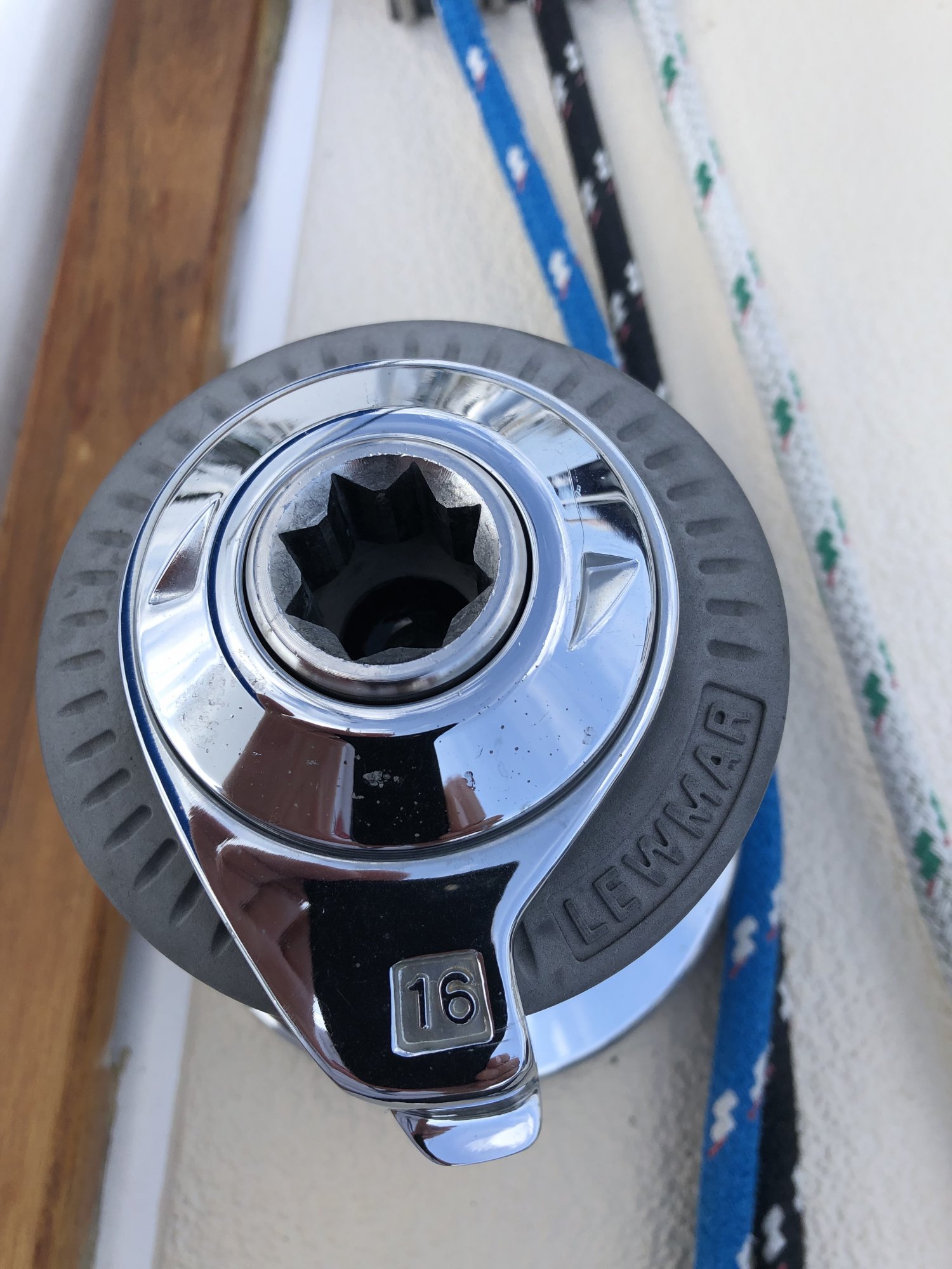

I've had this 1982 Tartan 33R for a couple of years now and winch maintenance is on my to do list. The boat has (2) 46, (3) 30, and (1) 16. I don't know if these winches are original to the boat or not. I've looked at the documents I've found online, and have only confused myself. Current Standard, Early Standard, Wavegrip, Wavespring, Holdfast, I just can't tell.
Or do I just get some Lewmar grease and go at it? And just worry about replacement parts if I see something worn or broke?

These can be easily taken apart so you can clean the parts, lubricate the bearings and pawls and reassemble. The two speed 30 has an expanding slip ring around the center where the winch handle fits in. Remove that with a small screw driver to get the ring off (find the end) and then that SS cap will lift right off and then you can pull the whole drum up and off which will expose the needle cage bearings, pawls, springs, etc. Quite simple indeed. Lube with a good winch lube (Lewmar sells it, Harken does too, etc. - I've actually been told by a West Marine employee that the West Marine winch lube they sell is no good, so based on his comment, I don't recommend that product). The self-tailing winches has divots in the center cap where you can take a tool and tap against those to spin off the center chrome piece. Then you can take a rubber mallet and strike it against the feeder/stripper arm to unscrew that and the winch drum will lift off exposing the guts. Clean and lubricate as needed. Reassemble. Make sure you don't throw parts overboard during the above process.

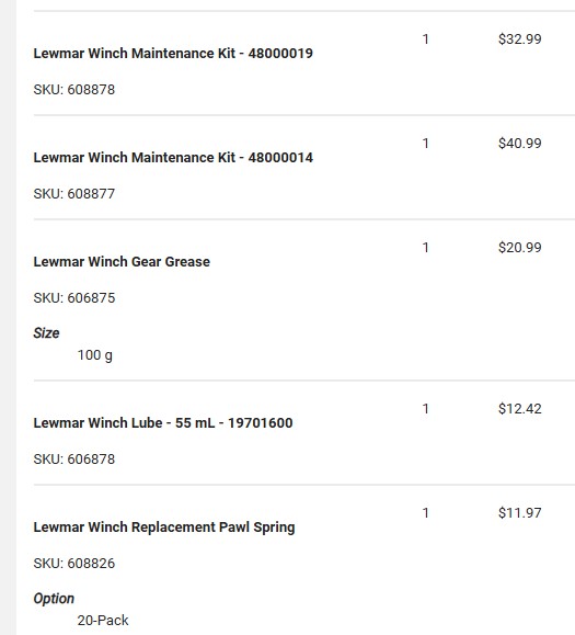

Well, I bought a bunch of stuff, but haven't gotten around to it yet. The boat just got hauled, once I complete winterizing it I'll probably give it a go. I've watched a few videos and it appears to be a pretty simple process.

I spent a few extra dollars and bought the Lewmar grease & oil to ensure I was using the right stuff. With four winches on board, it’s enough to last a lifetime. I use the cardboard box technique also. Try to service & polish annually, but it usually is every couple of years. Soak parts in a deep container filled with mineral spirits to cut thru old grease & Clean with a stiff parts brush. Dry with an old towel. Use an acid brush to apply grease to gear surfaces & place a couple drops of oil on the pawls / spring. Apply metal polish to highly polished smooth surfaces only.
