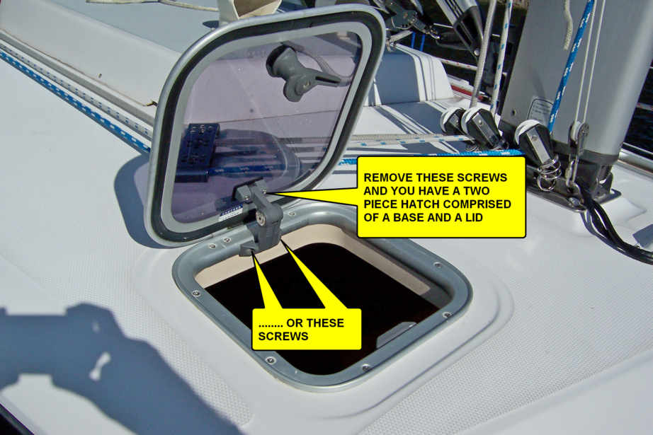

You will have to supply pics of what you have on your workshop bench at this time for us to relate our experiences.
I have re-attached the seals on several cover lids on our boat but have problems picturing what you mean by a one piece hatch. I can picture a two piece hatch with the lid and the base being held together with a hinge(s) :
Are you saying a one piece hatch has the base and lid fixed together with a welded on hinge ?
A simple picture of your hatch will make this much easier.

Lewmar makes a bunch of different styles of hatches, some are pretty easy for DIYers to replace seals, some not so much. Hatchmasters is the goto shop for Lewmar Hatch repairs and updates.
If you provide us with photos of the hatch we'll be in a better position to advise you on your options.
