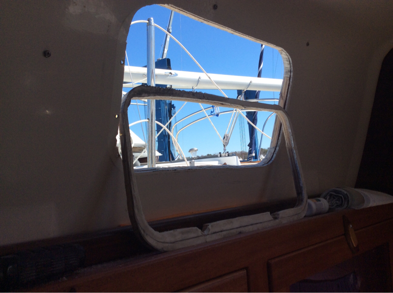

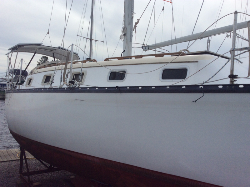

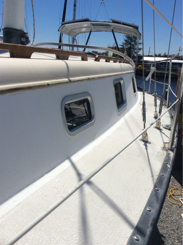

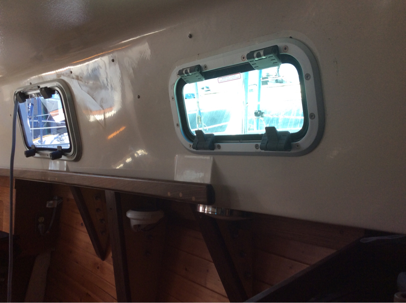

I picked up 5 size 1 Lewmar port lights for the 512 GrayPorts at the defender spring sale for $50 each. This past Sunday, I installed the first 2 without too much problem using 3m 4200. I love the look. For the larger ports, I chose Vetus PZ673 which is the same size as the Lewmar size 5, but half the price. I ordered 2 yesterday. If they also look right, I will order the other 4.
Added photos of Lewmar and Vetus ports installed
