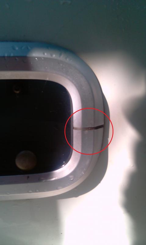

Joker,Just in case you're having leaks.
Most of the leaks of this era style boat is the sealant at the joint. Lewmar had a maintenance note on their website.
I thought that I had a problem with the O Rings and the gasket because that's where the water looked like it was coming through.
When I re-sealed the joint all leaks stopped.
The O rings you can get at your local hardware store.
