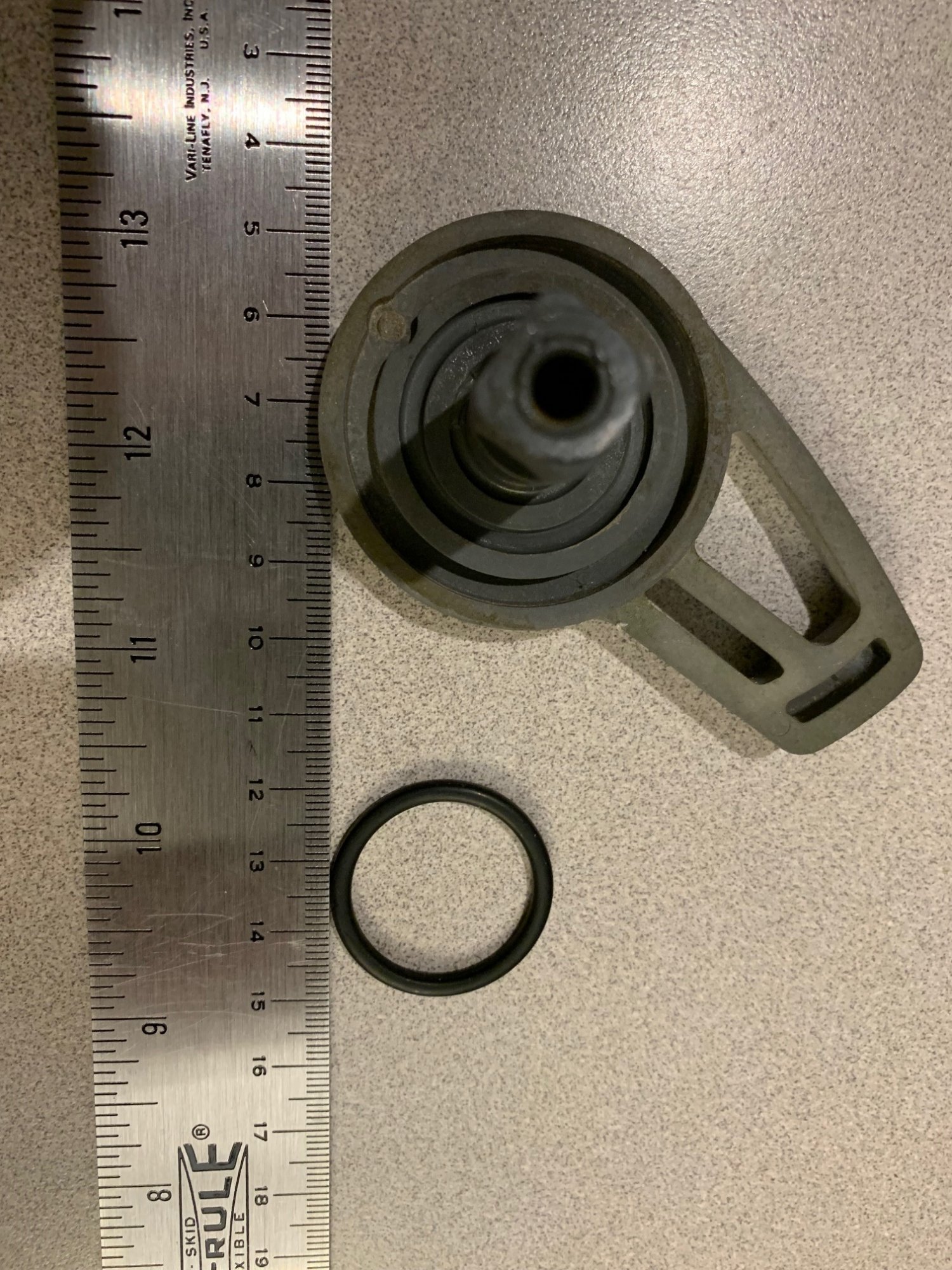

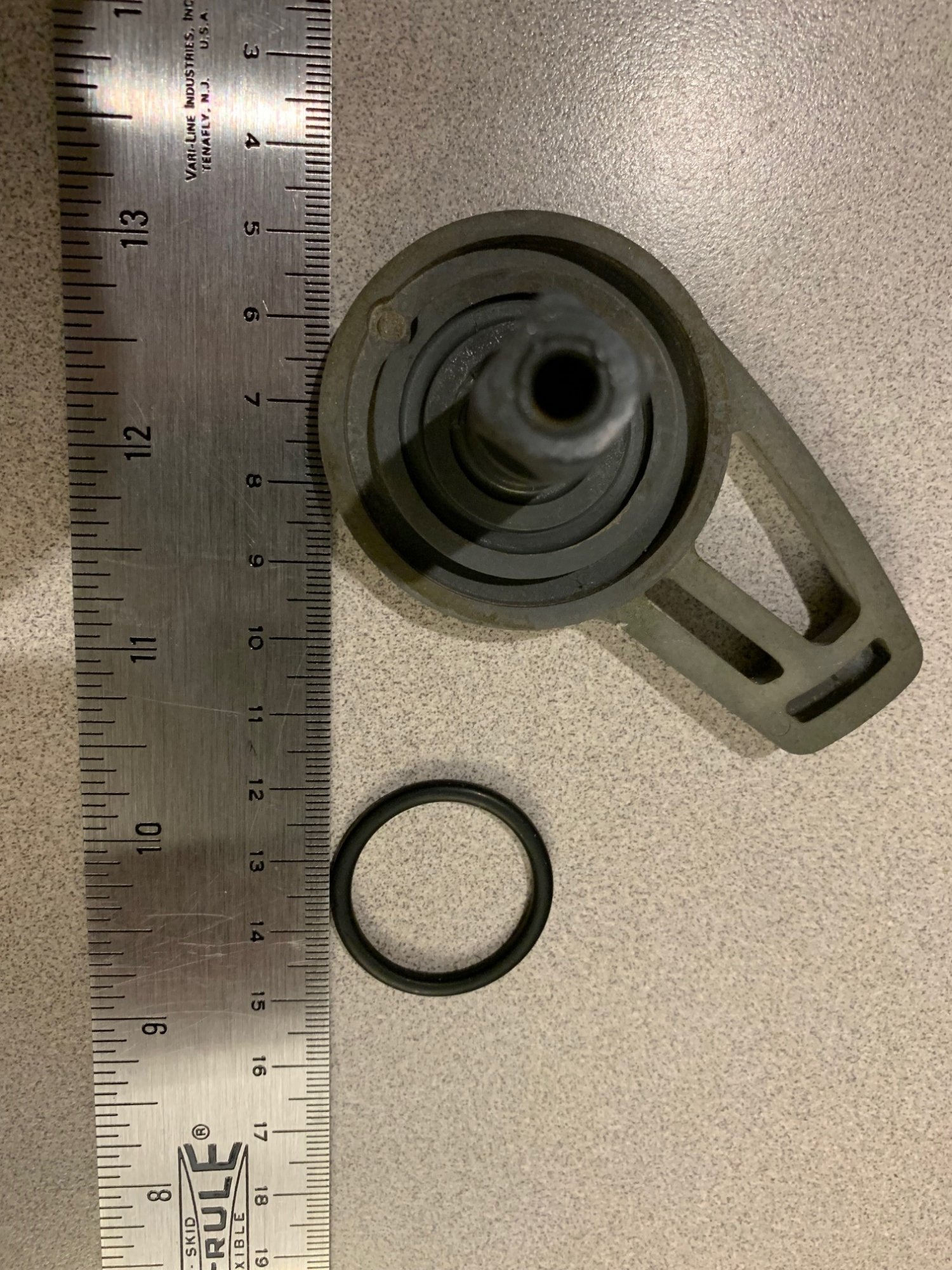

Hey Guys, looking to locate o rings for our Lemwar Hatches. I've tried local hardware and marine supply stores without any luck. Some oddball size. Any help would be appreciated, thanks,

I see what you mean. Huge selection. I've ordered 2 sizes...just in case. Thanks for the help!

I believe I used McM 9262K144 1.6mm cross section dia x 11.1mm ID
