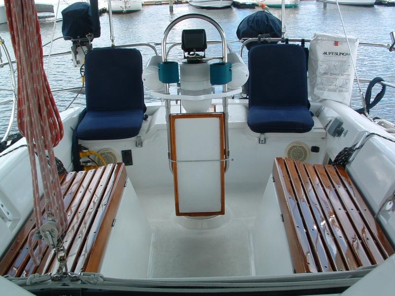

Have had one on both our boats and really really like it. Makes the cockpit much roomier and is out of the way. At night if there is an "issue" its there and ready to go! One less thing to worry about!

Have one on our 2005 Hunter 33, works well when open and out of the way when folded. the leather holds up very well. I wrapped the mid point with some whipping line so that I know by feel when the rudder is centered. Friend of mine got someone to put a turk's head knot on his center point. looks great.
