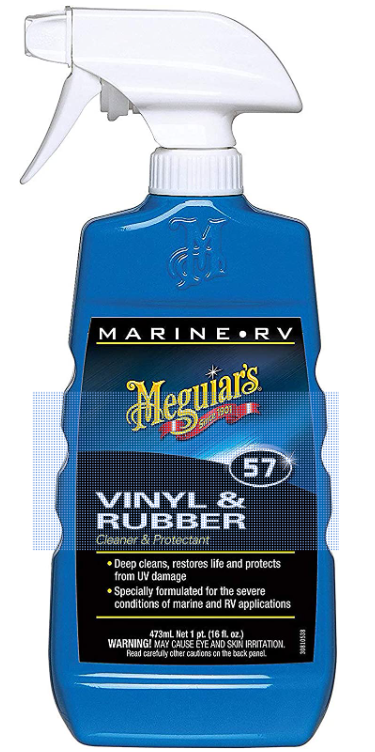

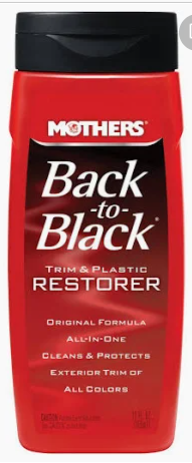

The gasket is now 16-17 years of age and appears to need replacement.
My opening hatch and port gaskets are now 24 YO and still look like new. A wipe of either :
..........every year will keep them looking like new. I recently switched over to Mothers as it has a heavier consistency, lasts a little longer and because it's not a Marine product, is half the price.
