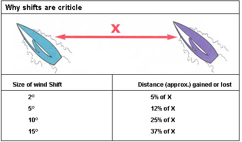

No. From a racing perspective, leverage is only relative to other boats.
Leverage is horizontal distance between them. The greater the distance, the great gain/loss potential if a shift occurs. The boat nearest the shift gains as function of the shift amount and the distance as shown below.
Its also why we 'cover' a boat (by tacking to stay in the same breeze) if we do not want to risk a loss due to leverage.

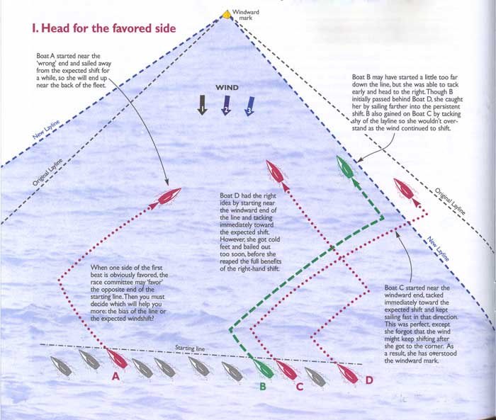

I tend to think that I would rather overstand than be shy of the layline. I understand that B is in the best position on this diagram, but I feel better when I know I can make the mark. If a shift goes in the other direction, then the advantage goes back to C. If the shift stays the same, then the boatspeed of C should improve with the lower angle, no? (Maybe it doesn't improve enough). At least C has a better position than D in any case, except when the shift keeps going right.
All true! But, also keep in mind that if the wind does go back left then both B & C go bow down and that perhaps puts C in the bad air off the back of B's sails so maybe she gets a bigger knock as a result. Also, when they go bow down the boat in the lead and to leeward gains - the geometry - she shows C her stern - that maybe puts B far enough ahead to be able to tack and cross C if necessary to get back right to a layline. Just something else to consider in the mix. If the wind keeps going right in the diagram then B has played it perfectly.
