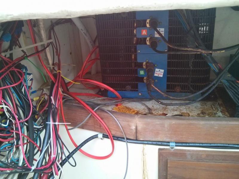

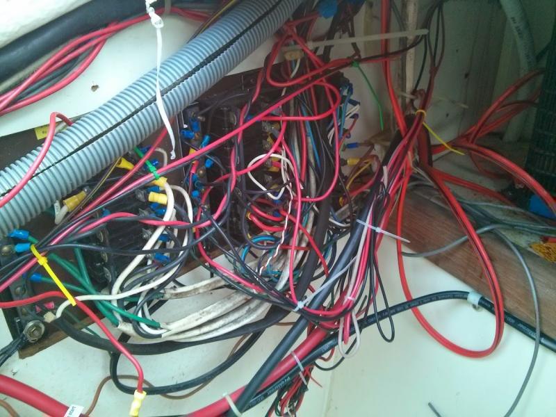

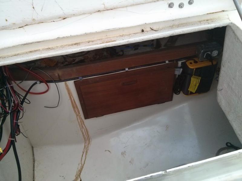

So my Hunter 36 has handsdown an awful wiring job. The back of the panel opens out under the starboard lazarette with no water-proofing on the back. The battery charger is located even further back! And the condenser is there as well, and rusted to hell... nothing is labelled of course
Anyone want to post their setup? And any advice where to start?

You wiring looks pretty much like most of our Cherubini Hunters before renovation - a combination of '57 Chevy dashboard and every previous owner's add-ons and kludges.
I suggest you familiarize yourself with ABYC recommended practice, an excerpt of which you can download here. You can replace or repair all that rat's nest in the pictures, but you probably won't be able to renew the wires that run to the various lights, pumps, etc. throughout the boat since that wiring was installed prior to bonding in the headliner and floor pan. It probably doesn't need replacing, just cleaning up and re-terminating. I don't know how similar the H36 is to the H37C but there are show n' tell articles on rewiring the panel by myself, Jose Guidera, and Maturin II in the H37C archives.
Buy quality marine wire and components from reputable manufacturers like Blue Seas and invest in some professional-grade tools such as a wire stripper and a crimper. All this can be purchased online at the chandlery here at SailboatOwners.com, so support the site when you can!

The back of my electrical panel looked much the same as yours when I bought my boat. But it did have a plastic back cover that had the appearance of being OEM. It wasn't in the best of shape, but I did manage to salvage it for continued use. The cover doesn't really need to be water-proof since the back of the panel is in a location that isn't typically subject to rain/seawater exposure. (And if either variety does get to our boats' back panel location, we have some really serious problems that will have taken out a lot more than our panels' ability to function!) You can make your own cover. Or take the measurements and head off to a big box store and see if you can find a storage box for instance that would fit over with lots of room to stay away from the connections. Use your imagination.
My "rats nest" is improved from what it looked like when I bought the boat. But compared to the elegant/precise work that I have often seen posted, I still have a rats nest...
... But it is now a much safer rats next. What I did was mark each wire, then I detached them from the copper bus bars on the back of the panel. With 600 grit sandpaper, I restored the surface of the bus bars to clean copper appearance. Then I cut off each wire's terminal. I removed about 3/8" of the insulation from the wire. Our boats were built before the ABYC began to specify only marine grade tinned copper wire. Ours are marine grade, but non-tinned. My boat has spent its life in a generally low humidity dry location. Because the condition of the metal strands remained good, I simply polished up the newly exposed surface of the wires and crimped on new terminals. I did this only for the low amp draw and short distance circuits. For the wiring to my bilge pumps, however I did replace with new marine grade wire.

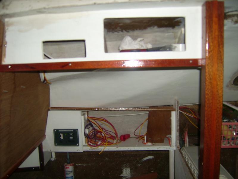

I pulled all the wiring out of this 1974 boat and ran all new stuff (one piece I recently tried to reuse kept breaking off clean inside the casing). In fact I jammed so much wiring into my little boat that most people (including my late father) would consider it insane. But about 90 percent of it is vital; the rest is desired options (such as cabin footlights and switches to change between red and white cabin lights, and between masthead- and pulpit-mounted running lights). And it's well marked, sensibly led, and connected visibly and accessibly. So I really shouldn't defend it. If I'd kept the original 4 circuits the factory had given the boat, I'd have had a much worse problem.
The pics I put in are old-- much has been done since this. Diana's new electrical panel is the shelf above the quarter berth. About 1/3 of the space is devoted to the 115vac (a main breaker and one for the charger). It is separated by a small bulkhead from the 12vdc, which is vital (these two should never share the same spaces). A piece of PVC acts as a conduit through the 115vac through which most of the 12vdc comes. There are 12 breakers, the bilge-pump switch, rotary switches and the voltmeter (which works on momentary push-buttons for three batteries) and the fuel gauge
. There is a piece of PVC going vertically down from the panel to the bunk top (just past the edge of an adequately-wide cushion). Under the bunk is the battery switch and the runs to the batteries. That's all that's below that level.
I would take a newer pic but it looks sort of like this again because I took off the hinged panel for painting. The panel with the breakers in it swings down and stays level, like a workbench, by a length of cord. The breakers are all labeled upside-down in back because you'll see them right-side up when the panel is open. I use a letter code for the circuits; runs of wire are labeled at all connections (such as at the top of the spar, both sides of the connection block, and at the circuit panel).

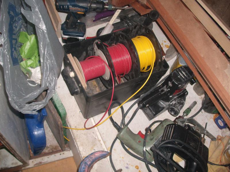

The other pic is of the traditional Cherubini Boat-style 'Wire-O-Matic', which for Diana I made out of a battery box. A piece of CPVC slides out (held in with clevis pins and roll pins!) to change the reels. I consider this a vital lifesaver when running wire. Typically I keep rolls of red and yellow and pull them at the same time (duh). You can make a Hose-O-Matic too. (I'm thinking of

3) I haven't tried removing the panel, it's on there pretty tight. If I enter through the lazzertte though I can get to the back of the panel fairly easily.

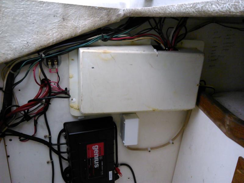

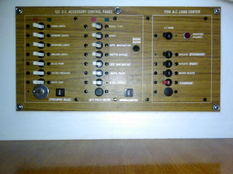

In case they help, here are pic's of my 1980 H36 breaker panel and the rear of the panel as viewed from the lazarette. Note the plastic cover that I mentioned in my prior post. Not a work of art, but the appearance is certainly nicer than the functional rats nest that is behind it.
I found it very difficult to work on the back side of the still fastened panel while squatting down on the slippery sloped floor in the lazarette. So I tweaked my wiring so the panel now "hinges" down onto the navigation desk for more comfortable access. Just takes a few seconds to remove the six bulkhead fastener screws (after laying down a sheet of cardboard to protect the desk from damage). I do recall that because of the wires being too short (as you have alluded to for your boat), I initially wasn't able to swing down the panel enough to work on it. But I discovered that only a few wires were the problem. And by loosening or removing cable clamps and ties, I could pull out enough slack so the panel could swing down to a working level on the desk.
