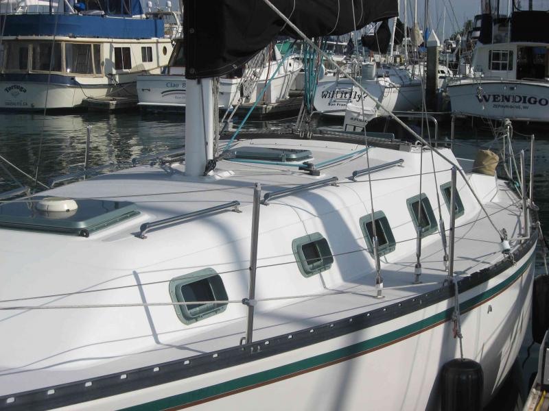

Thanks for your post including the pictures. As another Cherubini Hunter owner (1980 build), your post/pictures prompts the following observations which were successful for me:

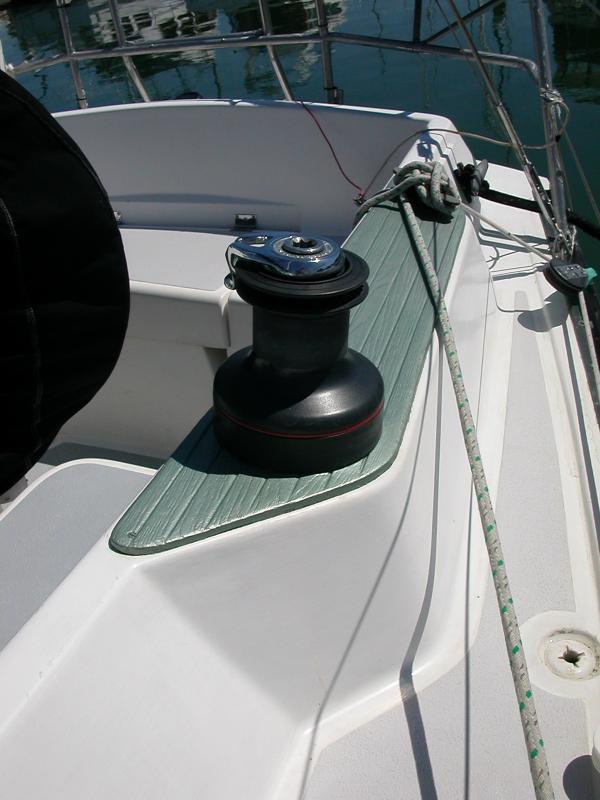

- Upon my purchase of my boat, the non-skid sections on the side deck, the cabin top and the cockpit seats were much like in your pic's. Stained, but in very good mechanical shape underneath the grime. Using a an electric 1400 psi type pressure washer on the "fan" setting and the gun end not to close, I was able to clean the non-skid very well and get off the surface oxidation without damaging further. Underneath, all the original stippling relief was still ok - almost new looking. But I was concerned that maybe this wasn't the case for long in the continued UV exposure. So think about re-coating the non-skid before it begins to degrade. I used Interlux 2-part Perfection mixed with their non-skid granular additive and mixed with their flattening agent to reduce the gloss. I did this five years ago. And the non-skid today still looks virtually brand new. Because a perfect application finish isn't required on non-skid, and I knew that the area was never waxed, all I did was mask the areas and paint on with a brush. Just took a morning. Because the non-skid section has lots of surface porosity, no pre-primer is necessary. I suggest that you choose a color that matches your existing non-skid, or at least is close. Two part Perfection will last many years longer than one-part non-skid finishes.
- Your port frames still look OK. But again, UV is bound to take a toll soon. I painted mine with Rust-Oleum's hammer finish paint to protect. Easy to apply and lasts a couple of years. Refinishing with a second coat after a few years is just matter of just aggressively wiping off the surface oxidation with a terry-cloth rag and repainting. Attached are a couple of pictures of my boat after painting the non-skid the port frames.
- If your exterior smooth gel-coat on the cabin top and in the cockpit is still ok (mine wasn't and needed repainting), wax it soon to protect. Resist getting wax on the non-skid if you do think you might ever want to paint the non-skid sections.
