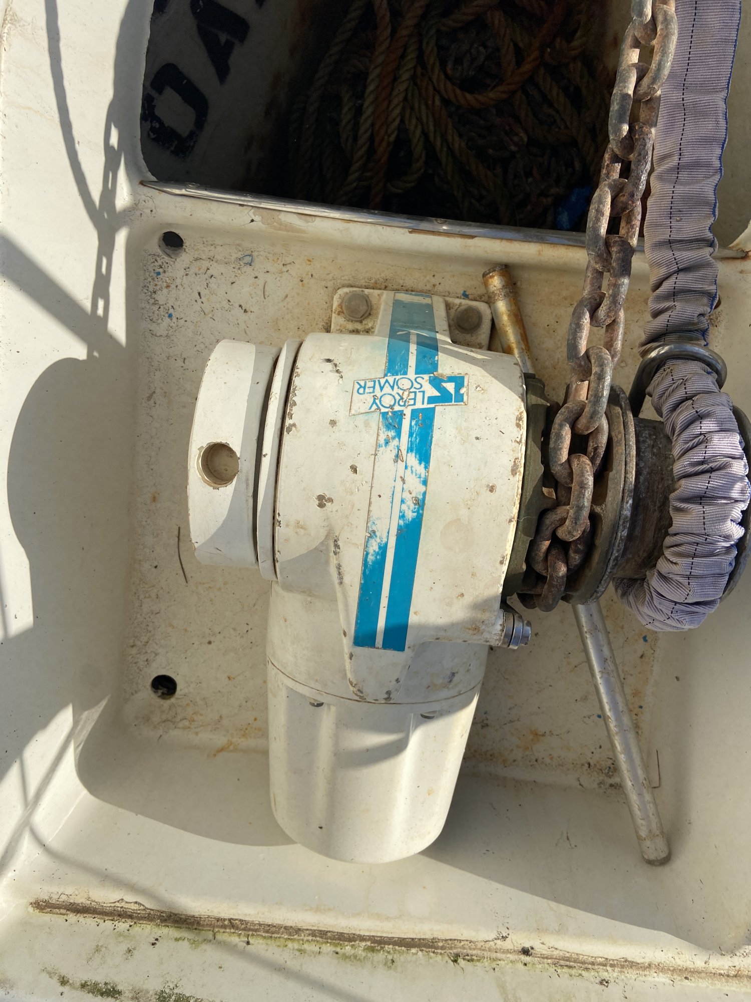

See photo attached…
23,808
The windlass is a blast from the past. Popular in the 90’s now no longer made. Parts are scarce.

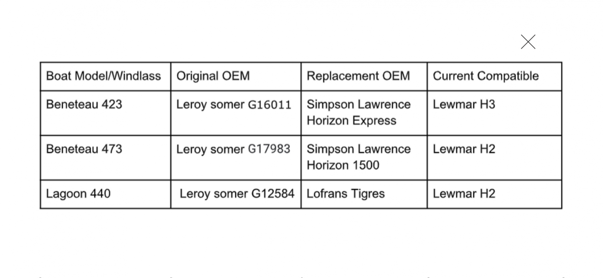

Found this graphic in a discussion about the windlass. It shows what some owners have used to replace a unit.
