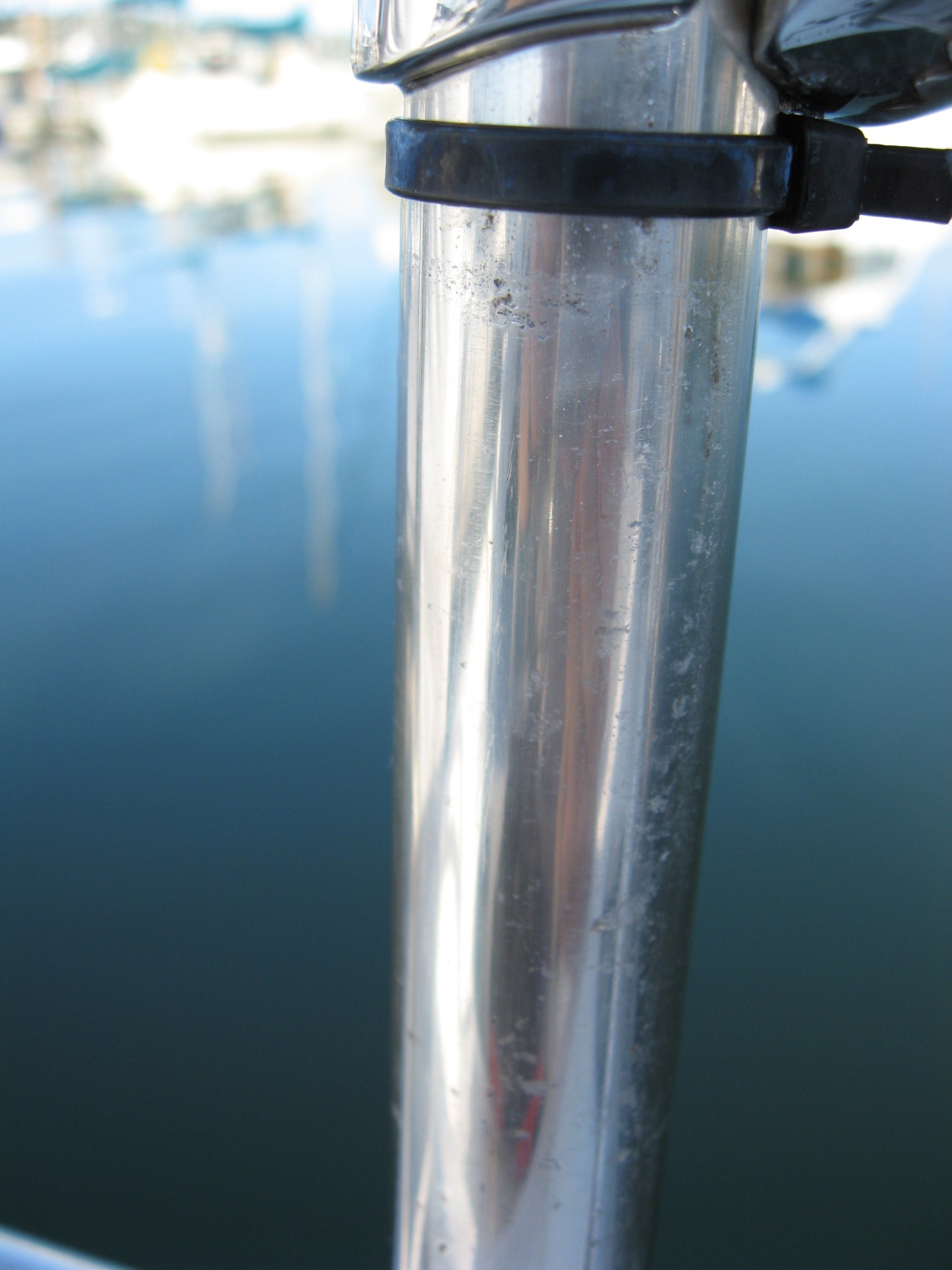

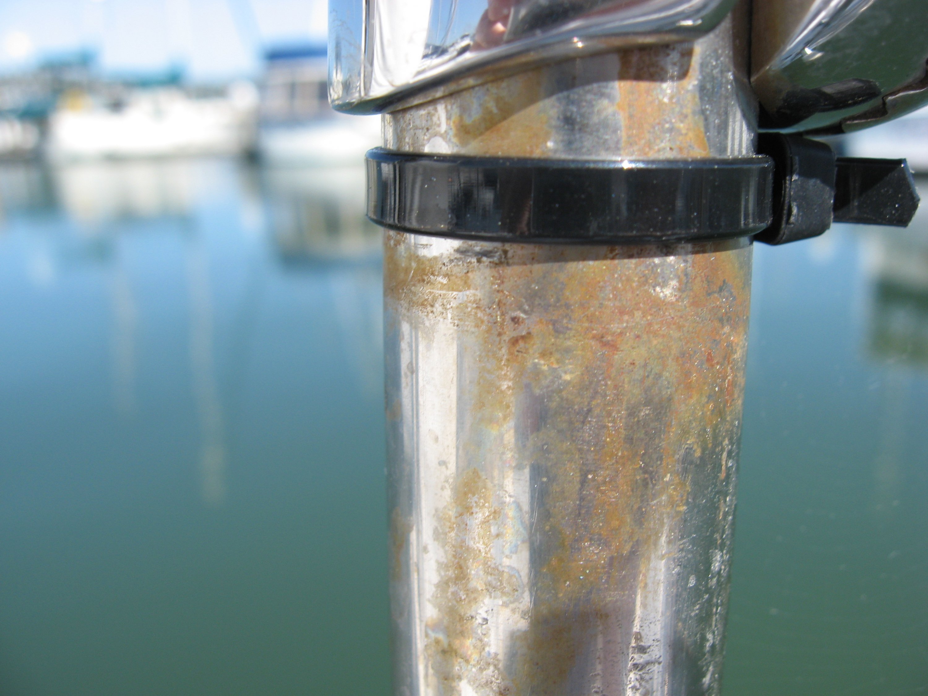

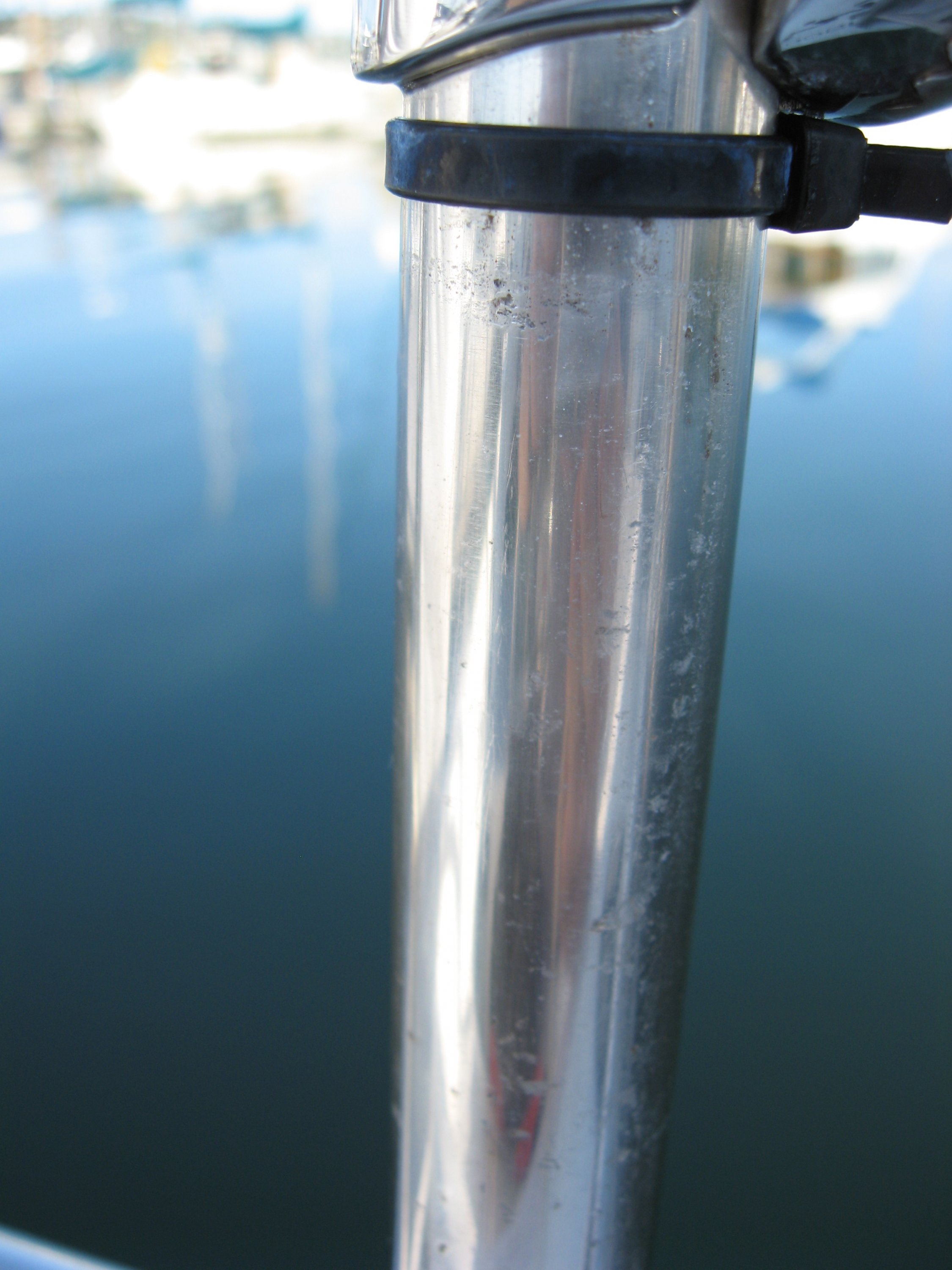

Several years ago, Mainesail posted information about a product called Spotless Stainless. Earned high marks. It is a gel whose primary ingredient is citric acid. It will remove the surface rust stains from stainless steel. It is advertised that citric acid also will passify the surface so that the surface surface takes longer to reappear. This has been my result. I apply once per year to my 36 year old exterior stainless and it looks quite good again. SpotlessStainless also will remove SS rust leach stains from gelcoat. Attached are pictures of one of my before and after Spotless Stainless locations. A PO had mounted something on the stern pulpit and underneath, not able to have normal oxygenation, it became pitted. Normal polishing wouldn't remove the rust from the pitted spots. Took a couple of applications of SpotlessStainless to restore to a much less embarrassing state. Google SpotlessStainless for the website. A similar product, but not quite as effective, is CitriSurf.

I've also used Spotless Stainless after reading Mainsail's post about it. I had the same great results that Rardi shows. I use it now for all my stainless bits. Tried something else on the railings and they quickly showed surface rust again while the first bits I used Spotless Stainless on are still free of rust.
