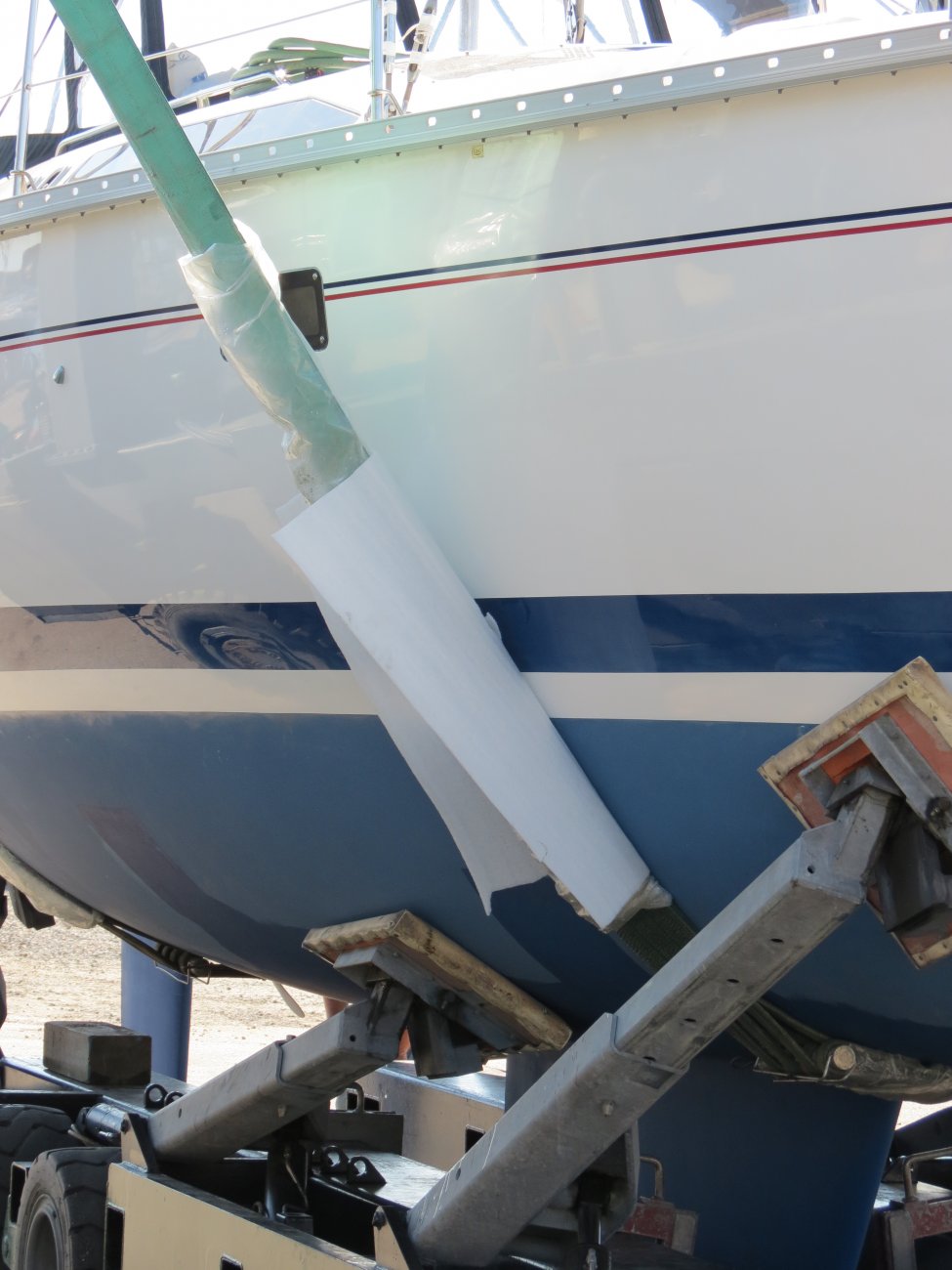

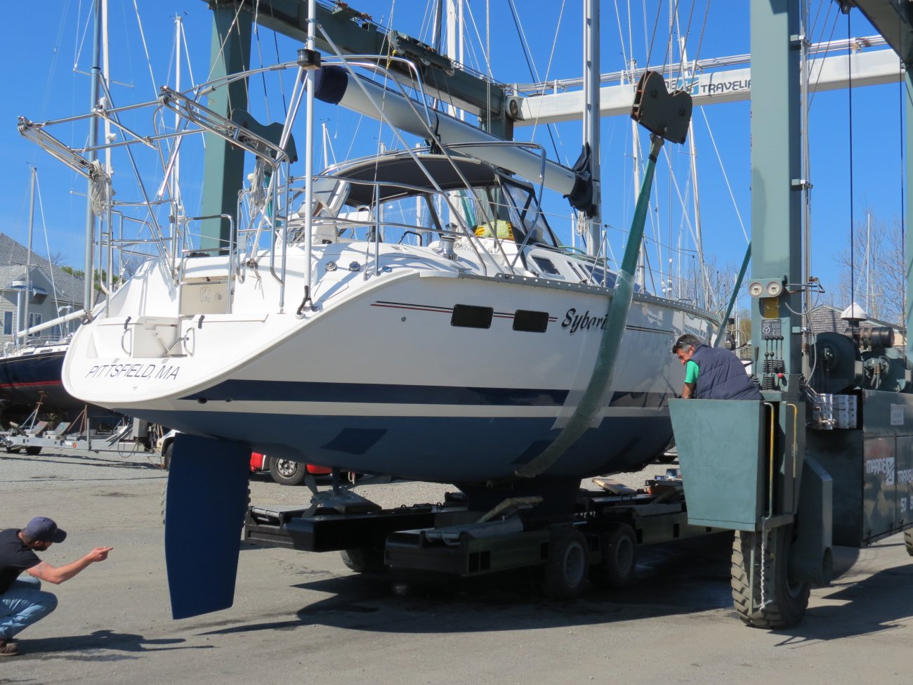

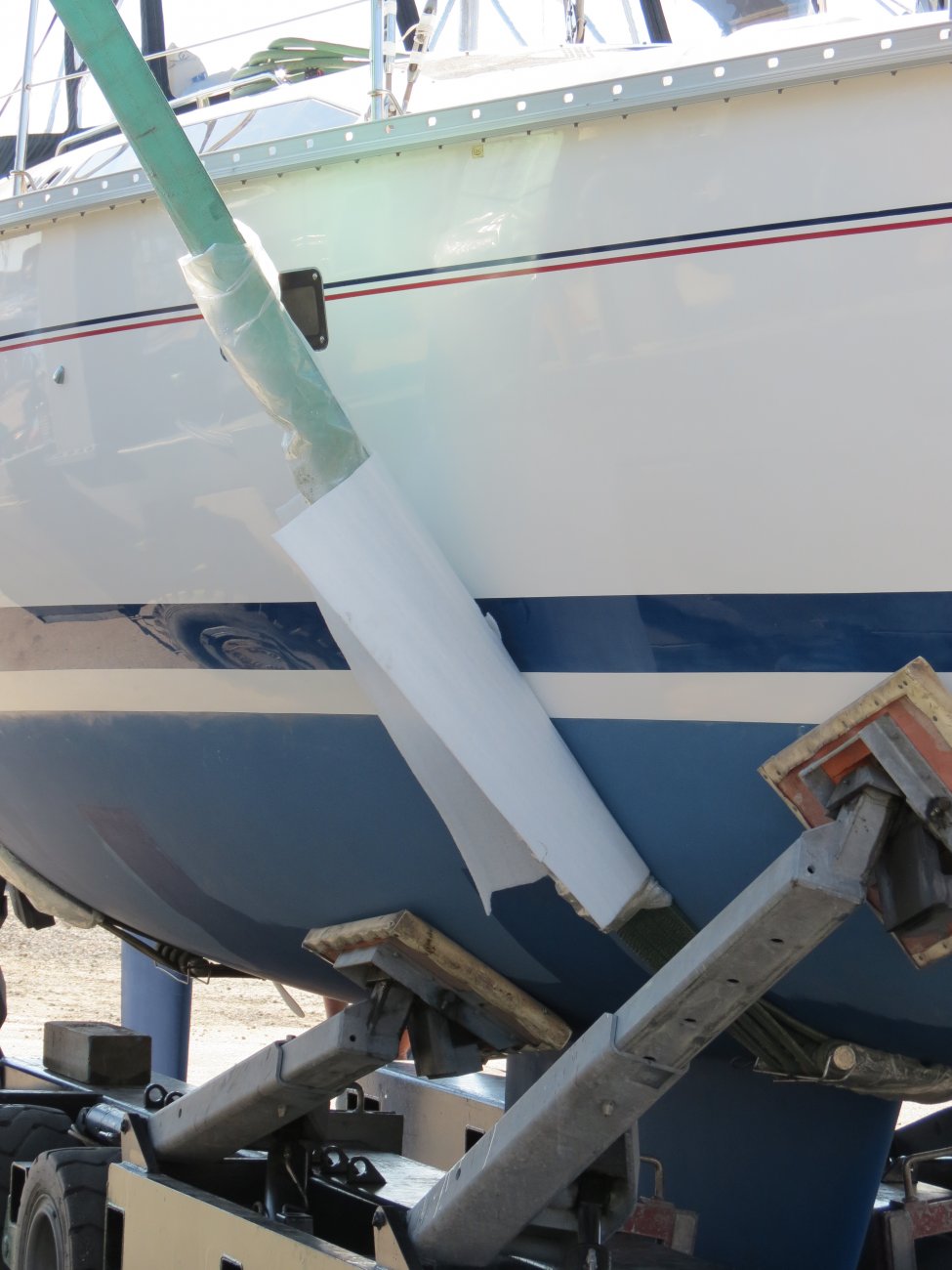

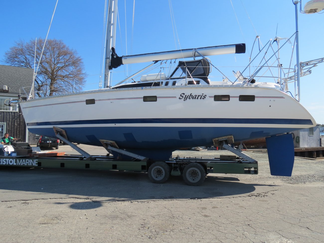

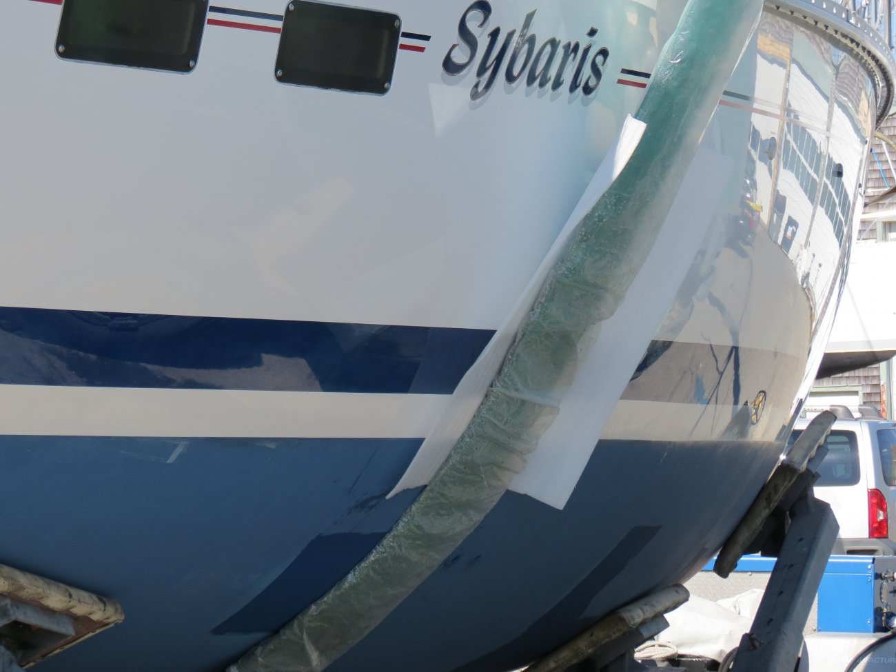

Here ya go...
If you look very closely you can see the small yellow stickers marking the lift points.
2016_0510_091254.JPG 2016_0510_091914.JPG 2016_0510_091958.JPG 2016_0510_092122.JPG
