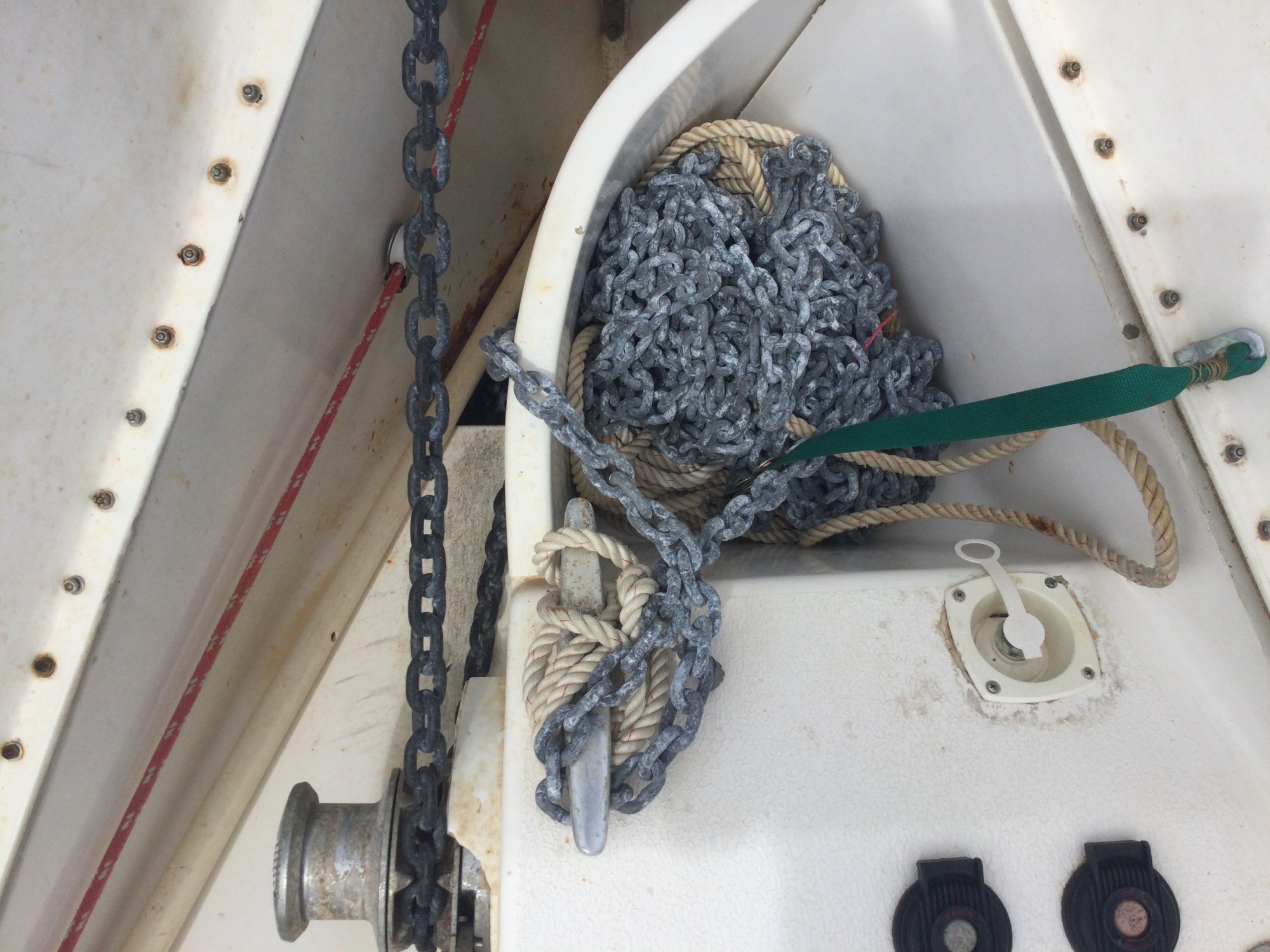

I have tried something different, I usually anchor in 15 to 20 feet rarely 25 ft so50 to 75 feet of chain is enough practically all the time. I loaded half of the chain over the line hold (see picture) big improvement, chain will still bunch a bit but needs only slight push to slide in.

Does the chain bunch up on the slide area just downstream of the windlass, or further down in the chain locker? If on that slide area, then that's where I was thinking that maybe a slicker surface might help, such as hard shiny plastic or stainless steel sheet.
