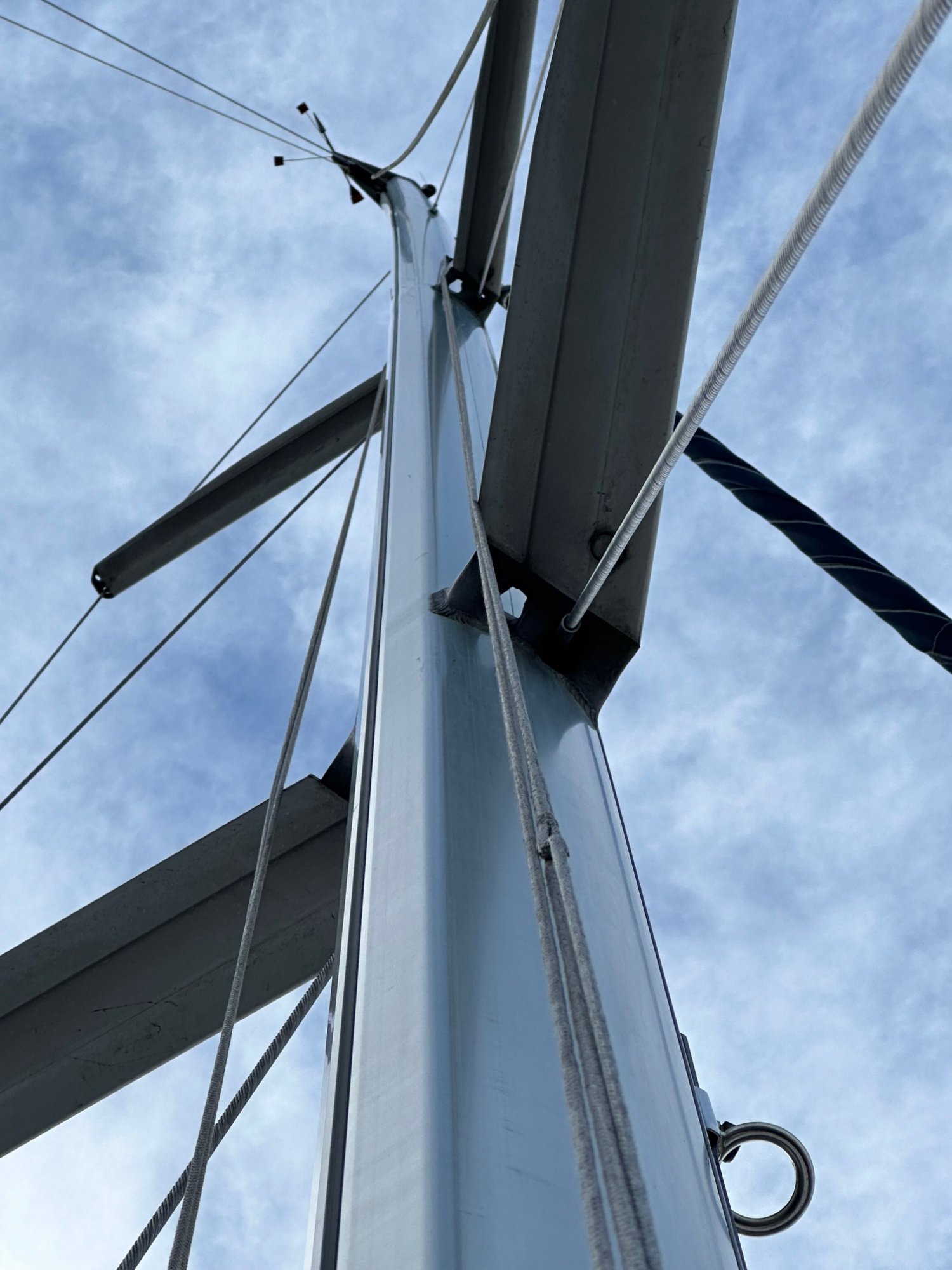

I am close to buying a 1989 Legend 37. The main is impossible to raise the last 15 - 20 feet without going to a winch. It goes up to the point of the rake in the mast and its like hitting a hard rubber wall.
Does anyone else have this issue raising their main?
How much rake is too much? This boat visually has a lot.

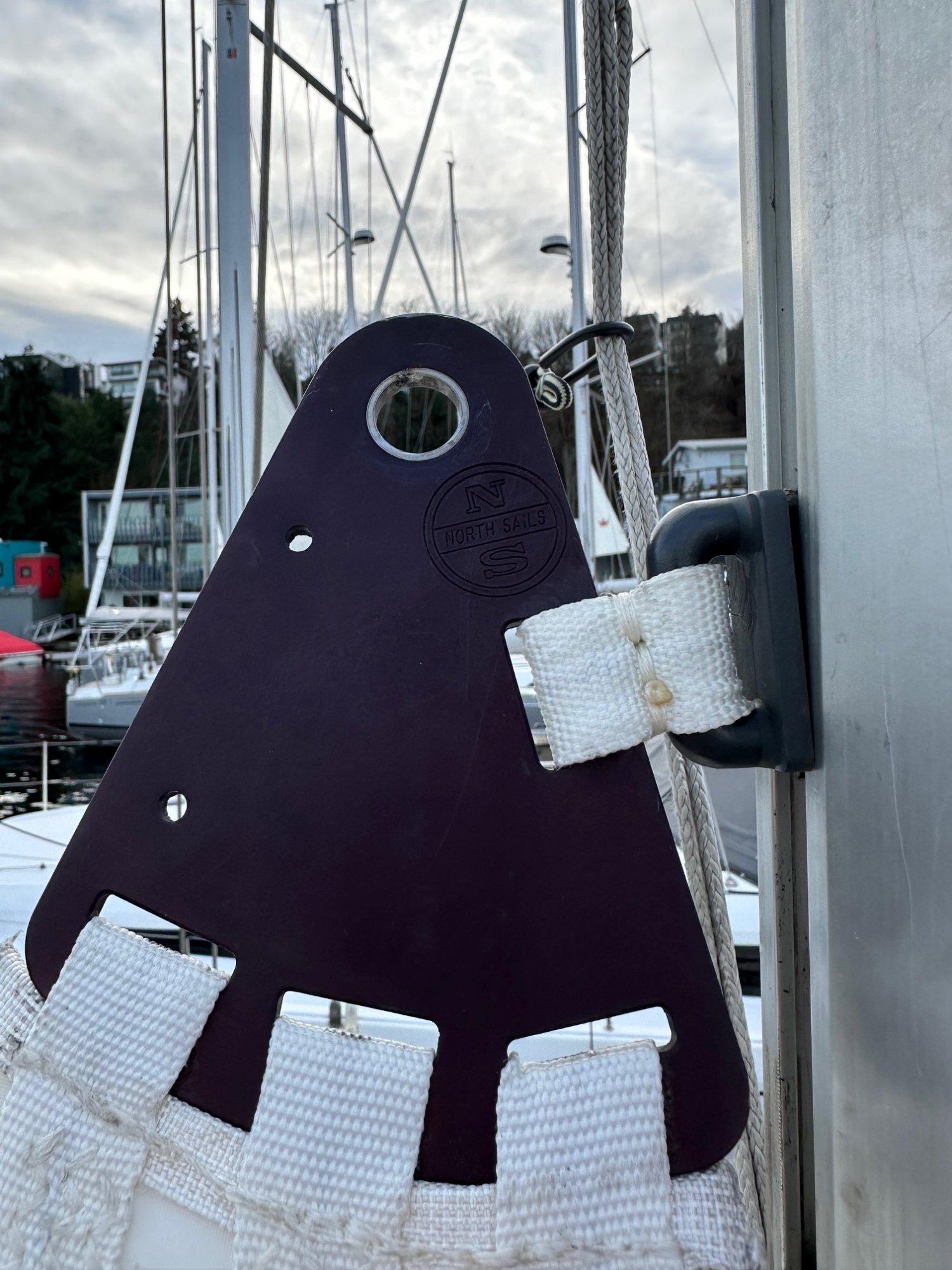

The sail headboard has only 1 hole for the halyard and it is right close to the mast making the problem as bad as can be.

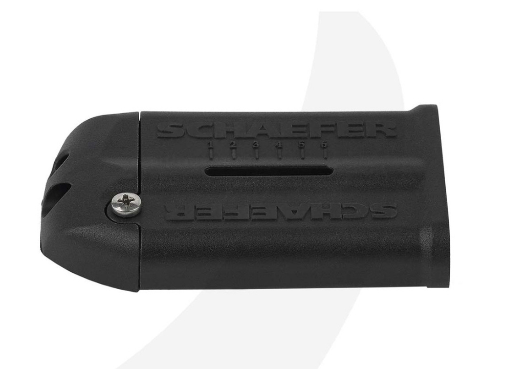

Someone probably knows some other solutions... search full batten binding on mast... but one I considered was having a sail-maker replace the batten receivers with Schaefer Battslides w/ internal slide for your track (MM8/0.9", I believe)

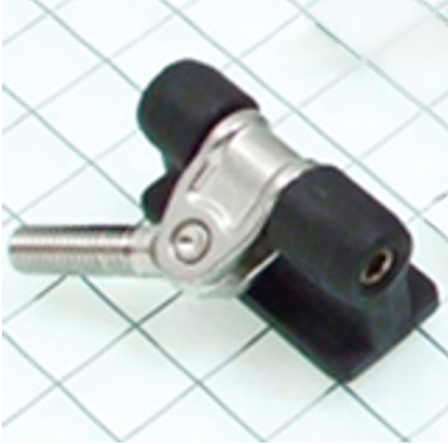

Excessive batten pressure can cause binding. Depending on the sail, it can be done by easing there pressure on the velcro holding the batten in the pocket or by an adjusting screw on the batten car.
Dirty sail tracks or slugs can cause jamming and excessive pressure on the slugs. Spiders like sail tracks to hide in.
Replacing the slugs on the batten cars with one size smaller may relieve the pressure and reduce binding.

1. Drilling another lift point in the headboard aft of the exiting one. See pic.

Also note the black sail slug in the headboard pic. It has a flat part that runs outside the track as well as the part inside the track. I would think that as soon as the halyard does not pull 100% parallel to the mast that the slug's exterior part will drag the outside of the track.
Do you guys have as much prebend in your as you see in the pics?
