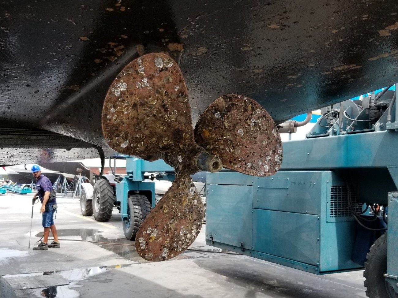

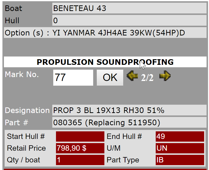

The official Beneteau online catalog (see screenshot) specifies a right-hand propeller for that year/model, while the one actually installed on the boat is left-handed (see attached photo. BTW - I also checked the actual shaft rotation: clockwise viewed from stern when in reverse gear).
The Yanmar 4JH4AE engine manual and the KM35P transmission datasheet also state that the prop should be right handed. My local Beneteau distributor cannot explain the discrepancy either.
Before I go ahead and order a 19x13 left-handed prop and shell out $800-$1000 (assuming there is one available), I was wondering if anyone can help explain the mystery. Could it be a specific production run for the Yanmar engine with a different rotation than reported officially? Thank you

That is definitely a LH prop. No knowledge as to why.
Here is an image of my RH prop for comparison.
