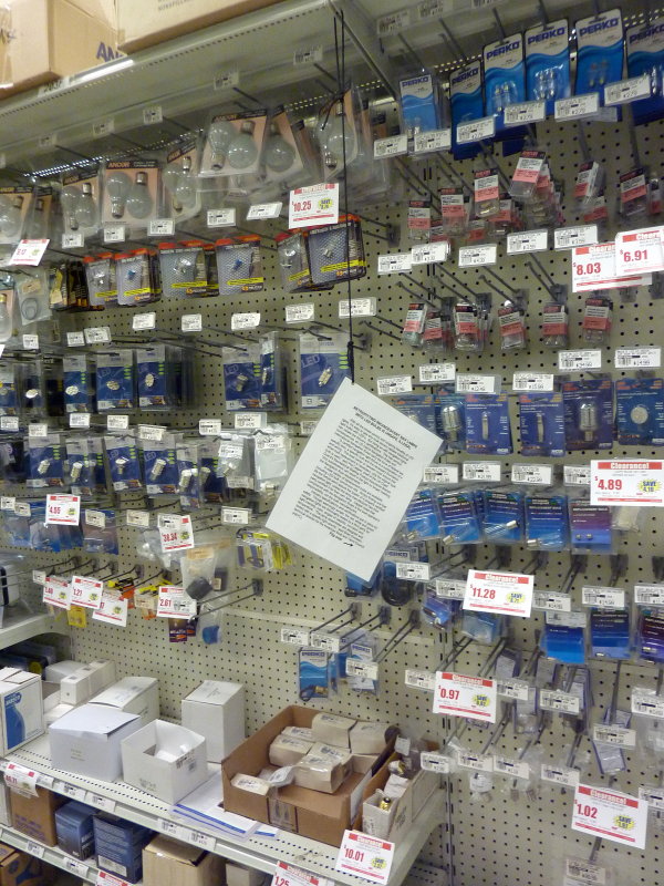

Hamilton Marine feels so strongly about not being involved in the liability chain they have this sign hanging right next to the LED lights where you can't miss it:

Seems no one wants to accept the potential liability for installing aftermarket LED's not even the people making them or the people selling them. That says a lot to me....
