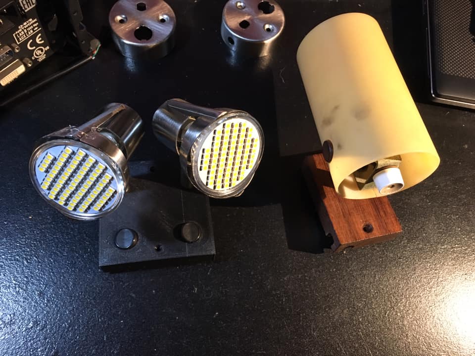

Just curious about those with LED strips, I've done the math and found that what I'd want to do with LED strips would use a bit more current than I'd want to save battery energy. I found it still better with single bulbs.
I've changed all my incandescent bulbs with matching LED versions. I replaced my cabin light which was pretty useless with couple of really bright fixtures so I can now see and work on something at night.
Here's some good inexpensive fixtures:
Here's what I replaced my cabin light with, I made a new double base for the two fixtures so I wasn't mounting two things, just one.

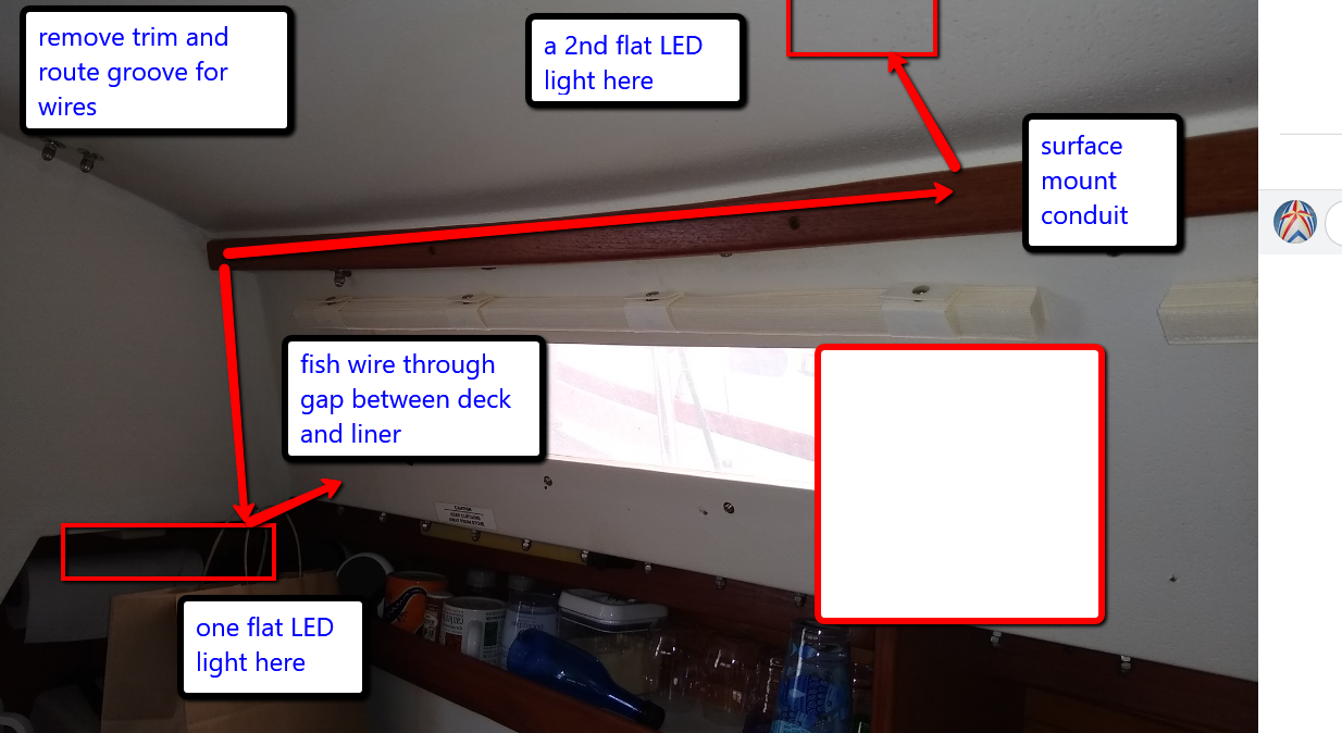

Hayden, do you happen to have a photo showing how you did the one over the sink? My wife has been after me for years to add a light there.
I do not have any photos and will not be at the boat for some time. My boat is a Mk2 and it has a teak trim molding piece where cabin ceiling and wall meet. What I did was run a wire in a groove that cut into the back of the trim on my router table. I then used surface mount conduit from there to the light over the sink. at the aft end of the trim, I drilled a hole small enough to be covered by the trim but large enough to fit my fish-tape into. There is about 1/2" of space between the deck and liner in this area. I drilled the hole for the fixture over the icebox and was able to get the fish-tape down to it and pull a wire. Then I pulled a wire from under the shelf over the icebox where the liner / deck molds are not closed up. In the attached screen shot, the arrows are the wire runs and the boxes are the approximate locations of the lights. I pulled this photo from the net and it is not my boat so I did my best to draw in the system.
All-in-all, it is a very clean installation with only the short run of surface mount conduit exposed. The improvement to the light in the galley is fantastic.
