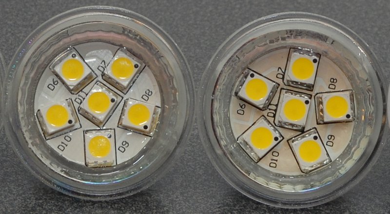

Who can tell me which one is the Marine Beam bulb and which one was purchased from Superbrite LED? Both are sold as warm white. Both claim the same beam width and current draw.
Identical? Not at all........
Superbrite LED (drew .2A more than the Marine Beam)
Marine Beam
Camera on fixed tripod, settings identical (manual mode) bulb test fixture 25" from door. In the real world (human eye) the Superbrite LED was a painful blue tint the Marine Beam was actually warm white. The Marine Beam also had a wider spread and drew less current.. Oh and worst of all the Superbrite LED bulb caused lots of RF noise and the Marine Beam bulb none.
