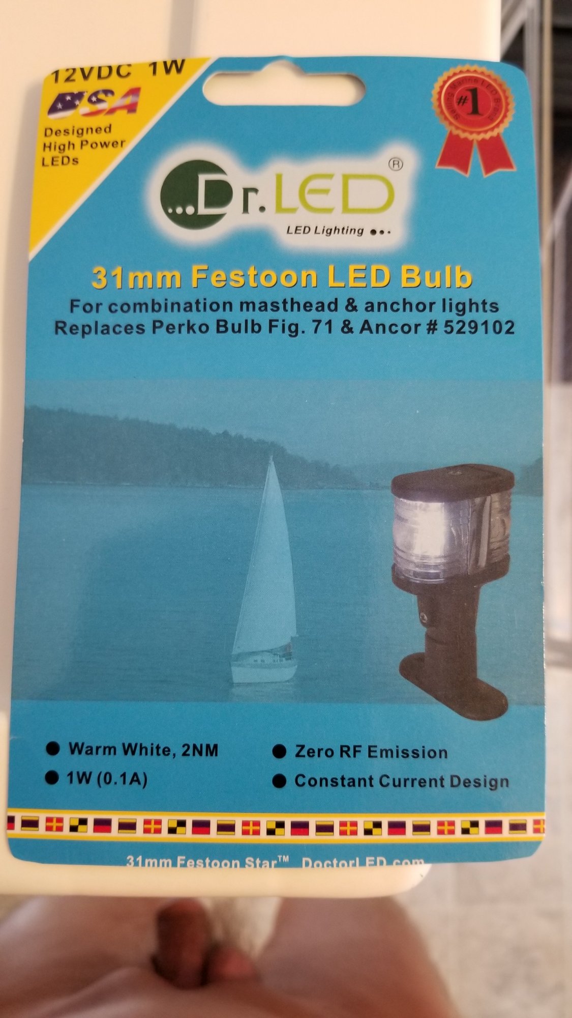

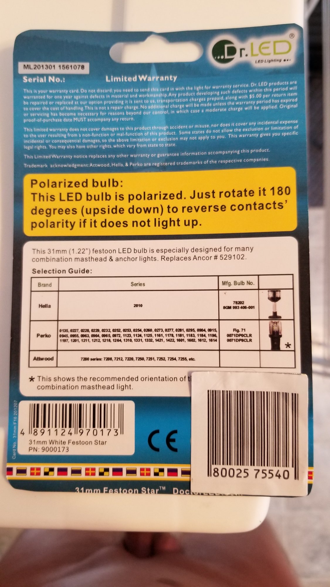

Here's the package from the festoon bulbs I bought for my Masthead light. I don't have any record of how many I bought so I'm not sure if I put them in the nav lights or not. Possibly not, as my parts box has only 2 old festoon bulbs. I would have kept them all if I replaced the nav lights too. The package from my Aqua signal series 25 bow light indicates the festoon bulbs are 41 mm. In 19 years, I think I've only turned on the nav lights once. It doesn't get dark here till past 10 p.m.
