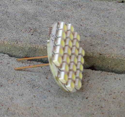

For those interested, I've replace all my light bulbs in my H31 with 24 LED surface mount devices that simply plug in to replace the existing bulbs.
Power usage drops from 500 mA (eg 0.5 Amps per light) to around around 1/10th (or 10%) 60 mA with a brighter cool white light.
No changes to the original Hunter light fittings, just push these little beauties in.

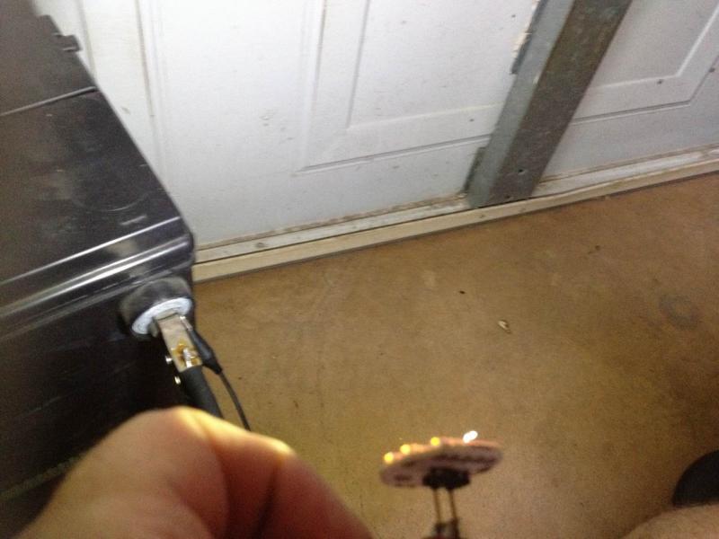

Pics attached - to show the light output, I took a photo in my dark garage
PM me for details.

From what I can see from the fuzzy backside picture, it is a resistive LED.
That means that there is no voltage regulation, current or linear.
They work well when only using the battery but be carefull when the charging system turns on and the voltage goes to 14.5 - 15 volts.
They will start getting warm or hot.
There are many threads on this website regarding LED lighting.
I did a thread using Chinese made LED's and adding a linear regulator to maintain the 12volts to the light no matter what the charger was doing.
http://forums.beneteau.sailboatowners.com/showthread.php?p=864919&highlight=joker460
Maine Sail posted a video of may happen if not regulated.
Video is at the end of my thread.
Ebay is a great source for cheap LED's but caveat emptor :D
