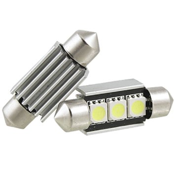

I upgraded most of my interior lights with LED bulbs. It was very easy once I knew what to order and actually cheeper then the old incandescent lights. Heres the info; enjoy...

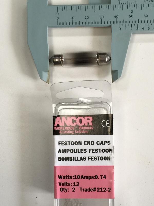

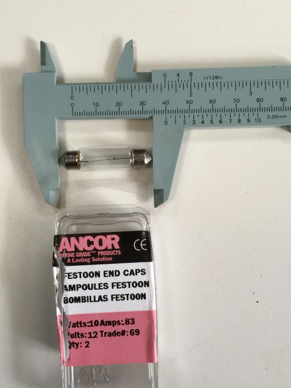

Festoon LED Bulbs: 31MM, 39MM, 42MM
Simply search on google for suppliers of "Festoon LED bulbs". My boat uses the 3 different sizes listed above. I counted all the sizes and ordered in bulk. The lumens rating are different for each supplier so if you need extremely bright bulbs then that should be a focus. All LED bulbs need to be installed directionally so if they don't work after installing, remove and rotate. Make sure you buy the correct voltage i.e.12V, 24v, etc..

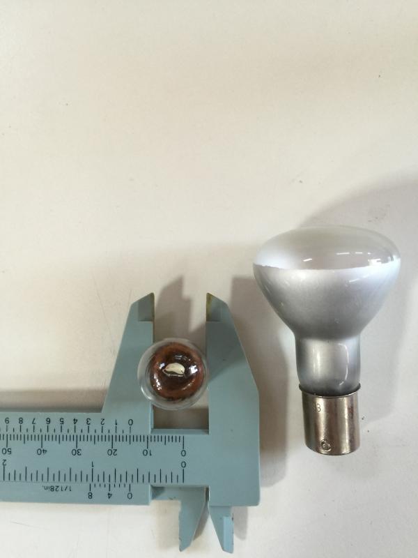

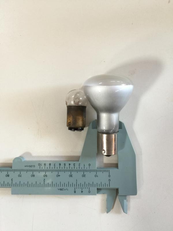

I replaced all my nav lights and mast lights as well. If anyone knows how to describe the bulbs below (belong to reading lights) in the picture I plan on replacing it as well.

I believe the other bulbs are considered LED Single Contact Bayonet Bulbs. Common model numbers include 1156 & 1141.

Sure thing, the new LED bulbs only cost around $1+ each vs the old incandescent bulbs @ WM cost $5. The LED's also last much longer so depending how you look at it the cost is significantly cheeper to upgrade to LED. Hence, I created this post to let people know. You don't need to replace the entire light fixture in order to upgrade to LED, just replace the bulbs.

The "eyeball" fixtures common on my Hunter H34 use 1383 Incandescent Bulbs. The base is called BA15S.
Origanal Bulbs:
Wattage: 20W, 20 Watt Watts
Amperage: 1.5A 1.5 Amps
Voltage: 13V, 13 Volt Volts
Base: BA15s Single Contact Bayonet Base
Glass: R12, R-12, Top Frosted, Bottom Reflectorized Flood
Filament: CC-8/C-6/C-8
Average Life: 300 Hours
Color Temperature: 2900°K
Maximum Overall Length: MOL 2.63"/66.8mm
Maximum Overall Diameter: MOD 1.55"/39.4mm
Alternate Part Number: 40258, 13830, 19W, 19.5W, 27150, 20R12-13V, 27389, 01177A, CEC-1383, CEC1383, HALO 1383, R11-1/2 12 - 16 V 20 CP

Well, BA15S denotes a single contact on the base, and I think a set of symmetrical side-pins, as opposed to an indexed set.
