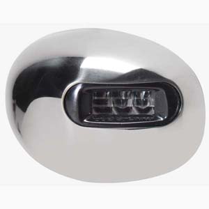

I have some work to do up there anyway. And the OEM is bad and in the way anyway. I've seen a couple boats in the forum that have this type lights, but I don't know anything about them.
The picture of these don't make them look as smooth as they could be. I'm thinking they could have more of a teardrop shape.

Technically, they're side lights, as is the orignal single unit. There's no requirement that they actually be on the bow, and on big and really big boats, they rarely are.
I mention that not to be pendantic, but to highlight that you can put them on the side where it best suits the boat and the ability to hide the wiring, including on the cabin sides if that's the most convenient.
The downside, if you want to call it that, is that they're probably made to be mounted with the vertical mounting surface parallel to the centerline of the boat, not angled toward each other like they would be if you just stuck them on the hull way up front. Tapered wedge shims should be used to keep their sweep angle of 112.5 degrees back from dead ahead (each side) intact if you mount them way up front. If they're not mounted as they're supposed to be, there will be a wedge of dead angle where neither the side light nor the stern light will be visible to other boats, and that's not good. One is supposed to take over where the other leaves off.
The red and green only need 1 mile of visibility, and the masthead (steaming) and stern white lights need 2 miles. The light you posted is good for 20 meter boats, which means it's got 2 mile visibility. You could, if you wanted to, use one with 1 mile visibility, good for up to 12 meter boats, but there's no reason you couldn't use what you posted, as those are only minimums.

The sweep angle is one of the concerns I have with these. Tapered shims don't sound like a very durable solution. Maybe I should keep looking for a better pair.

If they're approved, they have the proper sweep angle of 112.5 deg., but you just want to be careful about the backs being parallel to the centerline of the boat. A piece of Starboard or other suitable material would be shaped to make a permanent wedge, if needed, or mount them further back on the cabin sides where it's relatively parallel and vertical.

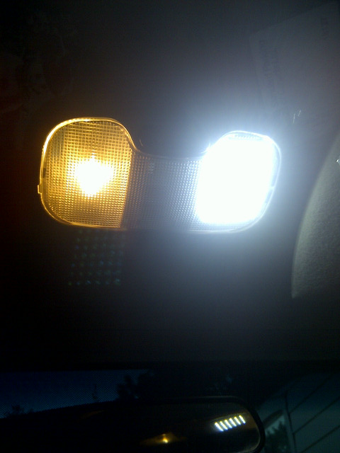

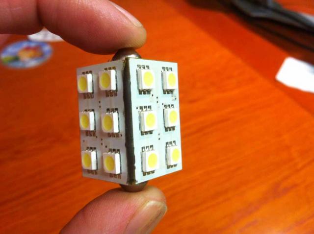

I'm not sure what the lights look like on the 25. But the light on my 26D just takes an automotive interior bulb. The long one. http://www.ebay.com/itm/Festoon-37m...ssories_Gear&hash=item19d40fc36d&vxp=mtrlink;
My bow lights are mounted on the bow pulpit. Not the hull. (see pics)
There is a pic of my truck interior light too. Just for comparison. guess what side the LED s on...

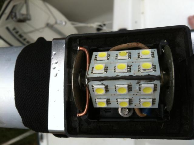

To add another option, these work very well on our 26S. 12 watts total and bright beyond belief. Meets angle requirements (in conjunction with fixture).
Details here: http://bbs.trailersailor.com/forums/macgregor/index.cgi?read=48414,led,nav
Chris
Those look quite neat.....I followed the thread through and noiticed a discussion about current regulation....Again obviously with my electrical questions my electrical knowledge is very limited. Did you modify the leds in some way to reduce the current. Is there a regulator you added to the wiring. Can I just copy ( my favorite thing to do, but does nothing for my understanding) what you did and plunk them into the exsisting light fixture without modification....what will happen. My biggest fear is turning my family into roasted weiners....hence all my questions about fuses and wire sizes. A little bit of knowledge can be very dangerous.
