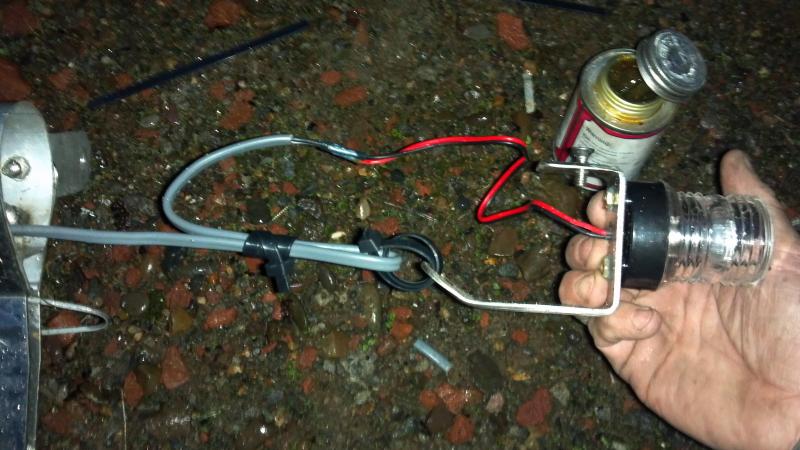

this is what i installed on my 25.... it is a very bright single led designed for the masthead. its built with a reflector to turn the light out, but its so bright that it very clearly lights the windex....
previously installed was a sun baked fixture with an incandescent bulb in it that was mounted on a bracket similar to the windex bracket that left the top of the masthead open.
and there was no strain relief on the wire... it hung from the fixture to the deck. im surprised it was still attached and working after all these years.
when I pulled the wire to install the silencers on the wire, there was a dead bird in there. (it must have been hung up on the spreader bolt)
so to prevent that from ever happening again I built a different mount for the light to enclose the masthead, and with a better strain relief for the wire.
I installed twin wire with a sheath for better tensile strength, not that it was so necessary, but only because I had the wire and i could...
