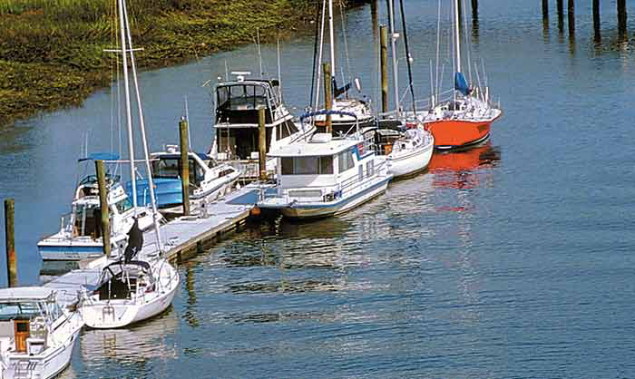

I am looking forward to the replies to this post. I park port side parallel to the dock facing downstream and downwind with the prevailing wind. I have no boat ahead of me and a houseboat behind. I have about three boat widths to turn the boat around and two rows of docks that I can back into or out of. I am looking for suggestions to bring the bow upwind and up current or would turning the boat around and backing into my slip be a better option. This is a new marina for us and a new set of challenges. We are less than a year into our sailboating. Thanks for any suggestions. We are on YouTube under Zip Tie Sailing and there is a short that shows our docking situation. Any suggestions will be greatly appreciated.

The starting image could almost be your boat situation.
