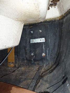

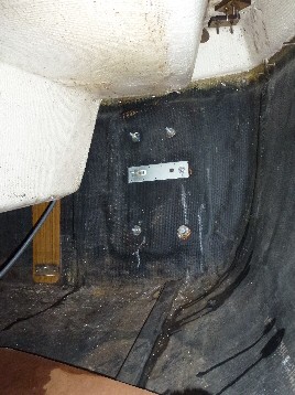

I went from a 10 hp 2 cycle to a 9.9 4 cycle. Didn't feel comfortable with the original motor mount so up-sized the mount and reinforced the transom from inside the boat. Also had to move the balance forward to keep proper tongue weight for safe towing. no regrets. Composite fiber board shouldn't rot and provides load distribution for this application.
Feb 13, 2016
551
macgreggor venture 224 ohio river
Tongue weight I didn't even think about, when I hauled it home a few months back it towed great but everything heavy was in my truck. What xtra support did you add to help, mine has a fiberglassed in piece of plywood that's a little larger than the motor mount

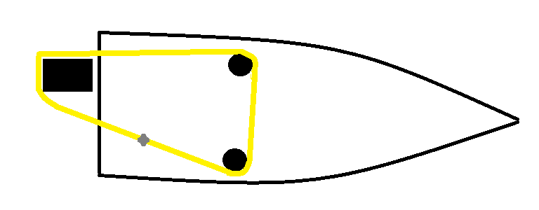

If you can take the weight off of the transome as you bounce down the road you would save a lot of time at the launch site by leaving it on but if not you will likely damage your transome
I had good luck running a ratchet strap around both winches and then to the outboard
Ratchet that tight and the weight is transferred to the winches
