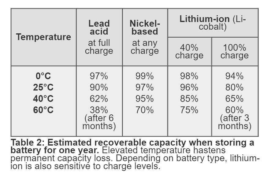

I clipped this chart from BatteryUniversity.com web site. It goes along with what Maine Sail said about not storing Li-ion batteries at 100% charge. Temperature is also a big factor. Us Florida boaters might consider storing the battery in the frig rather than leaving in a hot boat over the summer.
