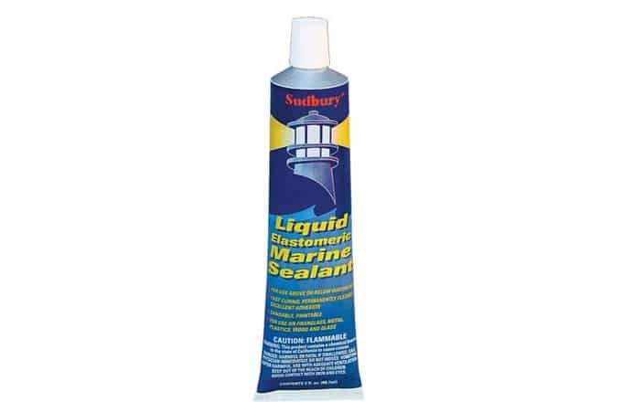

If, however, you want to try applying a sealant in just the leaking locations, I would recommend Sudbury Liquid Sealant shown below. It has the consistency of water and it will seep into very small cracks. Sudbury also makes a thick elastomeric sealant which is excellent - I use it to coat the ends of cotter pins to protect against rips in my skin. It will remove easily and clean by grabbing an edge of the sealant with pliers and pulling.
Note that these are sealants, and not adhesives.
Good luck finding the entry point of the water. Leaks can easily enter in one spot and exit in a different spot much further away from the entrance.
