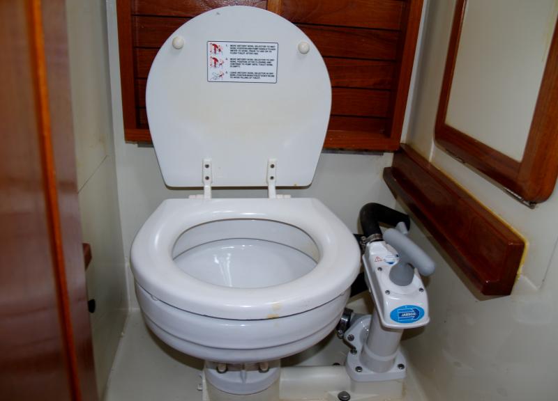

Can you post pictures? I ask mostly because I have the same boat and want to see how your plumbing is routed...
Brian, I'll see about this. I'm not real tech savvy but my 14 year old daughter is. I'm going out Saturday/Sunday and will make every effort to remember my camera.

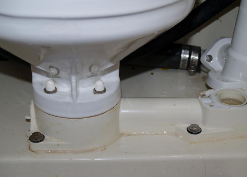

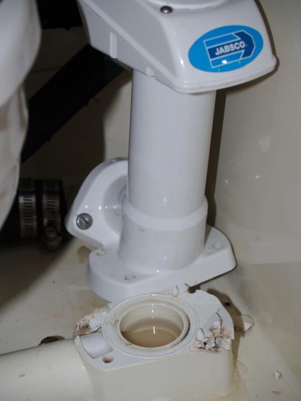

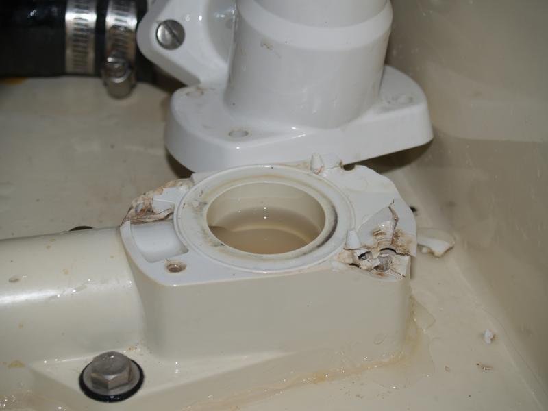

Here's what I found...the base plate where the screw holes were had simply demolished over time. When pricing out Jabsco parts it was less expensive to install an entire compact toilet unit than by individual parts. I ordered one on Amazon and the total came to $180 including shipping.
Now if I can do the installation without crossing hoses or damaging seals it ought to work fine.

The pics show the existing damaged parts. Will post pics of the new unit soon.
Benny had it right. Caulking simply held water in. You gotta get to the source.

The parts schematic for that unit (I have two on Dreamboat) shows a gasket on the center circle of that chewed up base. Did you find one there?
Mar 26, 2012
108
Macgregor 26M Cave Run Lake (KY)
Yes. it was there. I tried to put things back for a temporary fix but the there were no threads left to hold.

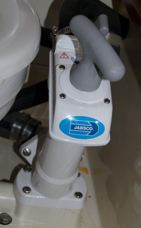

I installed the complete unit today. It took a couple of hours but went in pretty easily. Afterwards the bowl filled and emptied so I'm pretty certain I got the hoses on correctly!
The instructions stipulate not to over-tighten connections and screws to avoid cracking any of the base or pump plastics.
The price came in way under the cost of doing things part by part and I was able to find a good deal on E-bay.
