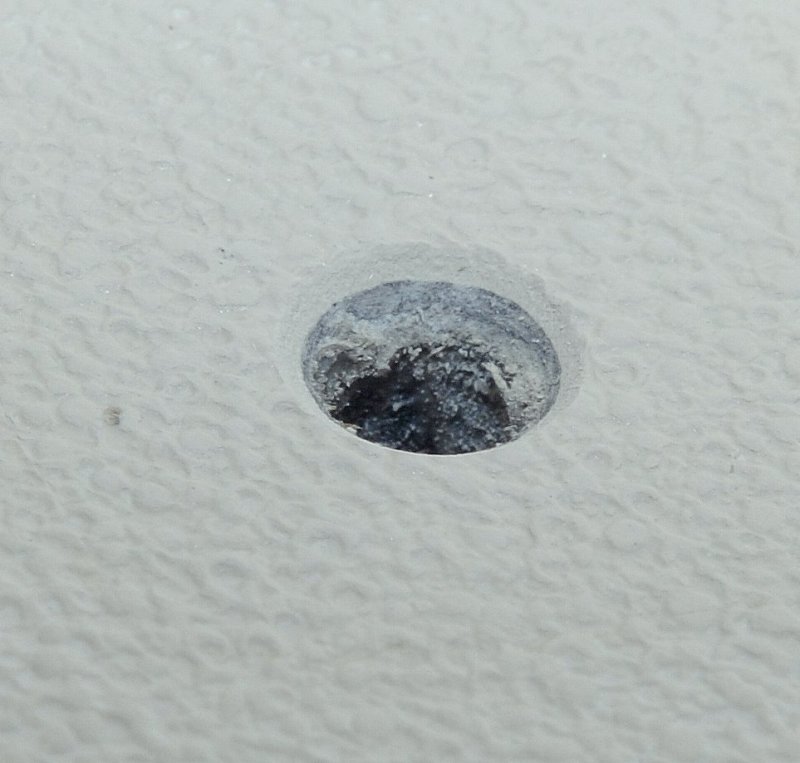

Not sure which of the butyl sources you are using but have found these past 4 years that Mainsail’s product has held up, no leaks. It also helps if you prep your holes to provide pocket for your butyl to fill. Counter sink the holes.
