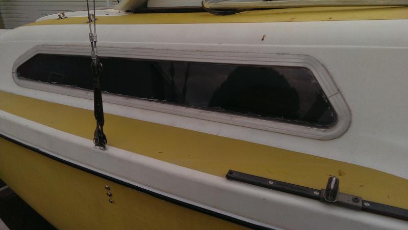

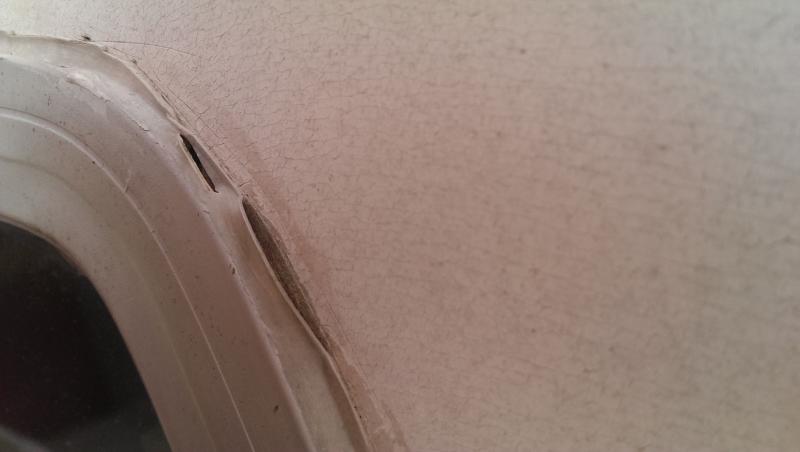

so this is a closer picture of the frames. I would have thought this would be a common repair. I have done a lot of searching but have yet to find any info on this particular frame. I guess it cant be that different from most frames but was hoping to find that cut and dry youtube walk through video you know? most of what I have found has been Catalina repair. I think these work a little different.
Also What is a better replacement , Lexan or Plexiglas?

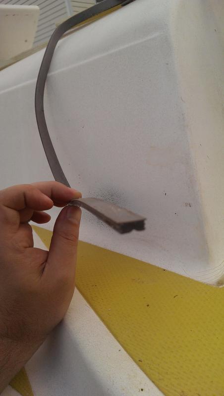

One more thing Im confused about is the trim pictured in the last shot. Its about 3" to short on all the frames? Is that supposed to be that way?

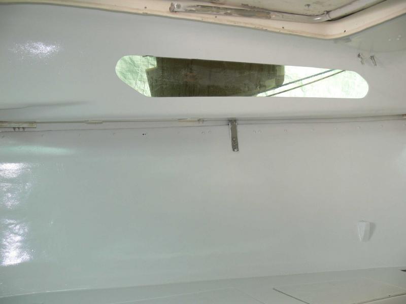

Honestly I have forgotten how the gaskets were in there - I still have them somewhere in the bone pile. They pretty much look like yours.
Sadly sometimes I fail to take photos during the refit of some item much to my later dismay. Attached are a couple of photos showing result.

Well, The refit certainly seems like less work, less problematic, less costly and more ascetically pleasing... I cant think of one reason not to go that route.
Do you remember what thickness you used?
Also, would you still go with the 795? I would think the butyl tape would be easier but to be honest I have never used it. I'm trying to understand how to apply the 795 with out leaving an ugly gap or a mess of caulk oozing out.
