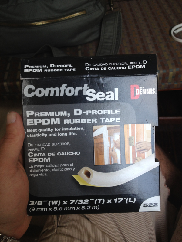

Depending on the year and model of your boat, the front hatch may be made by 'gray industries', which now goes by 'pompanette'. A contact there who has helped me is Tracy West, tracy.west@pompanette.com. They have a website too.
If you need a new rubber seal (gasket) I used the 3/8" EPDM 'D' profile weather stripping (name: Comfort Seal, by DRCR Dennis) with adhesive back from Menards for both the front hatch and port windows. For front hatch, do not split the 2 portions apart for the windows you will need to. Both seem to work well and were about $10 total as compared to Gray's quote for $5.25/ft or $150+ total.
