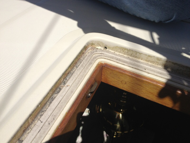

Beynt, I don't have your boat but have fought this battle recently. Do the hatches have aluminum frames or are they a thick plexiglass with hinges? (Mine are the latter and a pain! If the former you need to derermine of the leak is from around the frame or closing pieces. Most aluminum hatch manufacturers have seals you can replace like Lewmar etc.
Just rember butyl is appropriate where fasterers are used and could harm some plastics. Also above the waterline. My deck hardware Udall being bedded this way.
To determine the leak I use a little water with some light food coloring. I have a crappy towel to catch drips.

I ended up going to McMaster Carr to find a similar material. If you have a photo it would help. Mine have two seals like you see in the attached photo. This isn't my boat but you get the idea.
