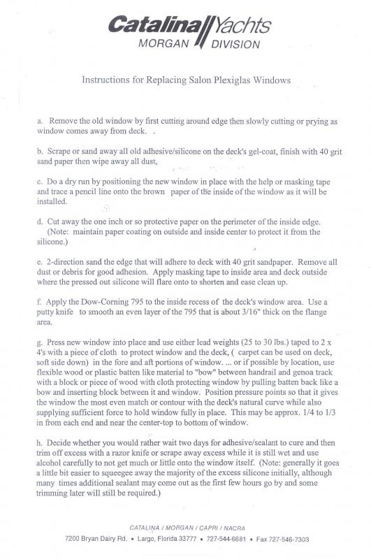

Just priced the parts this fall as it is on my winter layup list for service to be done in the spring. Windows are available per Warren, they are $82.00 each and the galley and head window can be delivered with or without the cut out for the port.
Attached is the instruction sheet they provide.
Hope it helps
Russ
