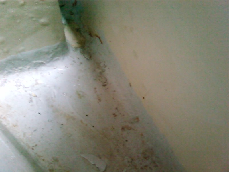

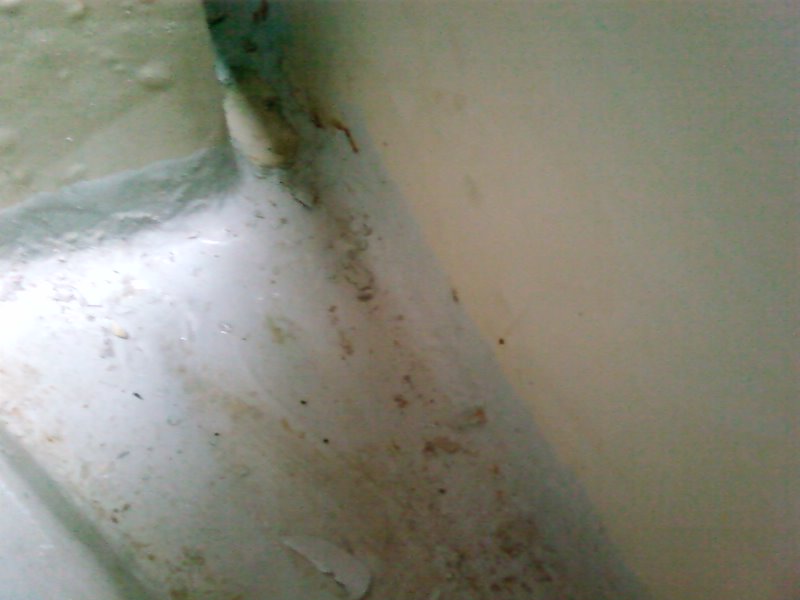

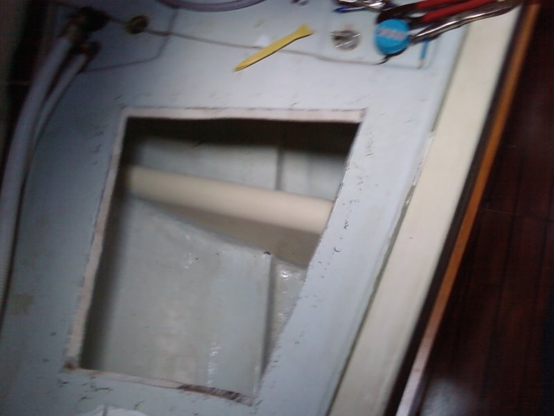

My buddy's 42 Beany Toe center cockpit had water leaks in the forward tank, but not through the top. We had to open it by cutting an access hole in the top .. Found sealant leaks in the sides of the tank where the liner was sealed to the hull to make the tank .. Looked to me like normal hull "working" in a seaway had opened the bottom corner seam.. Got some food grade sealant and gooped the thing up as best we could.. No problem in ten years so far.
I found it strange too that the tank was using the liner and hull for containment, but I know some manufacturers did that (Hunter 40 and 31 of the '80s) In the picture, you can see the top off and the baffle and the inner surface of the hull. No problems with the cover leaking. You can see the white color of the core but I don't remember exactly what it was.
