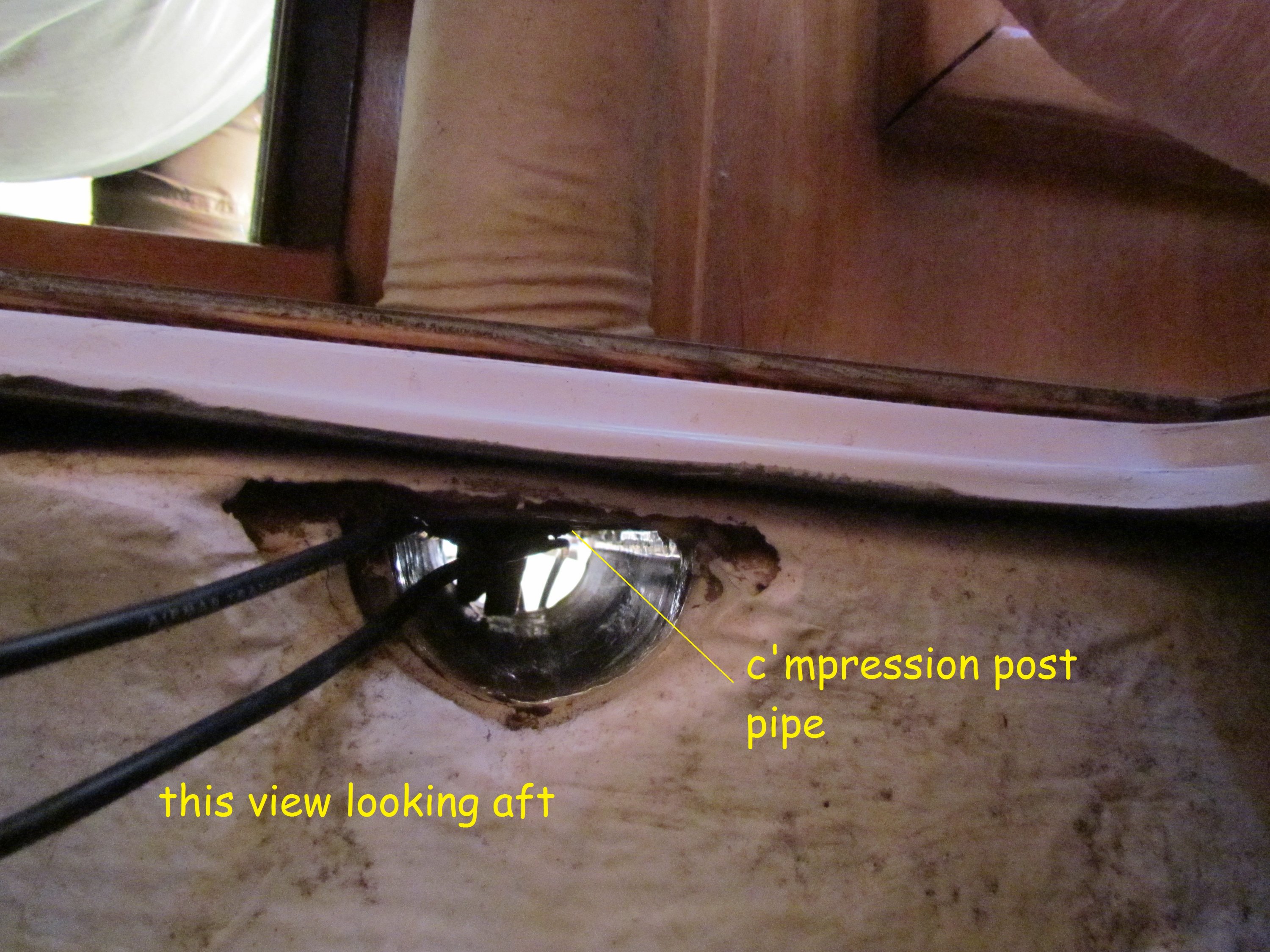

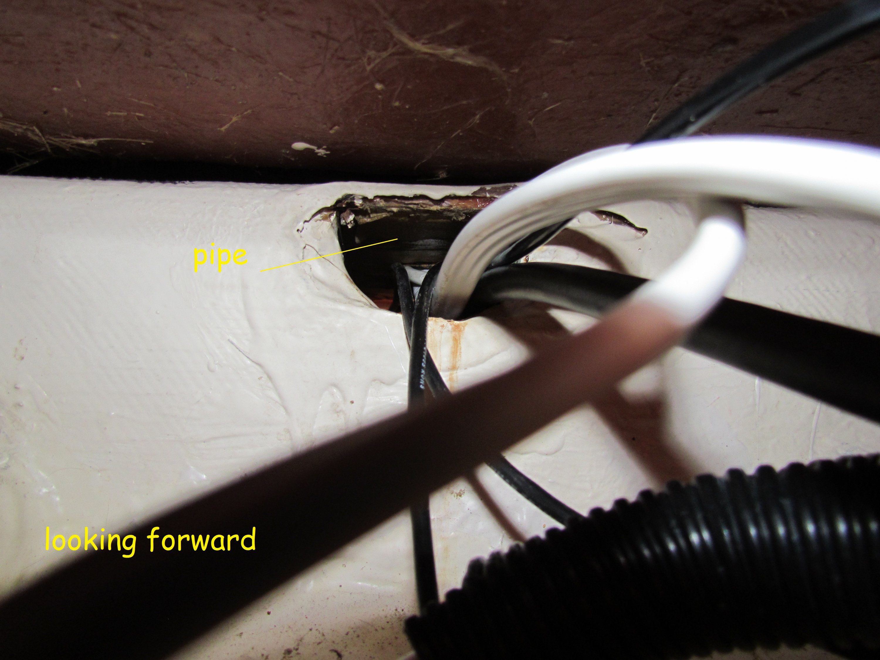

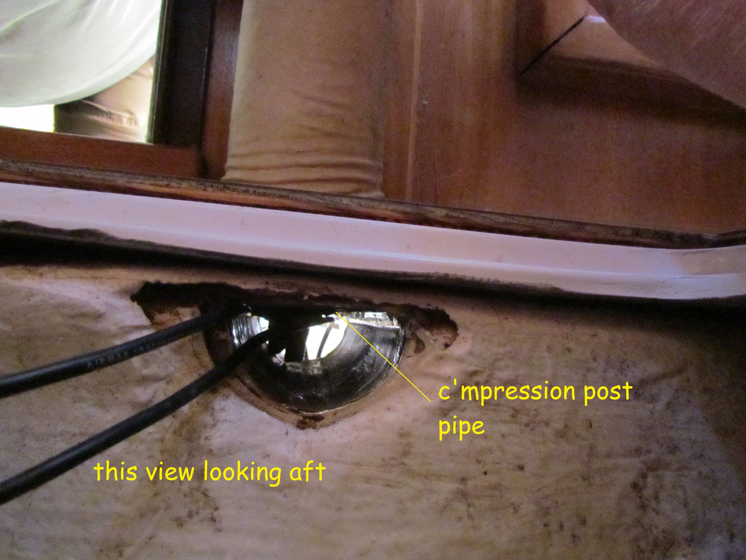

24,593
CL I have looked at the manual. It did not show if your Mast is set as a deck step or through the deck and stepped on the keel. Weep holes are drilled in the side of the mast when it is deck stepped. Water will enter the mast. It travels down the wires, sides of the mast, or the halyards and the conduits. The weep holes provide a path of escape for the water to exit the mast and onto the deck. Assure that the wires in the mast have a drip loop when it is stepped.
If Keel stepped water does find the bilge.
paulj
Mar 16, 2007
1,361
Catalina 310 Anacortes,Wa
If you put a drip loop in the wires or cables coming from the mast ....well you will have to remove mast to repair or change any wires and cables in the mast.......you can't pull a cable that is in a drip loop........where do you think the water from the drip loop goes?
The reason for a bilge is for water to drain to..........
Here is a picture or two of where the post or pipe ends and goes to bilge.
paulj :hook2:

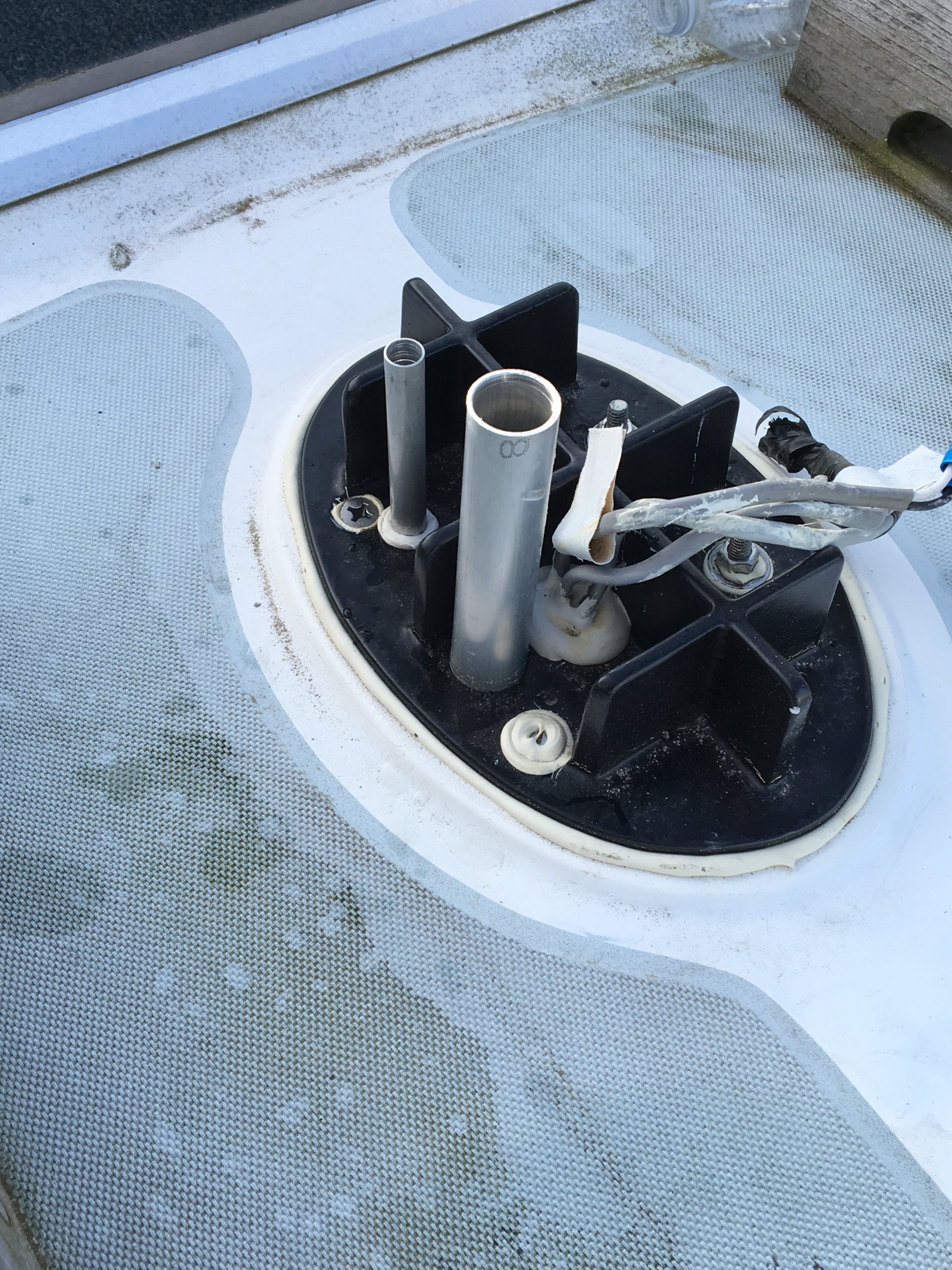

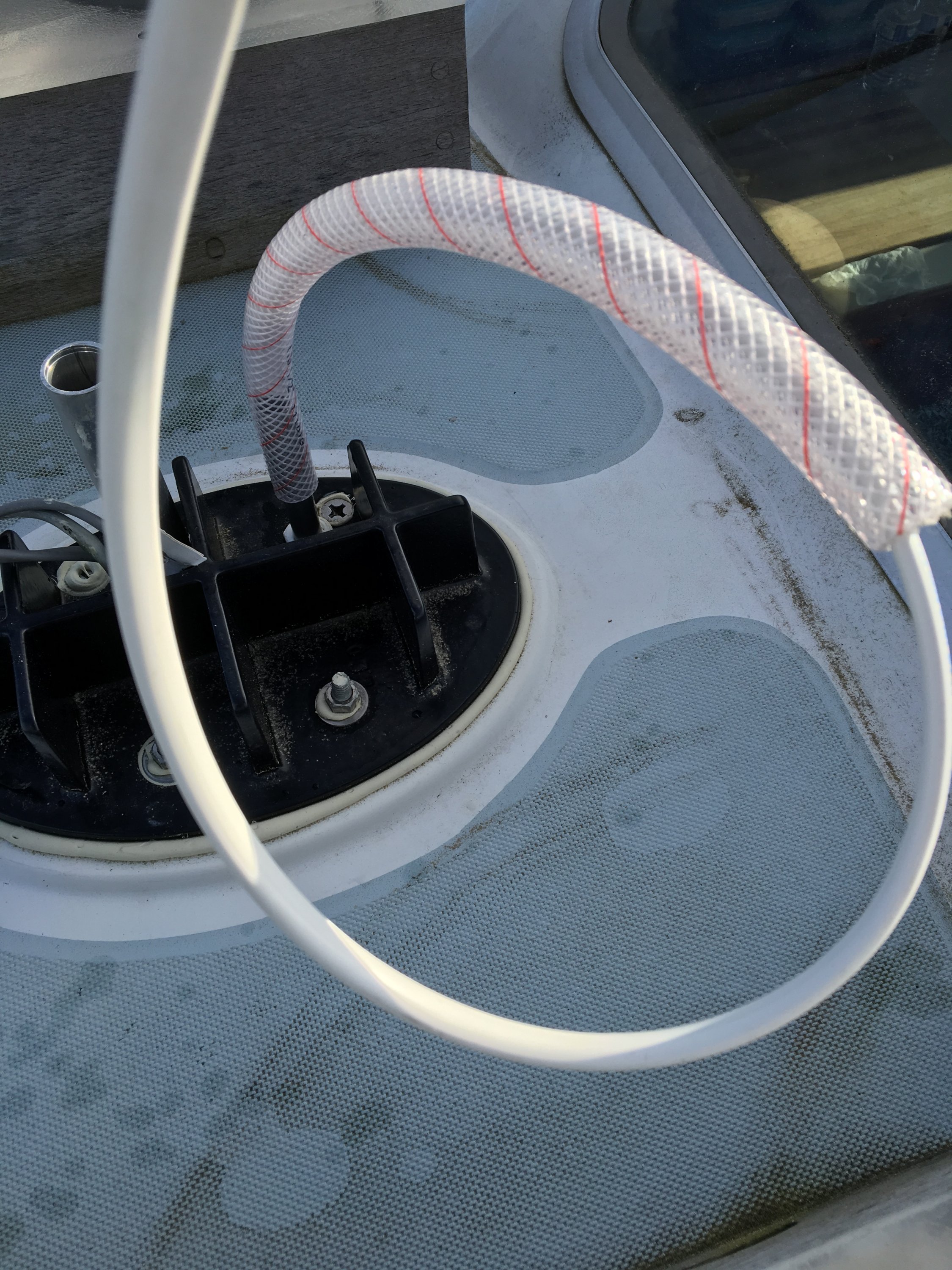

24,593
I have a deck stepped mast. When removed for refitting I cleaned the deck, resurfaced the base, fitted the two pipes and short lengths of hoses to create the drip loops in the mast and limit the possibilities for water to come down the mast base. Then weep holes on the bottom of the mast so the water escapes the mast and drains away.
