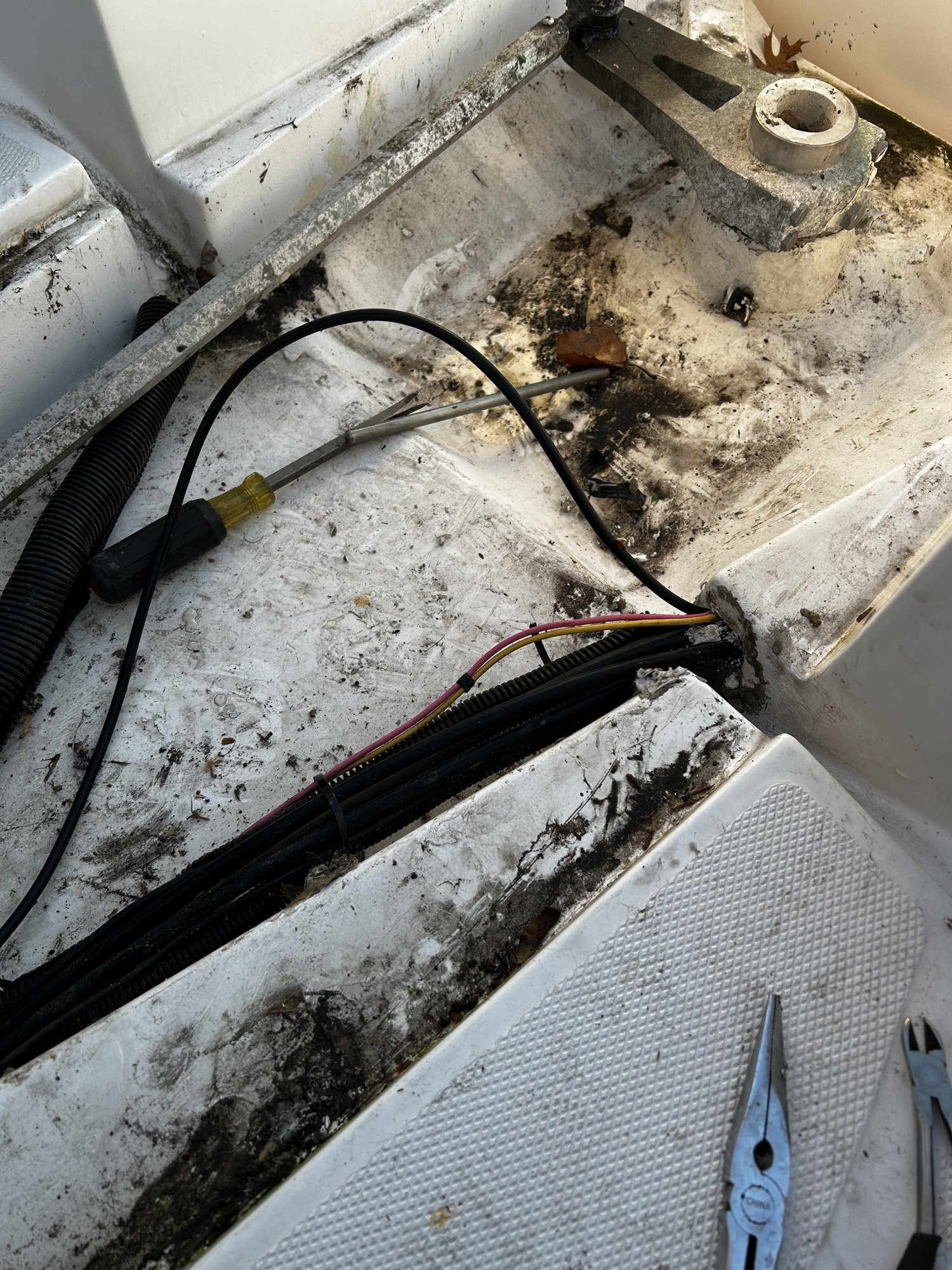

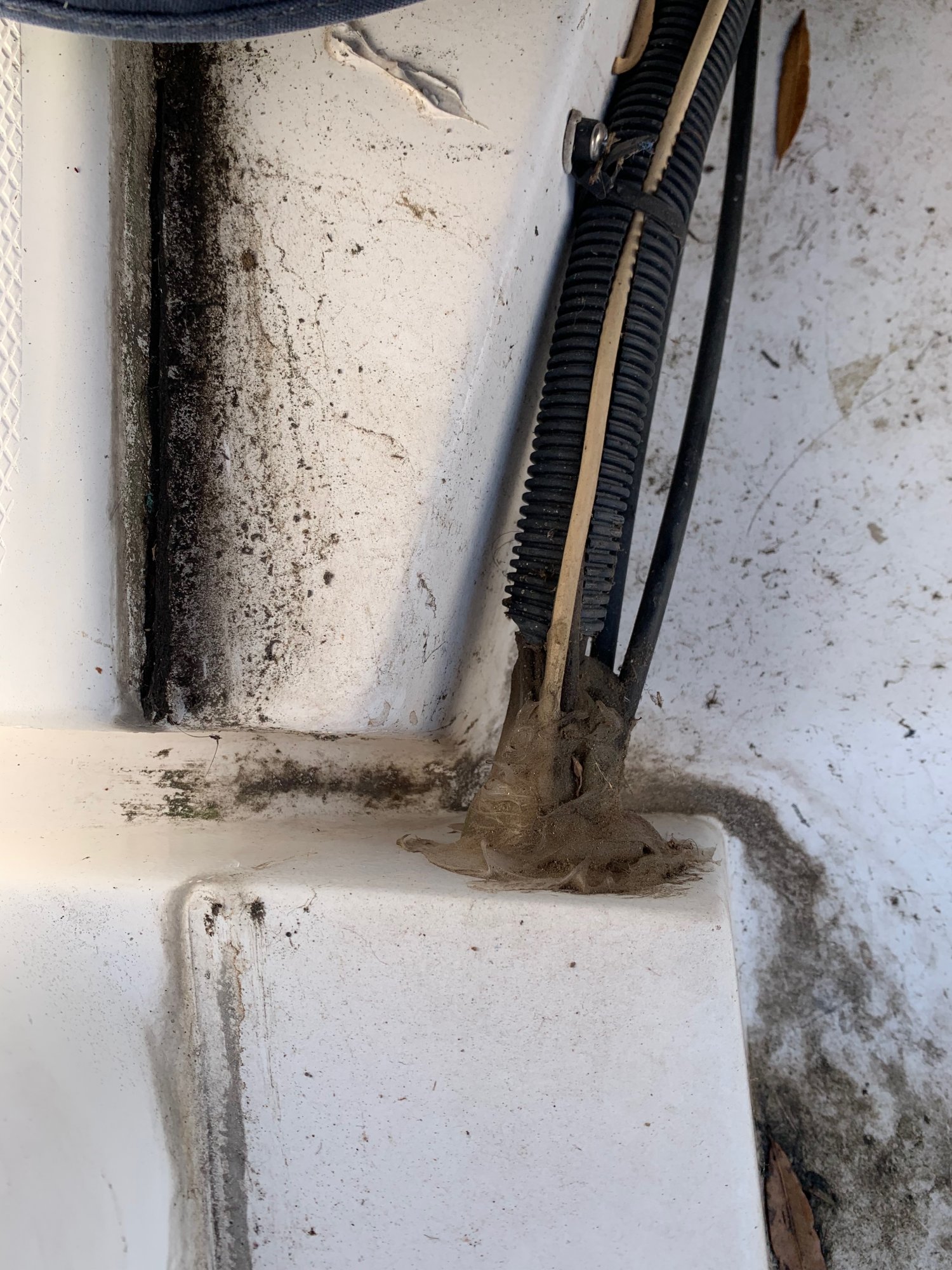

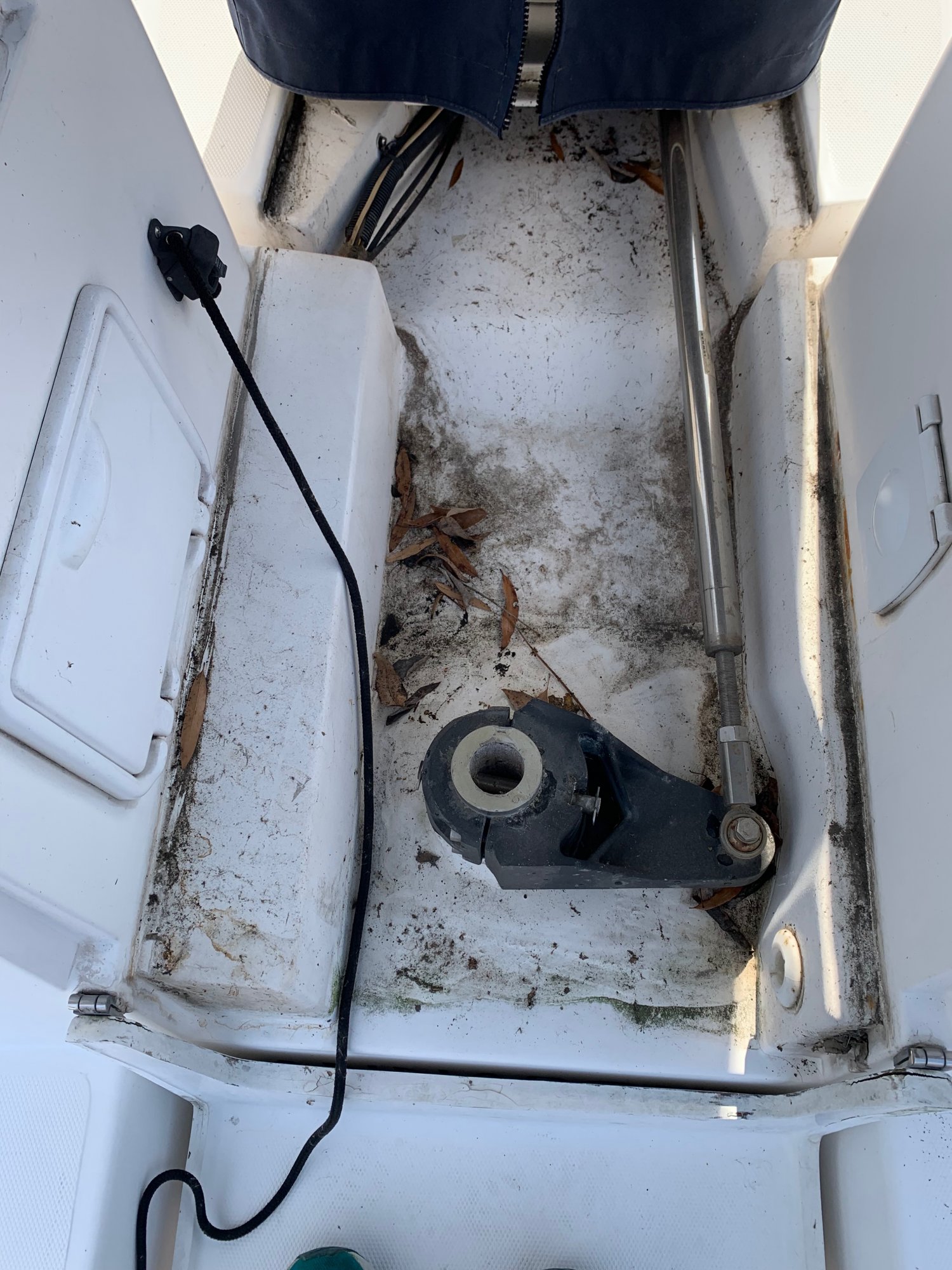

So here's the area where #4 (the wiring bundle) comes out under the removable floor in the cockpit, looking forward towards the steering pedestal:
Yeah: I know it's dirty. I cleaned it up, but I should have waited to take the pictures. The wiring bundle (helm instruments and engine throttle controls) can be seen exiting through the deck in the upper LHS and heading forward to run up the steering pedestal. Here's a close-up:
You can see where the dealer gooped it up with silicone years ago to try to prevent a leak into the aft cabin. It's a little hard to make out, but there is a major rain gutter just to the left of the exit point. This gutter catches all the water from the port side cockpit seats, and directs it in a firehose (if it's a big rainstorm) right at the place where the wires exit the cockpit floor. Not one of Hunter's better design ideas. This, together with the fact that I get rain water in the blind bilge in a really hit-or-miss way, makes me suspect #4 as the major source of leaks. There are many times when we get a decent rain and there's no water in the bilge. It only happens maybe 1 time out of 3, so maybe it's only when a really torrential flood hits that this gutter becomes a raging river and causes a leak? Hard to diagnose an intermittent problem. I've considered maybe cutting a short bit of PVC pipe to wrap around the wire bundle and either gooping it in place with some silicone or 4200.

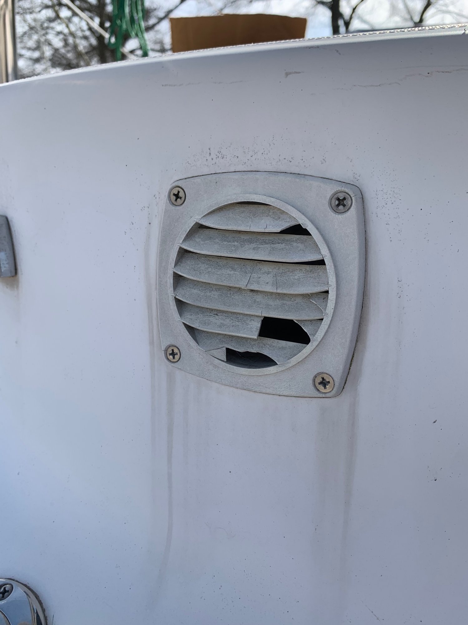

Another suspect: #5, the bilge blower vent. Look what just happened this year:
This guy connects to the engine area right over the stuffing box via some 3" dryer hose. Clearly, the vent needs to be replaced. I just found and ordered a Sea-Dog vent (in stainless steel) to replace it.

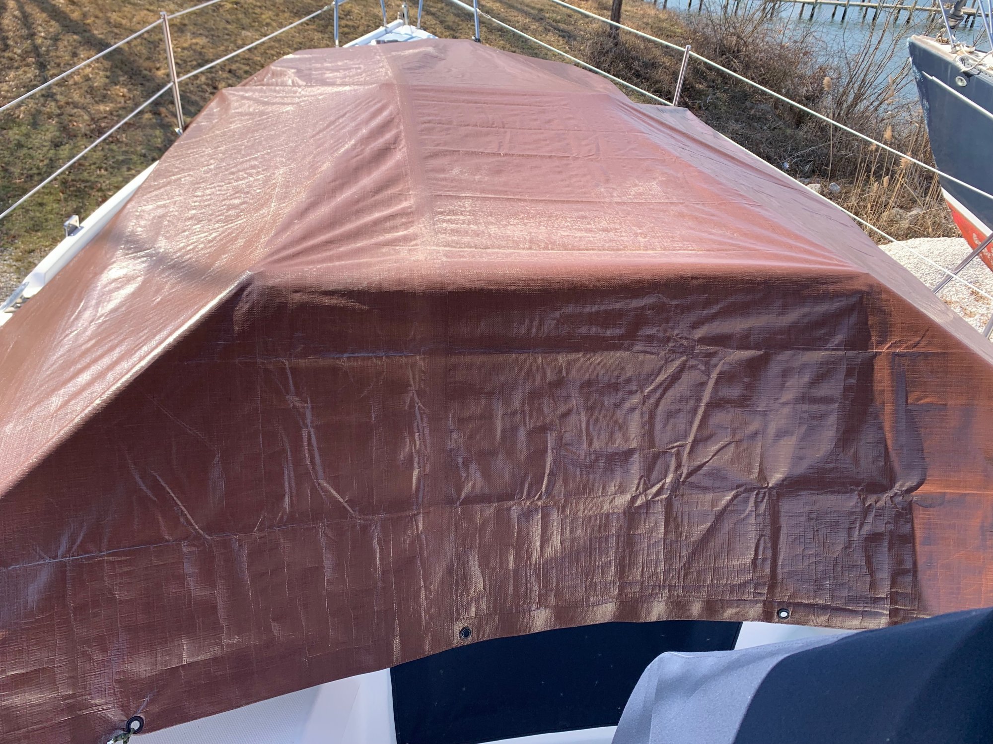

Meanwhile, I've taped plastic over the vent, the shower box, the engine panel, and the GPS puck, and will await the major rain we're supposed to have on Monday to see what happens...

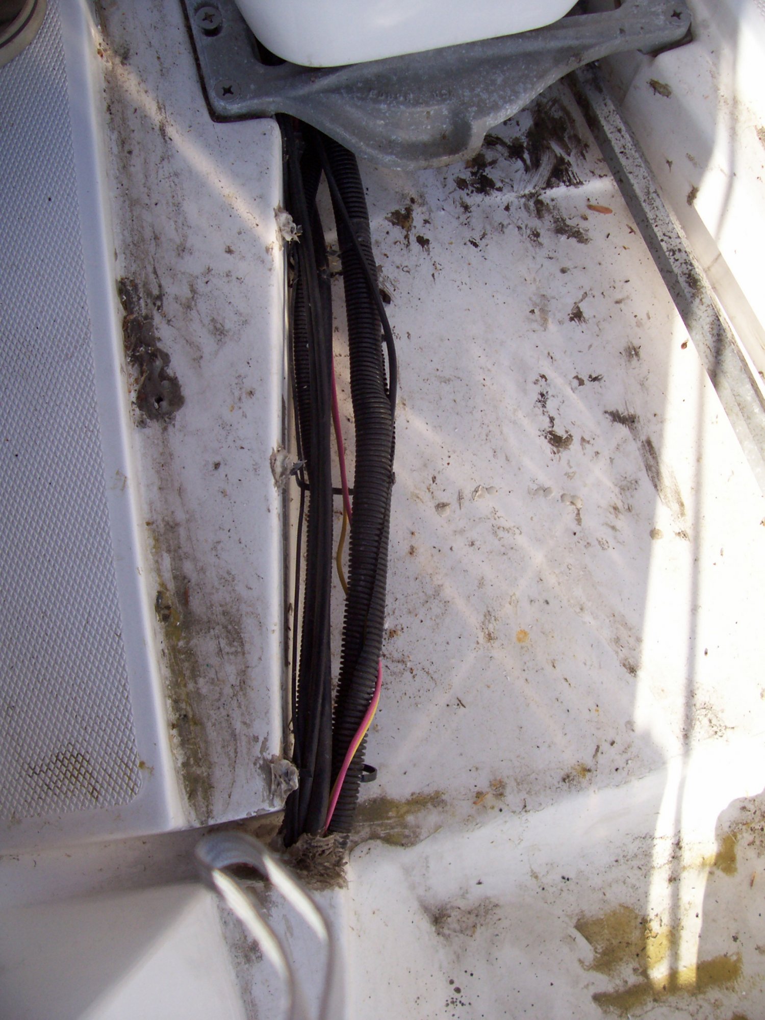

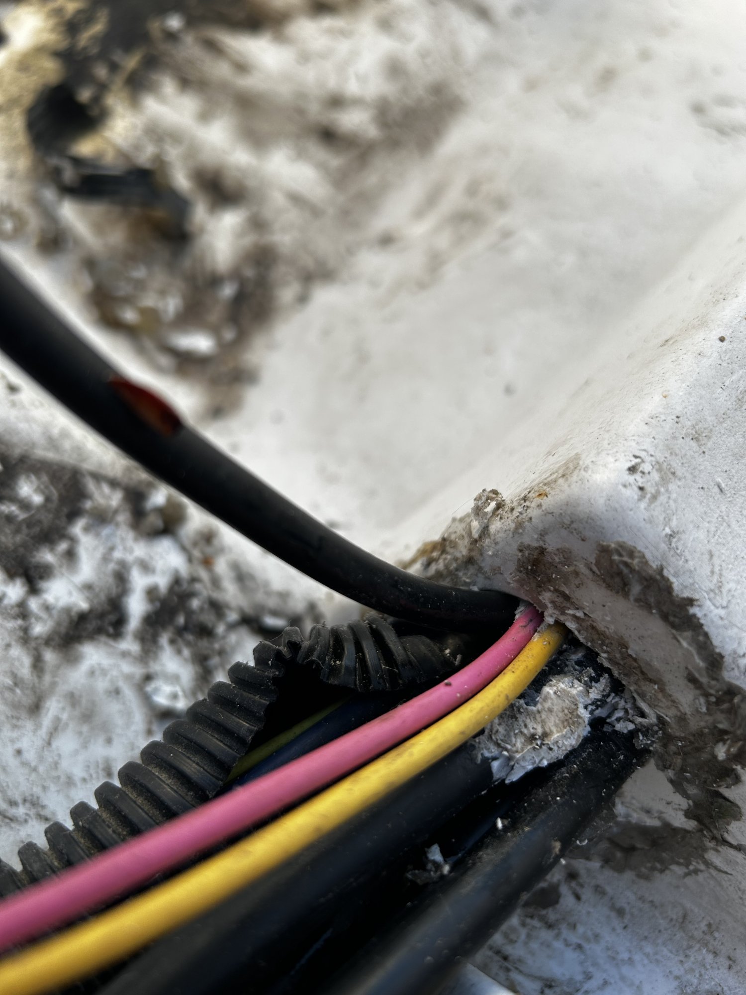

On my 2000 340….when I was routing new VHF coaxial cables and remote Mic cables i was in that same area you are questioning. By the way, don’t be too concerned about the dirty pictures, mine are worse (but, by default, clean now).
The “goop” is just a silicone Hunter used to seal the cable entry. It turned brown through the years.
In my photos you can see it is fairly easy to pull the sealant out and reseal with better sealants today.
That could be a possible source of water entry, as water from the cockpit seat drains directly over and around it. If the bottom section of the seal has opened up a lot of water will find its way in there.

What I had was 2 1/4 inch screws the Hunter used to screw the deck down. When all that was needed was 1 inch. Overkill for sure. The extra length pierced through the bottom and into the aft cabin.
I filled the 2 holes with 2 part epoxy, drilled new holes to a proper depth. Hope for you its as easy as filling the 2 holes as I did. In the last photo…on the left you can see the hole for the screw to hold the deck in place. There is another directly opposite on the right. Big Holes.

@jaysweet - The configuration that you describe is very much like our 1997 h40.5. I have had a leak around the wire bundle under the helm platform. It is a difficult area to seal where the wires pass through from the pedestal to the interior wiring.
The issue is that for a complete seal you must work the sealant between the wires to eliminate a water path. It becomes worse when there is the corrugated wire loom involved.

Rich is 100% right. I cleaned my area out completely, rerouted my cable for the remote VHF through, dammed up one side and filled the whole with Sudbury. Actually forgot what I used until Rich mentioned it.
