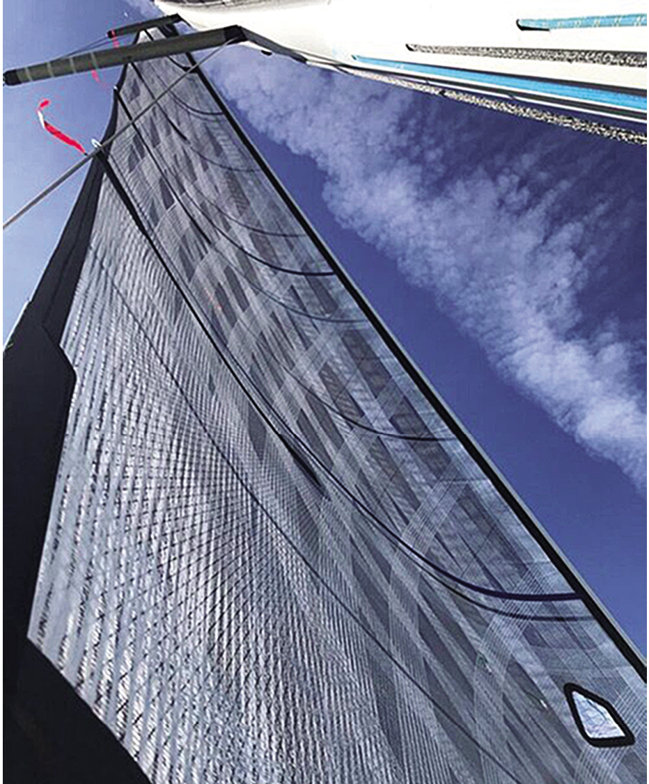

From Quantum
"Telltales can be used on the leech to indicate flow on a non-overlapping jib. As usual, it is the top telltale that counts. Usually there is only a single telltale in the upper 25% of the leech. Trim too hard or pull the lead too far down (or too far forward) for conditions and that telltale will stall. Twist is essential in a non-overlapping sail so you always want the telltale flying.
Additional telltales are also used sometimes in the upper sections of the mainsail across the middle of the sail. They help refine the twist picture and give a more subtle indication of how hard you are trimming the mainsail. They may indicate stalled flow before the leech telltale disappears. Again, they are in the top sections of the sail because that is where the sail will stall first if over trimmed. If they are too close to the mast the disturbed flow behind the spar will make them useless."
