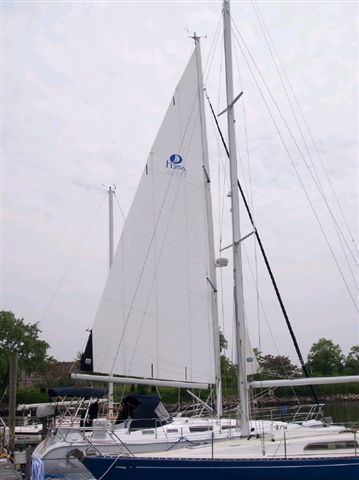

Ok, the college education was worth it. Just had my son change the format of the picture of the new main. Hard to see, but if you look carefully you can see the bottom and top of the boom lift. The old UK sail was cut to fit inside the boom lift line and note the three verticle battens. Remember I still have the issue with the battens hanging up upon unfurling or furling. I have not heard back from Doyle yet. Also, this larger sail fills the cavity of the mast, not much room for error. I'll keep you posted on Doyle's response to the problem with furling. Bob Keller

Hello Chuck, I will question my Doyle rep regarding the swing batten again, just out of curiosity at this point. My rep did call me yesterday afternoon. Doyle is very willing to move forward with coming up with a solution to my problem as they want to sell these sails to Hunter going forward. I actually took a series of pictures which been forwarded to the designers at Doyle. We'll see what happens. I am anxious to sail with this new sail as it just "feels" as though it will far out perform the UK (and hopefully solve the flutter issue). Hopefully this weekend will be good. The plan is to sail on Saturday spending the night in Oyster Bay. If anyone happens to see us take a picture please and of course stop by and say hello. We will probably be on the hook by late Saturday afternoon just east of the Oyster Bay mooring field. We'll sail back to Stamford probably on Sunday afternoon. Regarding the difference between the swing batten and the zenith, I also thought the sail would have more roach as well, but as this sail fills the cavity of the mast I don't know if anymore sail would fit, obviously it does in your mast. Regards to all. See you on the sound and the Vineyard and Tucket in July. Bob
